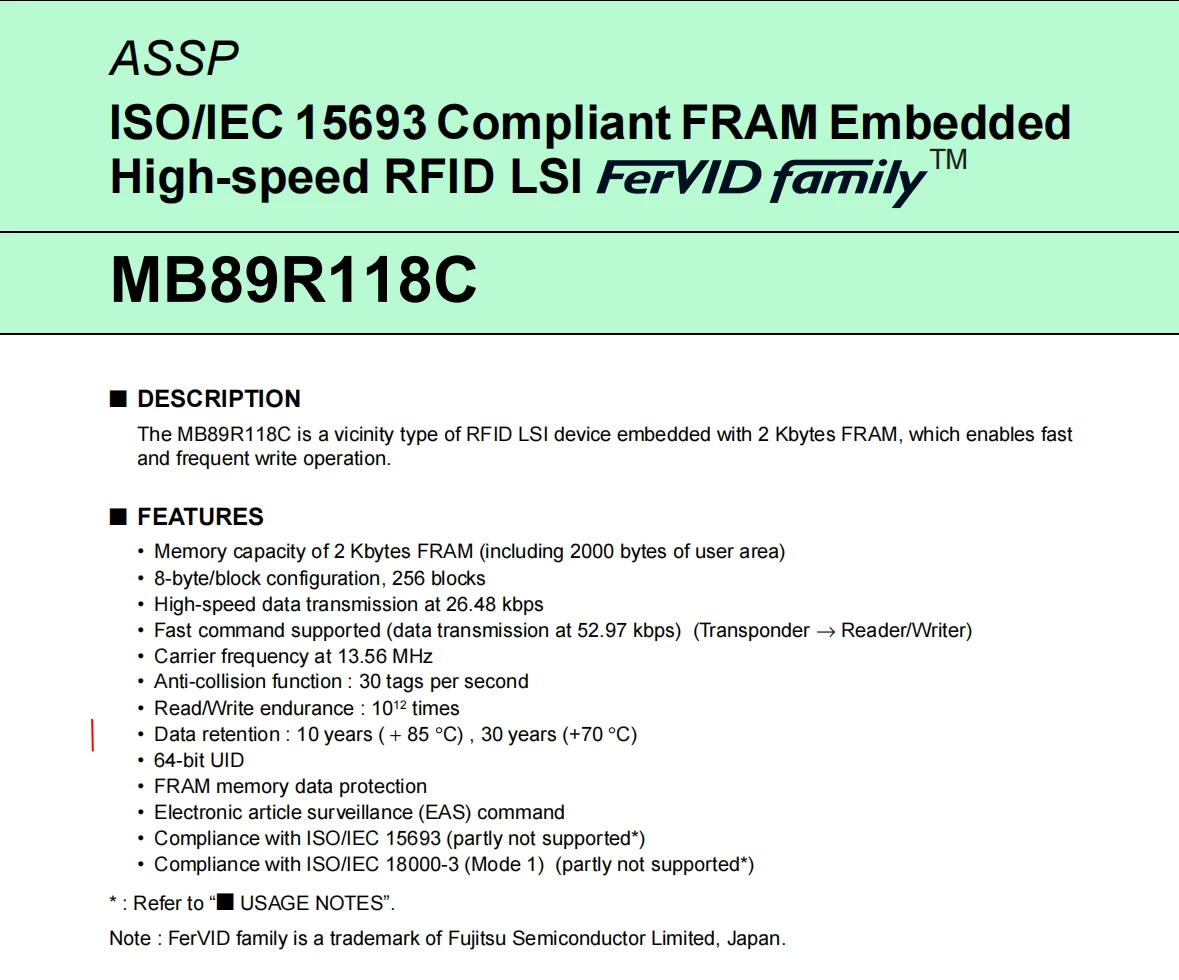

ST25R3916 I want to improve the speed of reading block. How can I debug it?
Hello,I have a question need your help!
About :MCU L431(80MHz),SPI 5M,IC ST25R3916. NFC06A1
I use "rfalNfcvPollerReadMultipleBlocks()" read two blocks at a time,but I found that it takes 9 ms to read successfully. How can I shorten this time?

see https://community.st.com/t5/st25-nfc-rfid-tags-and-readers/decrease-the-time-to-write-read-a-block-fro-a-nfc-tag/td-p/601357 for a similar question.
When using the Read Multiple Blocks command in non-addressed mode to read 2 blocks of 8 bytes, the request contains 6 bytes and the response contains19 bytes. When using 26 kbps bit rate:
6 bytes transmission 1.92ms
t1 0.320ms
19 bytes reception 6.04ms
t2 to next command 0.309ms
Total duration is 8.59ms for a Read Multiple Blocks command/ response with 2 blocks of 8 bytes. This is inline with your 9ms measurement.
As 100 bytes is not a multiple of 16 bytes, I assume 7 command/response pairs are needed, so the duration for reading 112 bytes is ~63ms. What is your starting point for your 80ms measurement?
If using the Fast Read Multiple Blocks, the request contains 7 bytes and the response contains19 bytes.
7 bytes transmission 2.22ms
t1 0.320ms
19 bytes reception 3.02ms
Total duration is 5.87 to read 2 blocks of 8 bytes with fast mode, so about 35.2ms for 96 bytes
If using the Read Multiple Blocks Unlimited proprietary command to read for example 6 blocks:
7 bytes transmission 1.92ms
t1 0.320ms
51 bytes reception 15.7ms
Total duration is 18.6ms to read 6 blocks of 8 bytes, so about 37,2 ms for 96 bytes
I would personally use this Read Multiple Blocks Unlimited proprietary command and read 4 or 6 blocks per requests.

hanziggAuthor
December 19, 2024
Compared with what you said, it takes me 9.1ms to use Read Multiple Blocks command and 7.3ms to use Fast Read Multiple Blocks command, both of which are slower than the theory.
But,The tag on the customer site may not support Fast Read, so I still have to use Read Multiple Blocks command.
Is this the fastest speed that can be achieved by using Read Multiple Blocks command? Is there any other way to improve it?I will provide you with what you need.
Finally, regarding the read multiple blocks unlimited proprietary command you mentioned, I didn't find this command in the demo. Where can I get this command demo?

Brian TIDAL
December 19, 2024
"Compared with what you said, it takes me 9.1ms to use Read Multiple Blocks command and 7.3ms to use Fast Read Multiple Blocks command, both of which are slower than the theory." the theoretical values are related to air transmission only.  MCU / device communications over SPI (registers configurations, FIFO write and read)  add some extra duration. So, your measurement are inline with the theoretical values + MCU / device communications duration.
"The tag on the customer site may not support Fast Read, so I still have to use Read Multiple Blocks command": please note that Read Multiple Blocks is an optional command from ISO15693 point of view so if your customer uses another tag, it may not support the Read Multiple Blocks command. It may also support another block size (e.g. 4 instead of 8 on MB89R118C) and may support a different maximum number of blocks for the Read Multiple Blocks command (when supported).
"Is this the fastest speed that can be achieved by using Read Multiple Blocks command?" Duration of the transmission on the air is defined by the standard.
"Is there any other way to improve it?"
  • read a greater number of blocks during read multiple blocks (e.g. use read multiple blocks unlimited command as the read multiple blocks on this tag is limited to 2)
  • use Fast Read Multiple blocks
  • use ST25TV tags that supports read multiple blocks and fast read multiple blocks with more than 2 blocks
"regarding the read multiple blocks unlimited proprietary command you mentioned, I didn't find this command in the demo" The read multiple blocks unlimited command is a proprietary command of the MB89R118C device. The demo provides the support of
  • standard commands,
  • proprietary command for ST tags.
Thus, the support of read multiple blocks unlimited command is not provided but one can easily add the support of this command.
