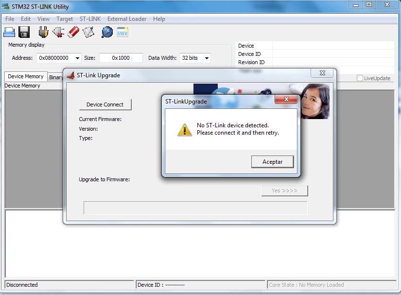

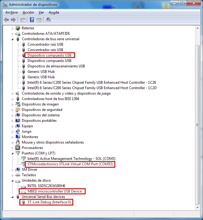

  • My device manager seems to be correct (except for the DFU that I cannot update de driver...)0693W000004JJATQA4.png

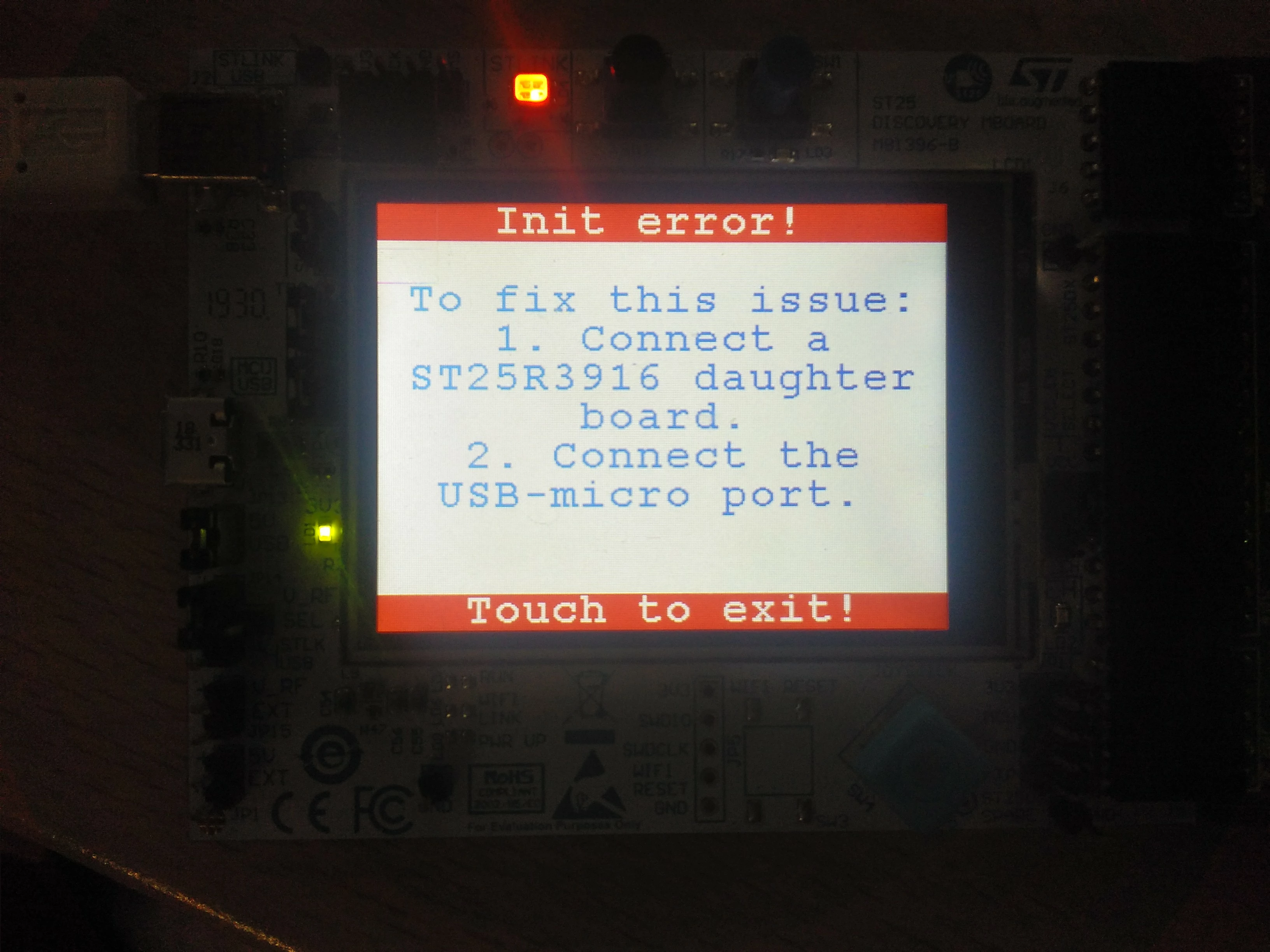

  • On the other hand, here's the LCD message when I connect the ST25R3916-DISCO to the mini-USB port0693W000004JJB2QAO.jpgand I don't know what to do with this ...1) The daughter board is already connected and it works well (I'm able to detect NFC tags) 2) Connect to the USB-micro port leads me to initialize the board application. And it's not what I want. What I want is to be able to connect to the GUI.

  3. Regarding connection to micro or mini USB: Here it depends on setting of JP4. The default is to have power supply from micro USB. If you then only plug mini then some supplies are not there and daughter board does not get powered properly and is not detected. Best to attach both USB plugs if you want to run STM32-STLink

  2. I've removed ST-Link Debug (Interface 0) from my device driver manager listed above (include file drivers also). The driver automatically became to STMicroelectronics STLink dongle and now I can use the ST-Link interface. Strange...but it works well :)
