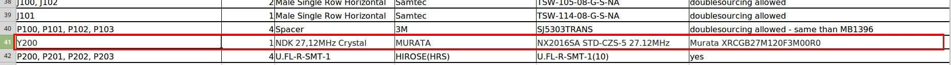

By checking the ST25R3916-DICSO BOM I've found the reference Y200 (27.12MHz Crysta Osc.l)
The problem is I'm not able to find the part number NX2016SA STD-CZS-5 27.12MHz from NDK anywhere. What part is populated in the board? NDK does not give me any information without sharing project details.
On the other hand, the alternative part number XRCGB27M120F3M00R0 from Murata (Lad cap: 6pF) does not match with the load capacitance of the DISCO board (10pF)
Could someone clarify this matter?

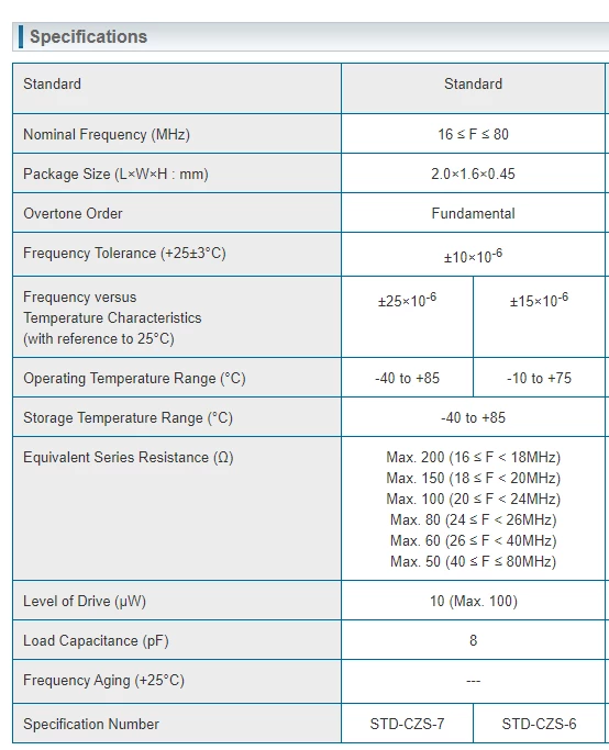

Lets maybe focus on a actual example:
Looking at the NDK hompage i have identified a suiteable crystal: NX2016-STD-CZS-6. It has the following specification:
For calculating the load cap it would mean:
CL = [(C1*C2)/(C1+C2)] + CS + CIC => C1,2  = 2*(CL - CS - CIC)
Where CL = 8pF, CS = 1pF, CIC = 2pF
C1,2 = 2* ( 8 - 1 - 2) = 10pF
The crystal we used has the same load capacitance specifications.
BR Travis
