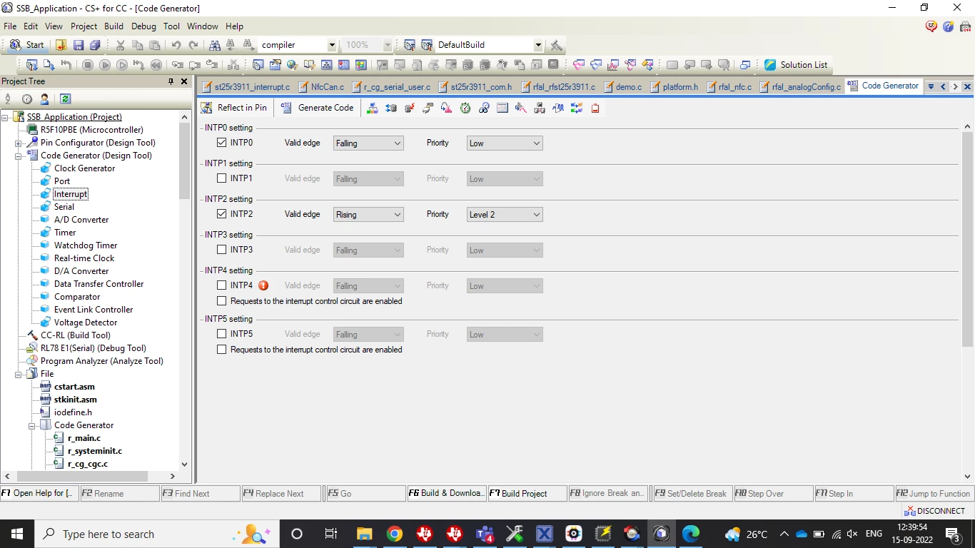

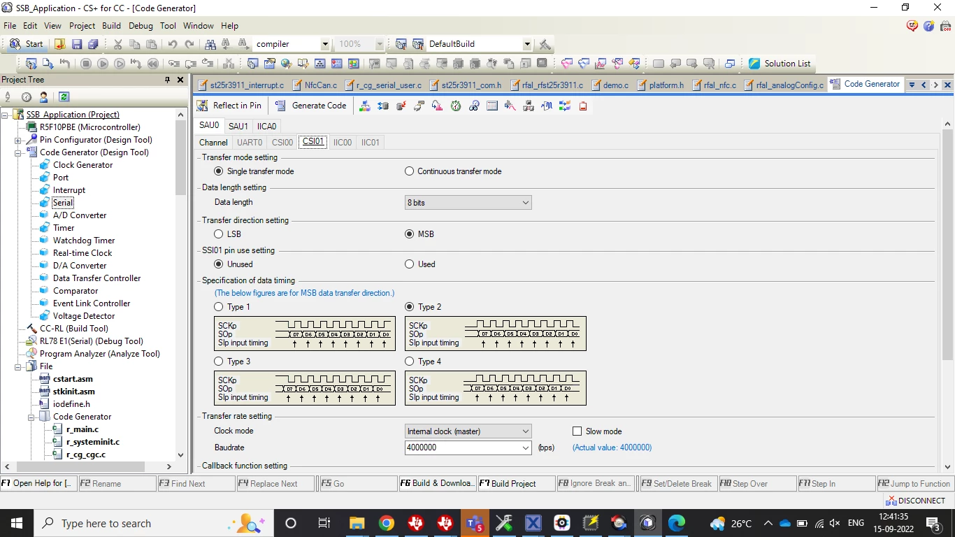

Sep 15, 2022 7:16 AM UTC
These are our interrupt and spi settings please suggest if something it is configured correctly,0693W00000SvRHFQA3.png0693W00000SvRGgQAN.png0693W00000SvRFyQAN.png
Ulysses HERNIOSUS
Sep 15, 2022 9:16 AM UTC
as I told before, the logic analyzer traces indicate correct configuration. As to your other configuration we cannot comment. Also I don't know what your SPI_TX_flag really is.
Please check if your SPI driver can be called from a GPIOs interrupt service routine. It may happen that you need use nested interrupts and give the SPI IRQ a higher prio than the GPIO IRQ. Or move the SPI driver to not use IRQ, etc.

Sep 16, 2022 6:17 AM UTC
The SPI_TX_flag is used for spi transmission complete flag , So initially SPI is sending data to NFC IC and after IC initialization Interrupt is coming only once and SPI communication is stucking , we have tried to change priority of SPI INT as high and GPIO INT as low still facing same issue. Also we are using bare metal application so called str25r3911() from interrupt isr only.
We are not able to find the cause behind this problem please suggest if something we are missing.
cGosa.1
cGosa.1AuthorBest answer
Senior
Sep 19, 2022 7:11 AM UTC
After checking it was interrupt priority issue also the stack code was disabling interrupt so after enabling interrupt from st25r3911_com.c file it is working properly and I am able to detect data.
Thanks for your support!
