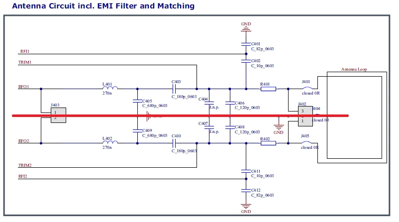

Travis Palmer
Dec 3, 2019 3:32 PM UTC
Hello Verma,
Many Thanks for your inputs! They are really appreciated.
Let me quickly answer your hot topic questions:
1.) The ST25R3911B-DISCO schematic and layout is basically two single ended antennas driven in deferentially.
The upper and lower section of the above picture is exactly symmetric. Also the antenna itself can be separated in two single ended antennas.
This means, by setting the "single" and "rfo2" bit someone could already switch between these two antennas.
2.) The antenna proposal of the STM32WB does not really fit to the frequency range of NFC products. For operating at 13.56MHz a magnetic loop antenna and proper matching network is required.
To your point, there are schematic and layout files (PDF, Altium and Gerber) of our ST25R3911B-DISCO and X-NUCLEO-NFC05A1 available.
If someone does not really want to invest in a VNA, he could just copy the antenna design of those boards on his PCB and reuse the same matching components. Nevertheless, checking the matching network is highly recommended before going into mass production ;)
Surrounding / nearby traces could detune the antenna and therefore require an adaption of the matching network.
3.) Flipping the two above mentioned bits is already possible in the ST25R3911B DISCO GUI. Modifying the two bits in the "CHIP_GENERAL" mode of the Dynamic config tab are all the changes you need to do to operate the reader in single ended mode.
