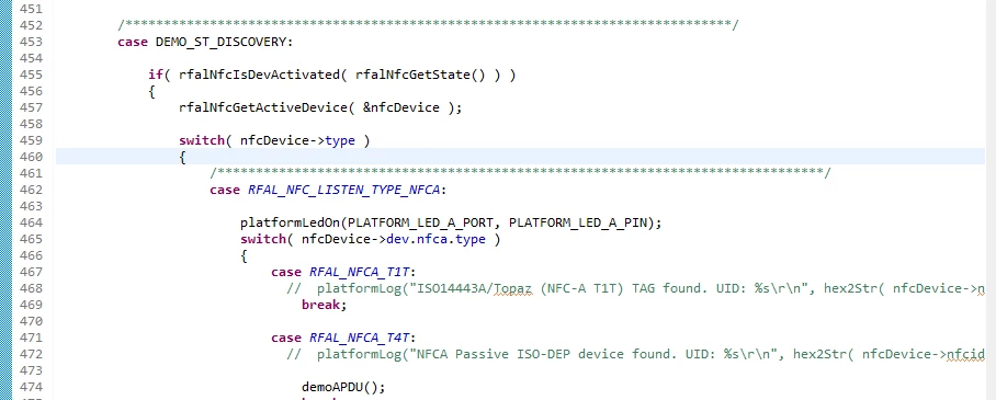

rfalNfcState are just keep fluctuating between RFAL_NFC_STATE_POLL_TECHDETECT and  RFAL_NFC_STATE_LISTEN_TECHDETECT  same as when no tag present in the field of Reader and it is not able to satisfy this if condition.
if( rfalNfcIsDevActivated( rfalNfcGetState() ) ) // this if condition
We observed that even if we do controller reset it doesn’t fix the issue only when we power cycle the reader{st25r3911b} it start working again normally.

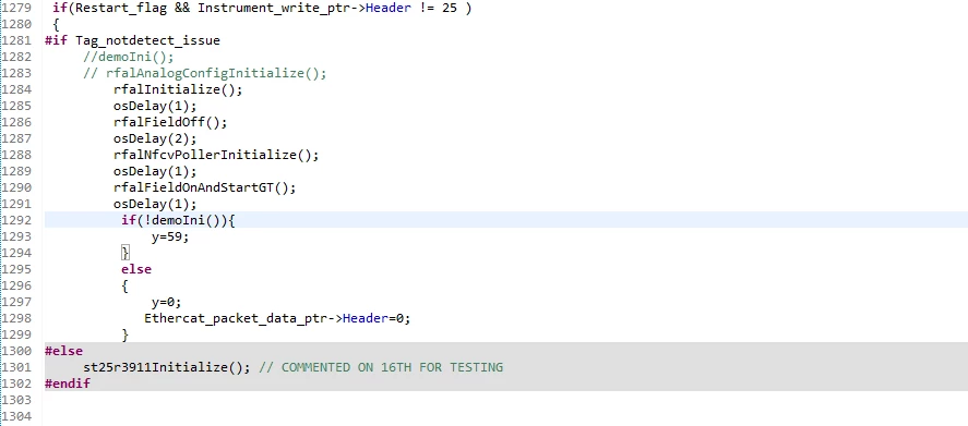

Main.c  {Rfid Reinitialization sequence}
Please help us fix this issue and could you provide or help us that through software function or any register so that can we reset the reader without need to manually power cycle the reader.

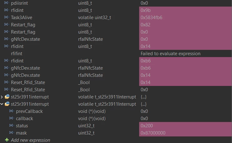

One more observation which we made for interruptregister.status, we have attached the behavior in working state as well as non working state.
Kindly find the attachment below.

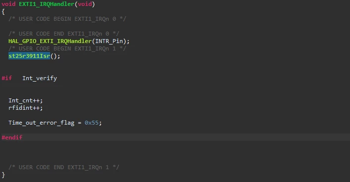

  • Does the design use an STM32 Nucleo board with an X-NUCLEO-NFC05A1 expansion board, or a custom board?
  • How is the ST25 IRQ handled?

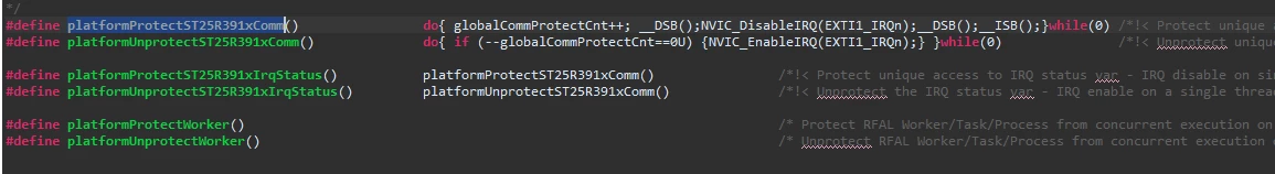

  • How is SPI communication protected between the ST25 IRQ interrupt service routine and the NFC task?

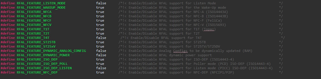

  • Which NFC features are enabled in RFAL platform.h ? Only RFAL_FEATURE_NFCV seems necessary in this application, and possibly RFAL_FEATURE_WAKEUP_MODE.
To restart the ST25R3911B:
  • Do not call rfalInitializerfalFieldOffrfalNfcvPollerInitialize, or rfalFieldOnAndStartGT.
  • Do not call st25r3911Initialize.
  • Call rfalDeinitialize, and then call demoIni.
Ans We Have configured as external Interrupt with priority 2 and calling st25r3911Isr() fn in IRQ Handler.
ISR

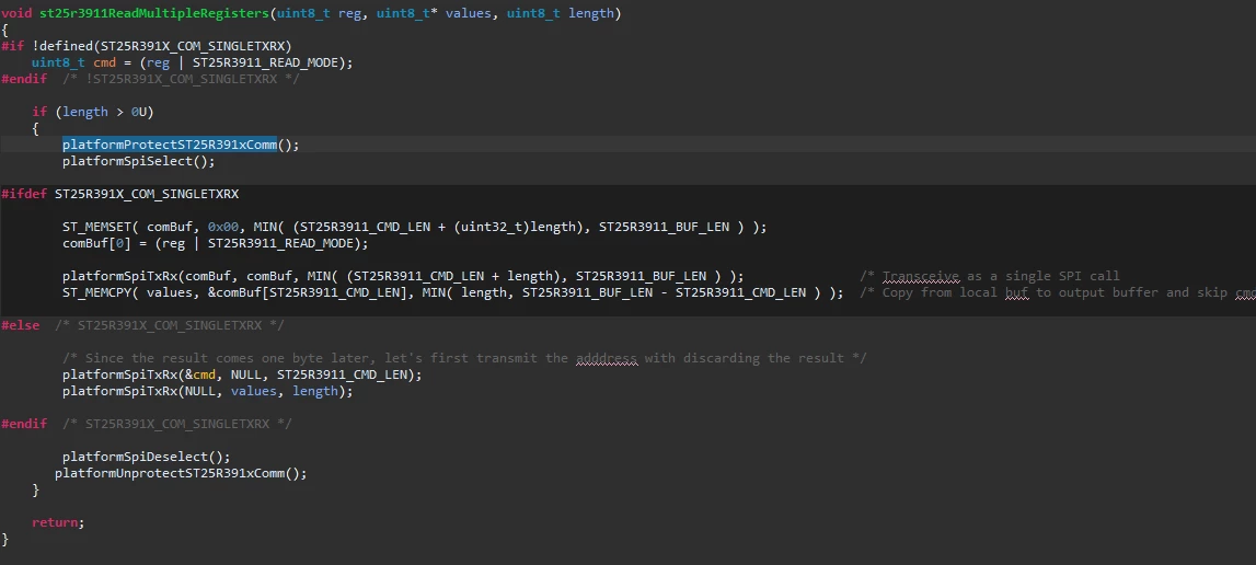

Ans Although we are not using any extensive protection just cs pin we are pulling low/High, Can you suggest what is best ?
Platform.h
st25r3911_com.c

Platform.h
What is the priority of the FreeRTOS timer task, if it is used? The default timer task priority of 2 usually causes many issues. The priority should be higher than the priorities of the other tasks, typically 48
Ans  We are using systick timer for RTOS and it priority is 16.
Is the wake-up mode of the ST25R3911B used?
Ans Yes, we set it true, but not sure about whether it is truly used or not.
Platform.h
 We observed that sometimes not a single interrupt coming from the reader, And as we mentioned that with power cycle it is working again, even if we do controller reset it is not resolving so only which is power resetting additionally is our reader while doing power cycle so we implemented PNP based switching to power on and power off the reader but it is not resolving the issue as after doing power off and power on the reader only once interrupt triggers. so could you verify what we are missing in initialization process which happens with power recycle of whole system but not in our case.

Here are some comments about the additional information:
i/ RFAL configuration
Because only type 5 tags are used in the application, the RFAL configuration can be:
#define RFAL_FEATURE_LISTEN_MODE               false
#define RFAL_FEATURE_WAKEUP_MODE false /* or true if you really use it*/
#define RFAL_FEATURE_NFCA false
#define RFAL_FEATURE_NFCB false
#define RFAL_FEATURE_NFCF false
#define RFAL_FEATURE_NFCV true
#define RFAL_FEATURE_T1T false
#define RFAL_FEATURE_T2T false
#define RFAL_FEATURE_T4T false
#define RFAL_FEATURE_ST25TB false
#define RFAL_FEATURE_ST25xV true
#define RFAL_FEATURE_DYNAMIC_ANALOG_CONFIG false
#define RFAL_FEATURE_DYNAMIC_POWER false
#define RFAL_FEATURE_ISO_DEP false
#define RFAL_FEATURE_ISO_DEP_POLL false
#define RFAL_FEATURE_ISO_DEP_LISTEN false
#define RFAL_FEATURE_NFC_DEP false
ii/ ST25 IRQ management
st25r3911Isr() performs an SPI read of the interrupt registers. In an RTOS, the interrupt service routine must be as short as possible. The ST25 embedded NFC library, STSW-ST25RLIB002, provides an example implementation of ST25 IRQ management for FreeRTOS™ with a dedicated interrupt service routine task. The example targets ST25R3916, but it can also be used for ST25R3911B.
iii/ SPI communication protection
Because st25r3911Isr() performs an SPI read, protect SPI accesses between calls from the interrupt service routine, or interrupt service routine task, and calls from the NFC task. See platformProtectST25RComm in the FreeRTOS™ example of the ST25 embedded NFC library with taskENTER_CRITICAL and taskEXIT_CRITICAL.

I think it is key to better understand the issue. What is happening when it is unsuccessfully fluctuating between RFAL_NFC_STATE_POLL_TECHDETECT and  RFAL_NFC_STATE_LISTEN_TECHDETECT:
  • What is the state of the IRQ pin, is it maybe statically high?
  • Is the field still being turned on? Use a LED field detector or use a scope with the ground loop connected to the tip to see the 13.56MHz carrier.
  • Are the functions for technology detection still executed without error?
    • If there are unexpected errors: Please debug into it to find the variable or register causing this.
  • Provide register snapshots when the issue happens vs when the tag is in normal state simply not in the field. Maybe taken after rfalNfcvTechnologyDetection()
  • Does it only happen at higher or lower temperature?
Most of this would become visible from a logic analyzer trace.

Actually, there are two possible problems we are facing mostly at higher temps (>55* C) as reader is inside Actuator
  1.   Interrupt trigger by timeout is coming as usual but not able to detect the tag irrespective of Distance. Here slave state is fluctuating between RFAL_NFC_STATE_POLL_TECHDETECT and  RFAL_NFC_STATE_LISTEN_TECHDETECT.
  2. No single interrupt getting triggered from the reader. {in this state interrupt.status is 0000 and interrupt.mask is 0xff} in this state is stucking in RFAL_NFC_STATE_LISTEN_TECHDETECT.

Sorry for late reply as we were trying to capture the SPI signals and wanted to read register when ERROR occurs in the system, we finally captured, I have attached csv file as well as 3D images and schematics of my reader. I’m also attaching my project file which I changed as suggested by Brian, we tried these 2 code one with updated libraries and interrupt based where democycle and st25r3911bisr() will run in their respective task and other one we tried with polling with same updated RFAL libraries, we only faced issue in polling one, we haven’t face issue in RTOS based yet {in RTOS based we implemented one safety patch incase interrupt stuck which might be helping it to retrieve it.

static ReturnCode ST25R_OscKick(void)
uint8_t id = 0;
/* Chip must answer on SPI first - otherwise there is nothing to enable */
st25r3911ReadRegister(ST25R3911_REG_IC_IDENTITY, &id);
if ((id & ST25R3911_REG_IC_IDENTITY_mask_ic_type) != ST25R3911_REG_IC_IDENTITY_ic_type)
return RFAL_ERR_HW_MISMATCH; /* not powered / not responding */
/* Force OscOn to actually run its enable + 10 ms wait */
st25r3911ClrRegisterBits(ST25R3911_REG_OP_CONTROL, ST25R3911_REG_OP_CONTROL_en);
return st25r3911OscOn();
static bool ST25R_IsHealthy(void)
uint8_t op = 0, auxd = 0, rfo = 0;
st25r3911ReadRegister(ST25R3911_REG_OP_CONTROL, &op);
st25r3911ReadRegister(ST25R3911_REG_AUX_DISPLAY, &auxd);
st25r3911ReadRegister(ST25R3911_REG_RFO_AM_ON_LEVEL, &rfo);
return ((op & ST25R3911_REG_OP_CONTROL_en) != 0U) && /* chip enabled */
((auxd & ST25R3911_REG_AUX_DISPLAY_osc_ok) != 0U) && /* oscillator up */
( rfo != 0x00U ); /* analog cfg applied */
bool ST25R_Recover(void)
/* Rung 1 - oscillator only, ~15 ms. Mostly diagnostic: it proves the crystal
// can start, but it does NOT reapply the analog configs. */
if ((ST25R_OscKick() == RFAL_ERR_NONE))
return true;
/* Rung 2 - full stack re-init. THIS is what reapplies CHIP_INIT (rx_man)
and the tech-specific RFO levels. */
rfalDeinitialize();
osDelay(10);
if (demoIni() )
return true;
/* Rung 3 - hardware power cycle, with the corrected rail-before-pins order */
ST25R3911_PowerOff();
osDelay(300);
if (ST25R3911_PowerOn() )
static uint8_t xt=0;
Ethercat_packet_data_ptr->Tag_write_data.Last_used_year = xt++;
return true;
return false; /* caller keeps its latch set and retries later */
