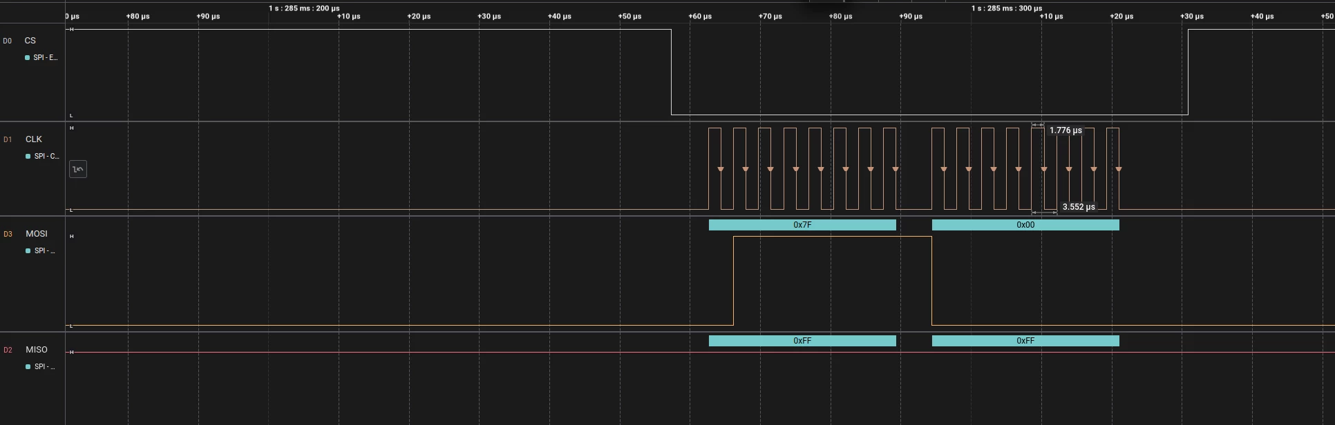

I got back to my issues from this post.
I was able to connect wires to SPI lines, and get the measurements to logic analyzer. These are the results:
Logic2 screenshotLogic2 screenshot
Now i can see that the issue is the CS line, but i dont know why it is being changed to HIGH in these short pulses.

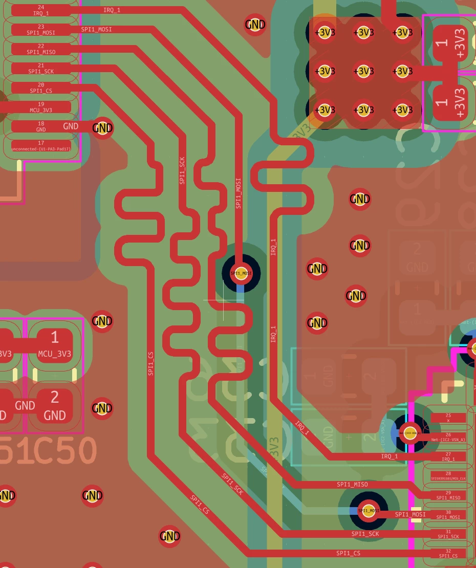

And the PCB Traces:

Andrew Neil
January 27, 2026
@qwdwdwwq wrote:
Now i can see that the issue is the CS line, i dont know why it is being changed to HIGH in these short pulses.
Not just CS - it's also on MOSI
Looks like noise being picked up; try looking at it with your scope - in the analogue domain.
What's with the wiggly bits on the SPI traces?
One wouldn't usually worry about equal trace lengths on SPI, but it does look like a good way to pick up interference...

Ulysses HERNIOSUS
January 27, 2026
besides twisting and putting wires 90 degrees away from the antenna:
  • Incorrect SPI config in Saleae. Correct one here:
  • Enable Glitch filter in Saleae:
  • Looking at raw (ignoring the noise): MOSI shows correct 7F (read IC ID) but no activity on MISO
    -> Maybe MISO pin not correctly configured from MCU side? You could open MISO line on MCU side and observe.
Best Regards, Ulysses

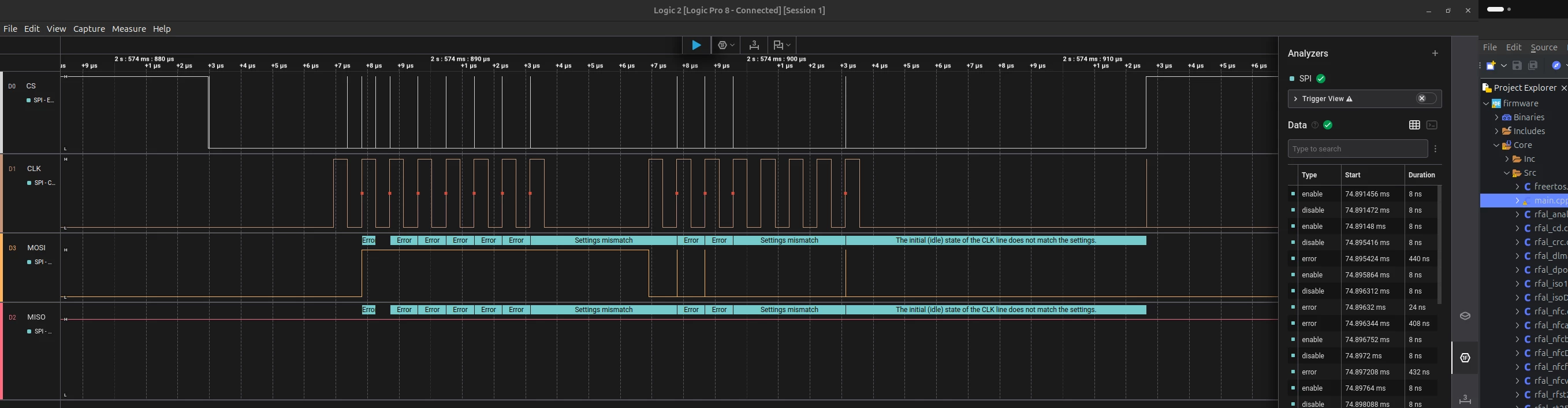

Thank you for help. I enabled the Glitch filter and the peaks are gone:

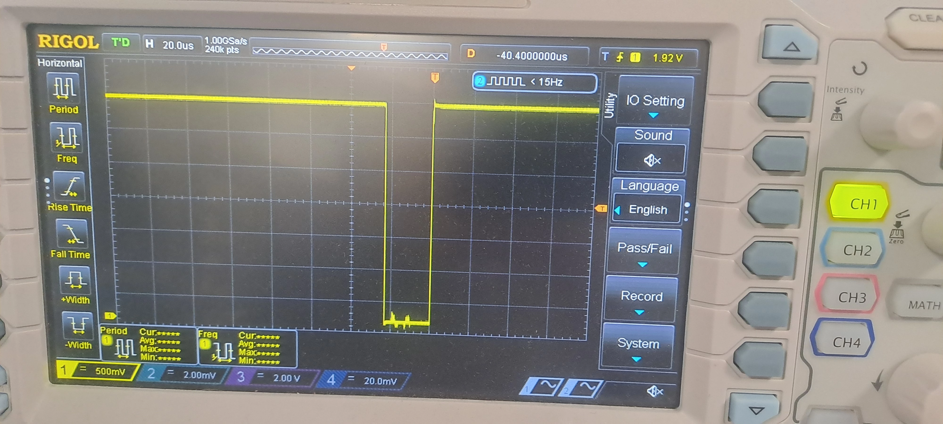

 I also checked the CS line with the scope:

Also, when i short MOSI and MISO, the MCU is able to read the loopback communication
