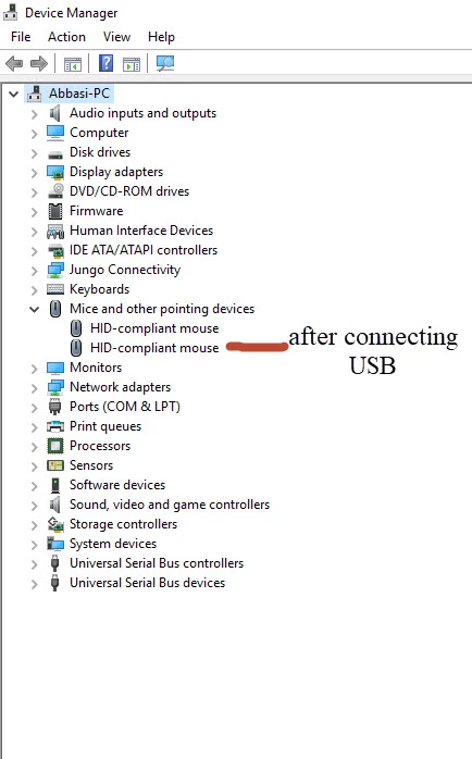

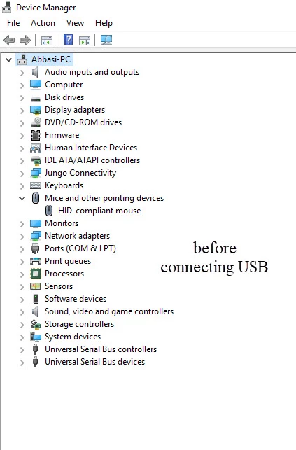

    November 14, 2018
    My problem solved and now I have a SPI communication by st25r3911b .
    my new problems are :
    1- External interrupt pin does not changed at all , I think when i close a mifare card in its antenna is should change , am I right ?

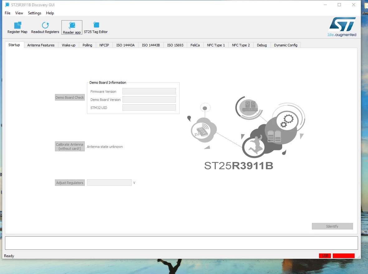

    2- The ST25R3911B Discovery GUI program has no communication to it, I make a usb device for it and I am not sure in windows Device Manager what driver should add when ever I connect it to PC.0690X000006CN1KQAW.jpg

    Travis Palmer
    November 14, 2018
    ​Dear Dariush,
    1.)
    When enabeling the en and tx_en bit, do you see a signal on the RFO pins?
    When sending a direct command D3 (measure amplitude) to the ST25R3911B, an interrupt will be generated by the ST25R3911B afterwards. If you do not see any interrupt, i would recommend to check the following items:
    A.) Check resistance of IRQ line against VDD, VDD_IO, GND. (board disconnected, should be higher than 100k)
    B.) Probe with a scope the IRQ line during sending a D3 command.
    C.) Check voltage level of VDD_IO supply
    D.) Probe with a scope, if the OSC is working propperly when bit "en" is set.
    2.) When the ST25R3911B-DISCO board is connected you should be able to find a HID Device with HID\VID_0483&PID_3721&REV_0200&MI_00 .
    The driver is delivered by Microsoft / Windows. No additional installation needed.

    DAbba
    DAbbaAuthor
    November 17, 2018
    Thank you
    about ST25R3911B Discovery GUI program , now I have hid device in my control panel and I am sure that driver is OK .
    but still I have no communication in usb :

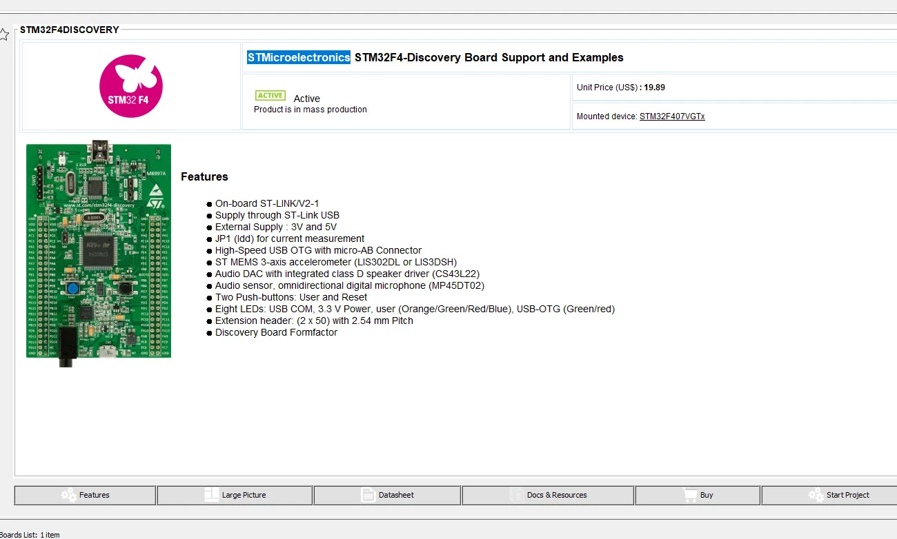

    0690X000006COSqQAO.jpg0690X000006COSlQAO.jpgcould you please simply help me about it ?
    I am using stm32f4 discovery board and I made my own board in SPI connection to this board.
    can I send commands to it directly and select an is1443a card (for example)?
    Ulysses HERNIOSUS
    November 19, 2018
    Hi Dariush,
    The GUI uses USB VID and PID to identify the boards. Please carefully review the USB descriptors.
    Ulysses
