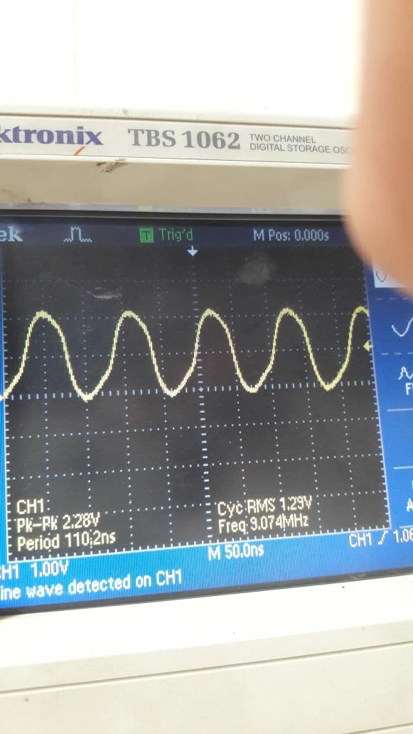

Also we have noticed that frquency of 9MHz on CRO across the crystal, so it is Okay ?

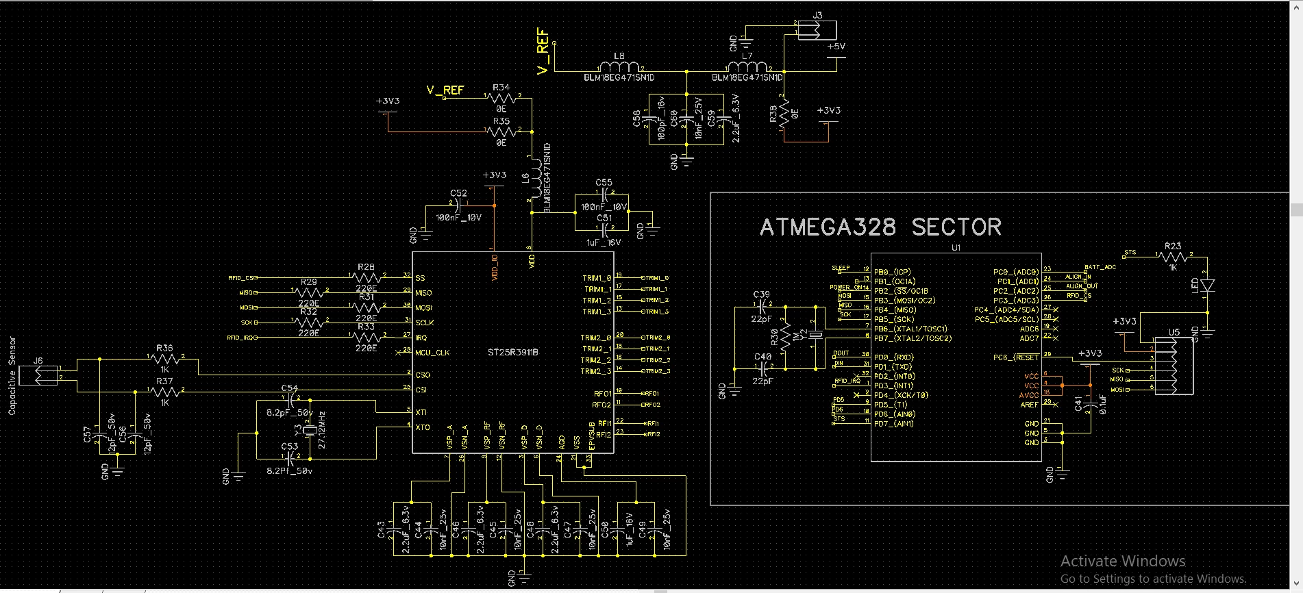

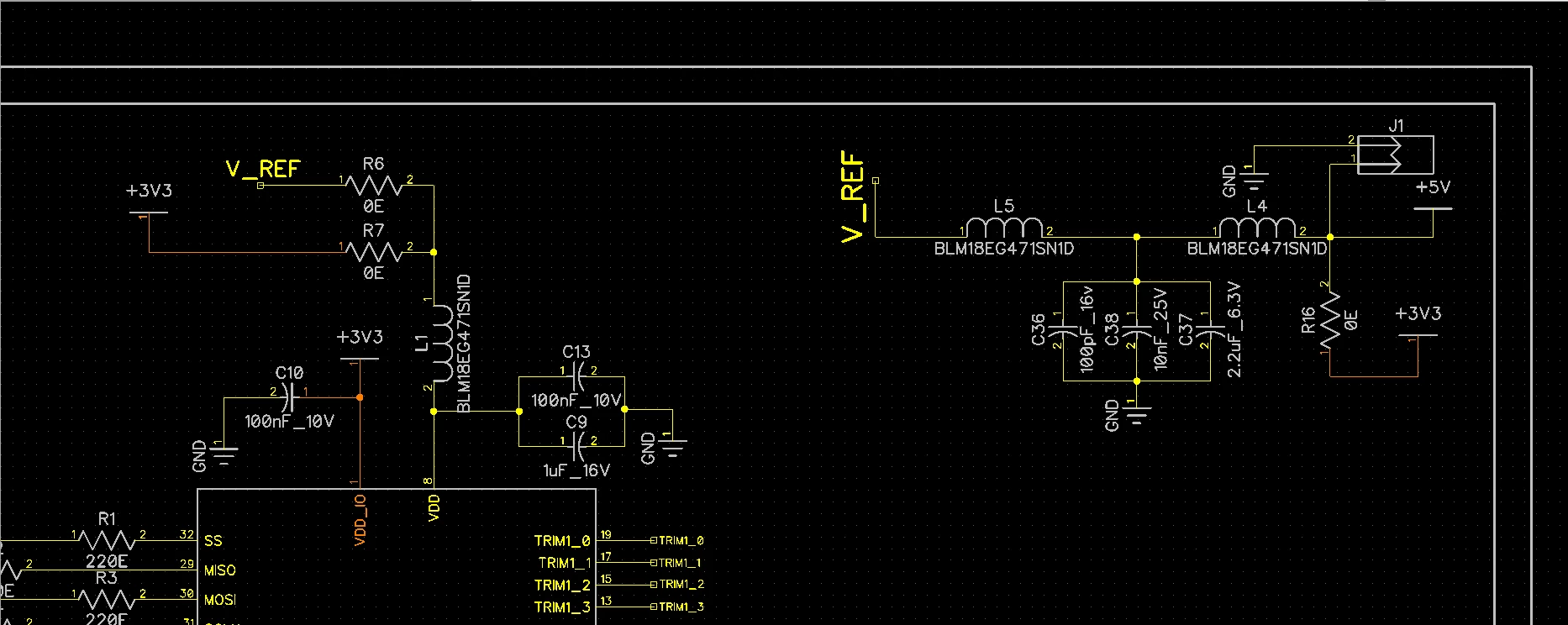

Moreover need a review on Power Supply section of the schematic.
I am attaching the screenshot , and in this

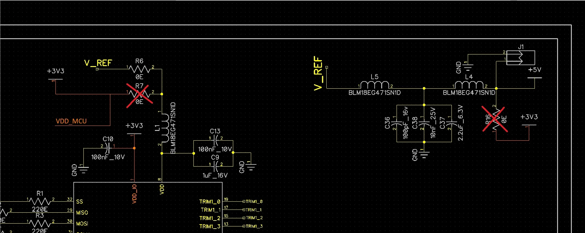

we have kept R7 Open and +5V Not Connected.
So any guess what is causing the issue ?

    Looking at your power circuit it looks good.
    I assume R16 and R7 are not connected. Your MCU is connected (VDD_MCU) to "+3V3".

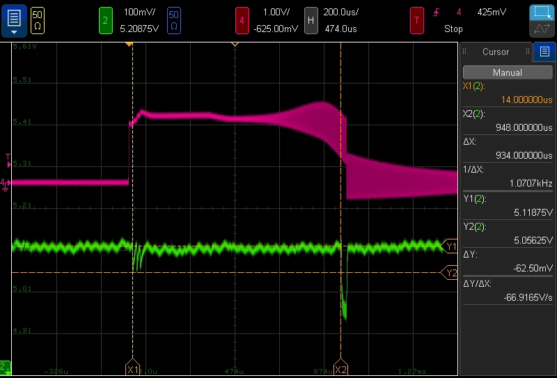

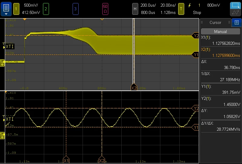

    The 9MHz at the crystal sounds very strange to me. At the time you enable the osc, a signal will be driven by the ST25R3911B on the XTO pin. This signal is causing the crystal to resonate. If you attach a scope you should see the following picture:
    Green channel: VDD
    Red channel: XTI
    around 874us (at my scope shot) the crystal is already resonating at 27.12MHz. The magnitude of the crystal signal should be around 0.7Vpp to 1Vpp at the end. Please ignore the shape past Marker X2 since it is related to the wake-up pulse and turning off the crystal.
    please let me know, if you are seeing the same signals on your board.
    BR Travis

    As mentioned in my query , we have not connected "+5V" in the circuit.
    Everything is powered with "+3.3V", so we have connected "R16 and R6" and "R7" was left open. The "+5V" is kept for future use and not connected as of now.
    Yes correct MCU is connected to to same "+3.3V".
    So do we need to provide "+5V" also ?
    I am attaching entire schematic for reference, please have a look on it and do suggest us.
    Also , will the problem in supply section cause the problem in oscillator frequency ?
    Thank you.

    VDD can be connected to +3V3 (same voltage as VDD_IO).
    As long as VDD_IO and VDD are powered there should be no problem at all.

    3. We have connected "R6 and R16" and kept "R7" open , i.e. providing VDD and VDD_IO with 3.3V supply.
    4. One thing we have noticed that , we had misplaced the Capacitor in Antenna Circuit "680pF_50V" , so we have connected their parallel combination of "470pF+220pF" , so will it cause problem in detecting Tag ?
    5. The frequency across the crystal is still the same i.e. 9MHz , I have attached the picture of that.
    So I guess we are very close now in detection of tag , so please guys suggest something which are creating the problem.

    If components are missing in the matching circuit, you will most likely have problems detecting the tags. This can cause either a reduced detection range or no detection at all.
    It seems, that there is something wrong with your crystal. It should either resonate at 13.56MHz or 27.12MHz. The bit "osc" in the IO Configuration Register 1 has to be set accordingly. Can you maybe populate the crystal of the ST25R3911B-DISCO or NFC05A1?
    I just measured the XTI pin of the ST25R3911B-DISCO.
    BR Travis
