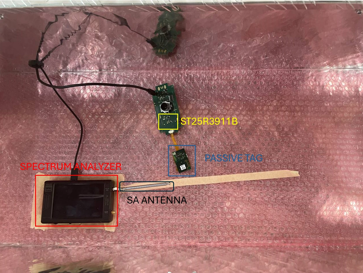

- The tag is in the reader field during the dump of register's content while the reader antenna is a custom printed antenna. I am sure of the correct NFC pairing between the passive tag and the reader cause I set a blinking led feedback on the custom printed PCB that host the ST25R3911B.
- I am measuring the spectrum using a SA as in the setup shown in the attached image:
The setup is installed inside a metal box.
I am quite sure that this partially answers to @Travis Palmer 's questions anyway I would like to give to you some more details regarding the HW configuration we used for the ST25R3911B. This is only becauise now my main issue is to reduce the power associated to the second harmonic of the signal. After that I weill go on with the lowering the output power of the chip itself.

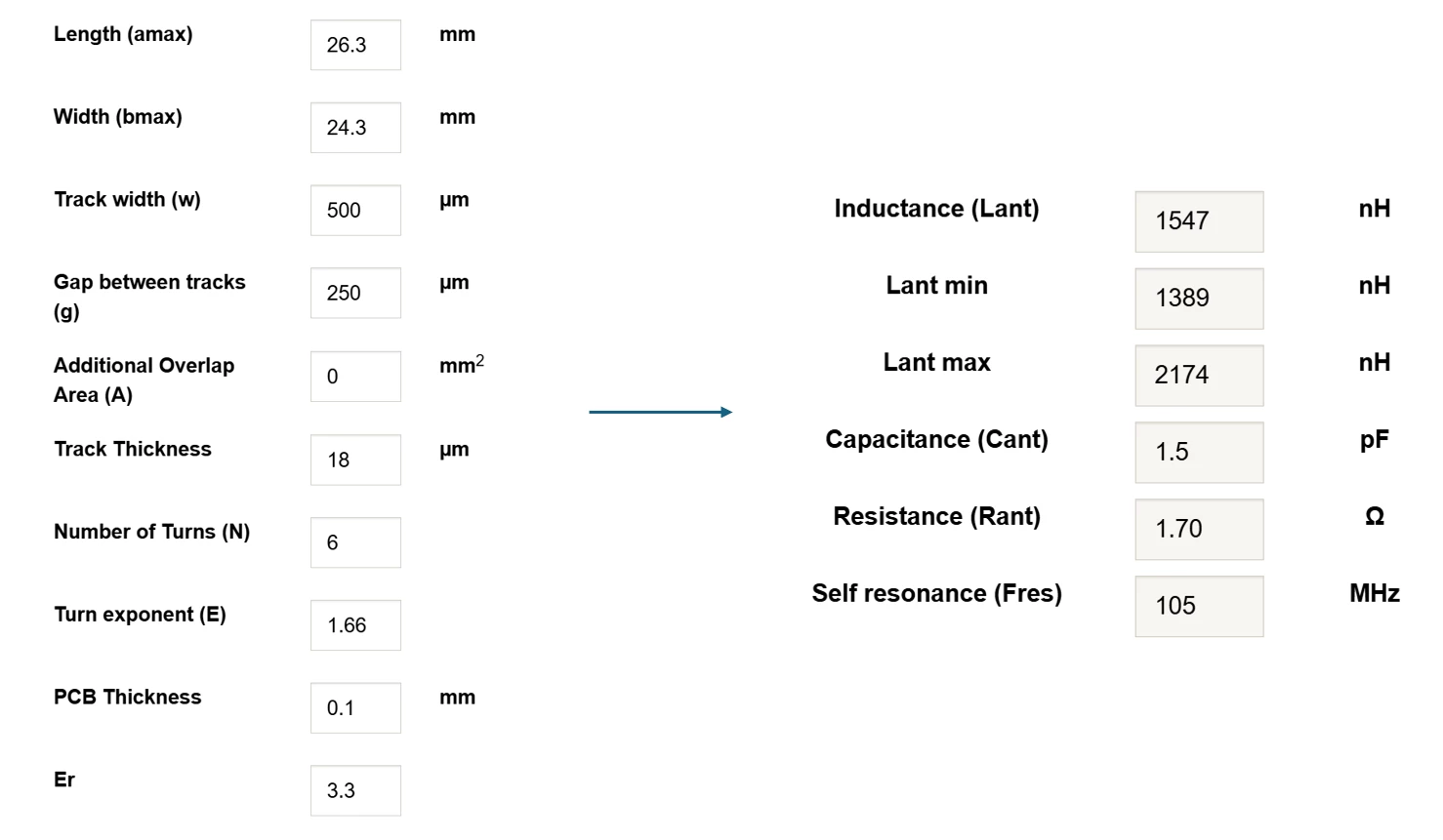

Assuming that we are using an antenna (for the NFC) that has this characteristics:

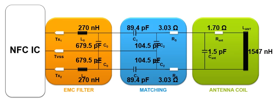

Using then a tool for the antenna matching I found out that the suggested matching circuit is this:

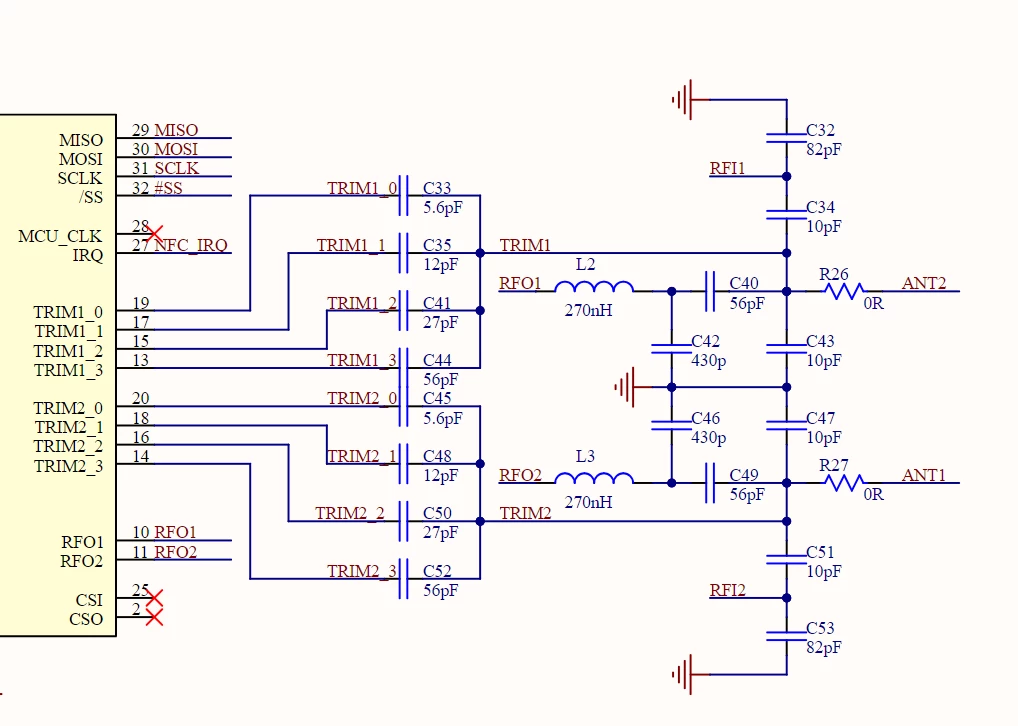

Which is not that different (at least for the EMC filter) with respect to the one used on the custom PCB I am referring to, which is the following:
So, assuming that the coupling circuit is well designed (I hope that makes sense to you as well), my final guess to try to solve the problem involves AM modulation.

May 27, 2024
Hi Travis,
unfortunately the latest RED 2014/53/EU related tests performed on this configuration have not been passed. So my task, as I write in the first posts of the topic, is to lower the power output from the chip and reduce the amplitude associated with harmonics of higher than first order.
I realize that the setup for measurement is not optimal but I need it to have an estimate, albeit a rough one but still an estimate, of the frequency content of the field produced. Unfortunately, following the setup described in Chapter 5.3 of ISO10373-6 would be too great a complication for this stage of development. This is the reason why I was asking for your help. In particular, I ask the question again, do you see any particular discrepancies in the chip configuration? Could these abnormal behaviors (second harmonic so high) be attributable to use of particular types of components? I thank you in advance for your time and if I can be of any help in providing any new information I remain at your disposal.

Travis Palmer
May 28, 2024
Hello Luigi,
could you share the part of the layout related to the NFC IC? Especially related to VSP_RF and VDD decoupling and supply filtering.
Another question is, how the device performs without the tag being placed on the antenna. Do you still see the same spurs. There are certain tags where the limiter inside can cause such emissions if the voltage on the tag antenna is too high. If it is not possible to change the distance in the final application, the antenna geometry could be changed to reduce the coupling.
