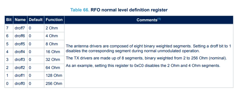

I'm working with ST25R3911B and in my application i want to control the field strengh.
I relied on the documentation at this chapter : 1.3.40 RFO normal level definition register page 80 in the Datasheet - ST25R3911B - High performance HF reader / NFC initiator with 1.4 W supporting VHBR and AAT
And, if i understand well if i write 0x00 in the 0x27 register it will enable all Ohms segments, it will make 510 ohms.
If i write 0x01 510-256=254 right ?
But when I test my application with a field detectorit it doesn't seem to react as expected.
Am I doing something wrong ?
Best regards,
Yvan
Best answer by Ulysses HERNIOSUS
Hi Yvan,
the segments of the drivers are parallel. Thus you also need to apply calculation of parallel resistors, not series resistors (check e.g. https://en.wikipedia.org/wiki/Resistor).
Regards, Ulysses

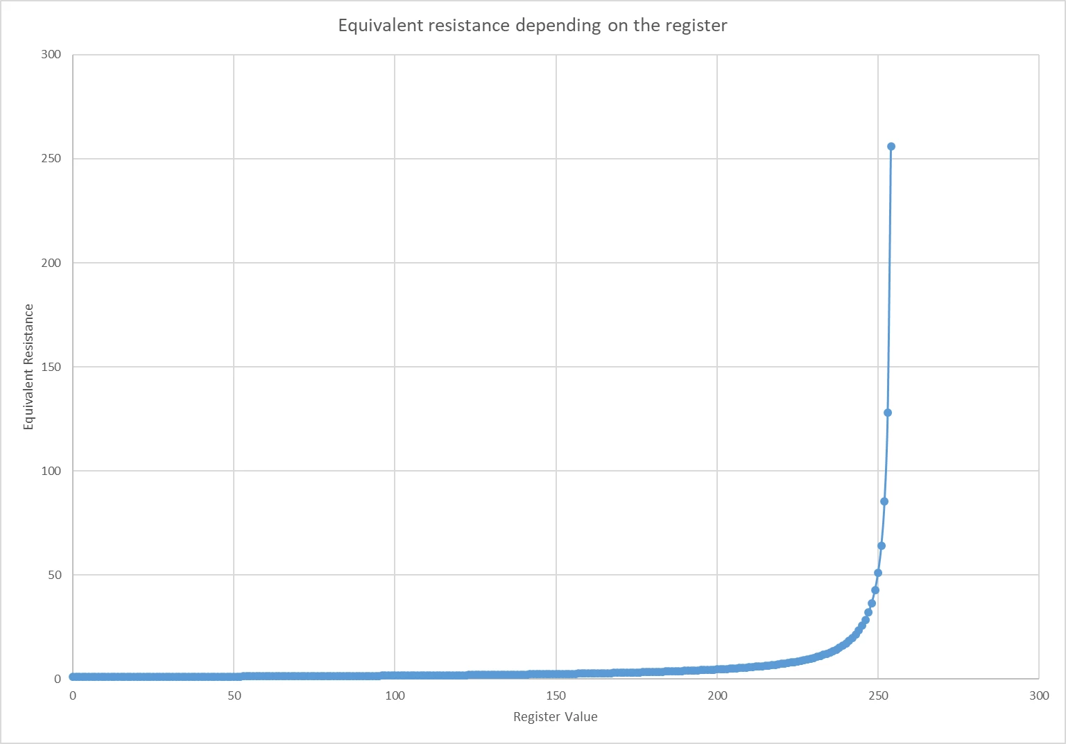

SnoZek
SnoZekAuthor
August 4, 2023
Hello Ulysses,
Thanks for help
If i understand well the value of the resistance depending on the register looks like this ?
Regards,
Yvan
Ulysses HERNIOSUS
August 7, 2023
Correct.
