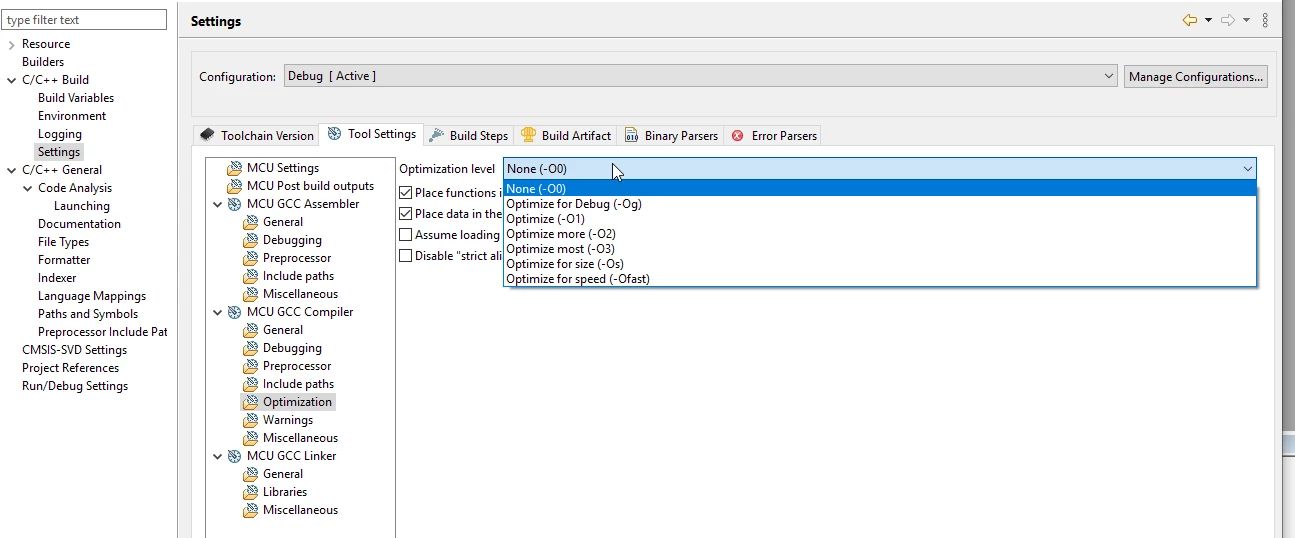

EBadi.2
February 4, 2021
I have the same issue, but I don't know how to change optimization level to -O3 as you say.
Ulysses HERNIOSUS
February 5, 2021
Hi EBadi.2,
which MCU + toolchain are you using?
Typically you need to go to Options/Properties of your build target and look around in the C/C++ settings. As example I attach where to find in STM32CubeIDE.
0693W000007E3JWQA0.pngBest Regards, Ulysses
