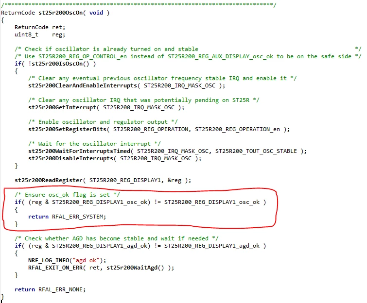

July 11, 2025

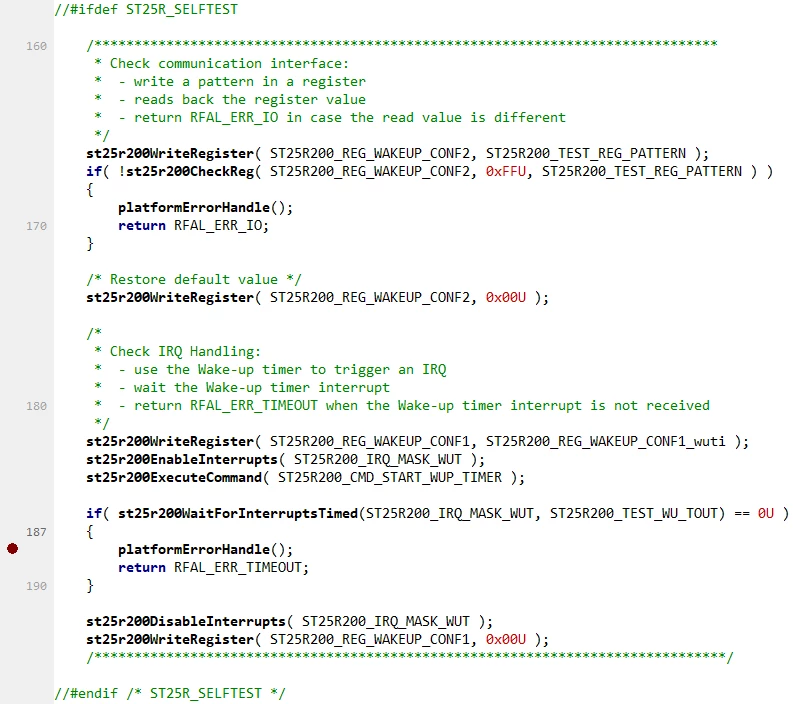

the first step of the RFAL library is that in rfalInitialize() and st25r200Initialize() which is inside rfalNfcInitialize(), osc_ok is not set in st25r200OscOn() function and it throws an error. What can I do?
Brian TIDAL
July 11, 2025
The porting of timer management or interrupt management to your platform is likely the cause of this issue (most probably the timer management). Can you provide more information about your platform? For example:
  • Is it bare metal or RTOS?
  • Which RTOS is being used?
  • How is interrupt management implemented?
  • How is timer management implemented?
Can you enable the ST25R_SELFTEST and ST25R_SELFTEST_TIMER compilation flags and move the call to st25r200OscOn and st25r200TxRxOff after the ST25R_SELFTEST_TIMER code? Is the self test code completing correctly or returning an error?

Hello, I did as you said. I am getting an error in st25r_selftest.

July 17, 2025
If I am not mistaken, the ST25R_SELFTEST_TIMER is based on the general-purpose timer of the ST25R reader device. Therefore, this requires the oscillator to be on. My previous post about moving st25r200OscOn after ST25R_SELFTEST_TIMER was a bad idea.
Regarding your question about "Is there a function I need to run when an interrupt is triggered?": st25r200Isr() must be executed when the ST25R100 signals the interrupt line.
