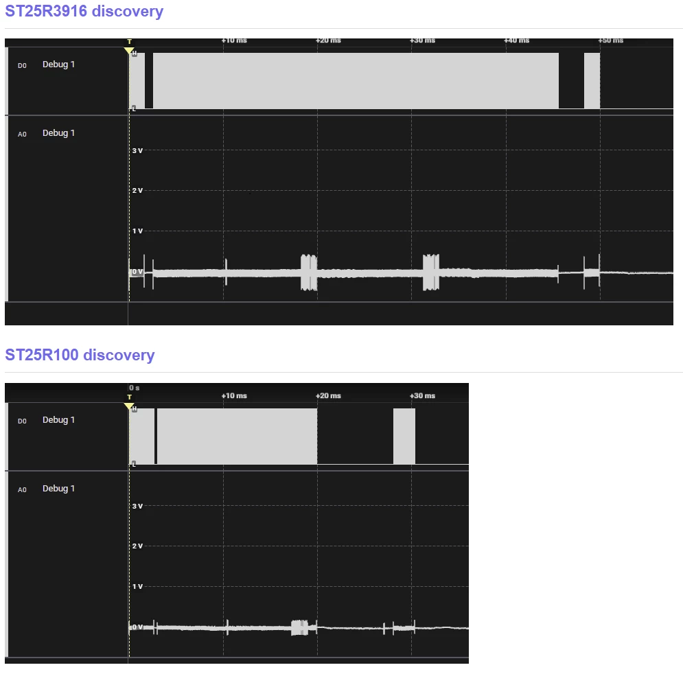

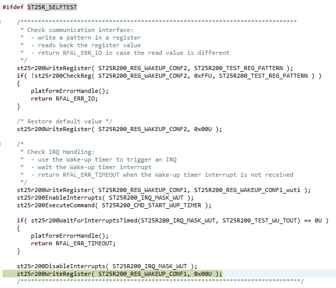

Hi there
Starting point
I am currently working on porting our NFC implementation from the ST25R3916 to the ST25R100.
We will also replace our current library (Lib-NFC & ST_25r & RFAL) and use the current libraries (RFAL and NDEF) from ST.
For the migration I currently use a NUCLEO-U575ZI-Q board and two NFC shields (X-NUCLEO-NFC06A1 with the current ST25R3916 and X-NUCLEO-NFC09A1 with the new ST25R100).
I already successfully migrated our implementation to the new library. I'm able to poll for NFCA and NFCV tags using the X-NUCLEO-NFC06A1 shield.
Issue Description
  • With the X-NUCLEO-NFC09A1 shield connected, I'm not able to discover any NFCA or NFCV tags. Communication with the ST25R100 seems to work just fine (no errors).
  • gNfcDev.state enters states: RFAL_NFC_STATE_START_DISCOVERY, RFAL_NFC_STATE_POLL_TECHDETECT and RFAL_NFC_STATE_LISTEN_TECHDETECT (which indicates that no tag has been detected)
May you have a clue why ST25R100 sees nothing?
Any support is highly appreciated.

The function that initializes the RFAL library (and predefines the discovery parameters):
bool_t NfcInterface_bInit(const NfcInterface_EventHandler_t pxEventHandler, const NfcInterface_GetSystemUpTime_t pxGetSystemUptime, uint8_t u8RxConfReg3Value, uint8_t u8DetectMode)
	// register handler/Adapters
	tEnv.pxEventHandler = pxEventHandler;
	tEnv.pxGetSysUpTimeAdapter = pxGetSystemUptime;
	tEnv.u16Rssi = 0;
	// Initialize RFAL NFC discovery parameters
	rfalNfcDefaultDiscParams(&tEnv.tRfalNfcDiscoverParam);
	tEnv.tRfalNfcDiscoverParam.devLimit = NFC_MAX_DEVICE_COUNT; // 2 devices
	tEnv.tRfalNfcDiscoverParam.totalDuration = RFAL_NFC_WORKER_DEVICE_DISCOVERY_TIMEOUT_MS; // 1000ms
	tEnv.tRfalNfcDiscoverParam.techs2Find = RFAL_NFC_POLL_TECH_A | RFAL_NFC_POLL_TECH_V;
	tEnv.tRfalNfcDiscoverParam.notifyCb = vRfalNfcEvHandler; // This handler is mandatory to avoid that the library autoselects the first tag (even if multiple tags have been discovered)
	// Initialize RFAL library
	ReturnCode eRfalErr = rfalNfcInitialize();
	LOG_ERROR_IF(eRfalErr != RFAL_ERR_NONE, "NFC initialization failed: error = %u", eRfalErr);
	RETURN_IF(eRfalErr != RFAL_ERR_NONE, FALSE);
#if defined(ST25R3916) || defined(ST25R3916B)
	// disable AAT (automatic antenna tuning)
	uint8_t u8RegValue = 0u;
	st25r3916ReadRegister(ST25R3916_REG_IO_CONF2, &u8RegValue);
	u8RegValue &= ~(1<<5);
	st25r3916WriteRegister(ST25R3916_REG_IO_CONF2, u8RegValue);
	// set gain boost based on setting
	st25r3916WriteRegister(ST25R3916_REG_RX_CONF3, u8RxConfReg3Value);
#endif
	NfcInterface_vSetPower(TRUE);
	return true;
The function that runs the discovery:
(annotation: The actual discovery is performed synchronously... by calling rfalNfcWorker until the expected rfal nfc state has been reached. This is because of our legacy API that expects synchronous functions.)
bool_t NfcInterface_bRfalDiscoverTags(bool_t bForceReDiscover)
	rfalNfcState eRfalNfcState = rfalNfcGetState();
	bool_t bAlreadyDiscovered = (eRfalNfcState == RFAL_NFC_STATE_POLL_SELECT) || (eRfalNfcState == RFAL_NFC_STATE_ACTIVATED) || (eRfalNfcState == RFAL_NFC_STATE_LISTEN_TECHDETECT)? TRUE : FALSE;
	LOG_ERROR_IF((bForceReDiscover != TRUE) && (bAlreadyDiscovered != TRUE), "Tag Discovery failed: eRfalNfcState %u", eRfalNfcState);
	RETURN_IF((bForceReDiscover != TRUE) && (bAlreadyDiscovered != TRUE), FALSE);
	if(bForceReDiscover == TRUE)
		NfcInterface_vResetDeviceList();
		// Perform Tag discovery
		ReturnCode eRfalErr = rfalNfcDiscover(&tEnv.tRfalNfcDiscoverParam);
		LOG_ERROR_IF(eRfalErr != RFAL_ERR_NONE, "Failed to initiate NFC Discovery: Return Code %u", eRfalErr);
		RETURN_IF(eRfalErr != RFAL_ERR_NONE, 0);
		// Run worker until device discovery is finished
		eRfalNfcState = eRfalRunNfcWorker(RFAL_NFC_WORKER_DEVICE_DISCOVERY_TIMEOUT_MS,
				RFAL_NFC_STATE_POLL_SELECT, // State entered if multiple tags have been discovered
				RFAL_NFC_STATE_ACTIVATED, // State entered if one tag has been discovered
				RFAL_NFC_STATE_LISTEN_TECHDETECT); // State enteren if no tag has been discovered
	else{} // Dont initiate discovery if not already done
	LOG_DEBUG("State after tag discovery: %u", eRfalNfcState);
	bool_t bSuccess = (eRfalNfcState == RFAL_NFC_STATE_POLL_SELECT) || (eRfalNfcState == RFAL_NFC_STATE_ACTIVATED) || (eRfalNfcState == RFAL_NFC_STATE_LISTEN_TECHDETECT)? TRUE : FALSE;
	LOG_ERROR_IF(!bSuccess, "Tag Discovery failed: eRfalNfcState %u", eRfalNfcState);
	return bSuccess;
static rfalNfcState eRfalRunNfcWorker(uint32_t u32TimeoutMs, rfalNfcState eTargetState1, rfalNfcState eTargetState2, rfalNfcState eTargetState3)
	const uint32_t u32TimeoutThreshold = SupTimer_u32GetCounter() + u32TimeoutMs;
	do
		rfalNfcWorker();
	} while((SupTimer_u32GetCounter() < u32TimeoutThreshold) &&

Ulysses HERNIOSUS
January 30, 2025
Hi Stefan,
baseline points:
  1. How is the ST25R100 reset pin connected?
  2. Please enable ST25R_SELFTEST
  3. Can you observe if an RF field is emitted? Either LED based field detector or oscilloscope with a loop of the GND cable to the tip
  4. Please share a logic analyzer trace with SPI and INT pin.
BR, Ulysses
Stef2Author
February 3, 2025
Hello Ulysses
Thanks for your support (and sorry for the delay).
  • Reset pin is connected to GND
  • Ok, I'll enable selftest and see what info I can get out of it
  • Yes, I observe an RF Filed, as soon as I start the discovery procedure (see image below)
  • I'll do a trace and post it (have access to a logic analyzer tomorrow)
Stef2Author
February 3, 2025
Ok... I've enabled ST25R_SELFTEST (first taught that's kind of a chip testmode, but its additional testcode which is part of the st25rx specific RFAL).
That Test runs through without any error...

Ulysses HERNIOSUS
February 4, 2025
I think you are using compile time flag RFAL_ANALOG_CONFIG_CUSTOM and supply some custom analog config file for 3916. Please disable/remove RFAL_ANALOG_CONFIG_CUSTOM and then the R100 should start working.
BR, Ulysses
Stef2Author
February 4, 2025
That was the issue... tag detection works now. I didn't have this flag on my radar, as the related file was located in another corner of our project structure.
