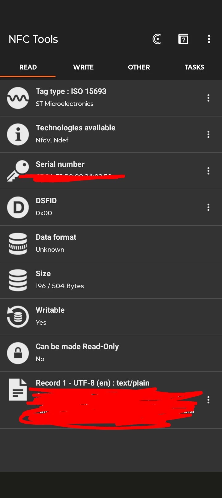

NFC-Tag:
- ISO 15693
- NfcV, Ndef technology
- 196 Bytes of data

Thanks a lot!
I got it reading the UID from my tag now just the data, but I'm sure I'll figure it out!
Thank you,
Kind regards, William
