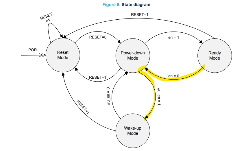

ST25R100: autonomous WU_MEASUREMENT never emits RF, but manual CALIBRATE_WU_MEASUREMENT does

The autonomous wake-up measurement cycle (triggered internally by the WUT every wut period) never emits any RF onto RFO1/RFO2, confirmed directly on an oscilloscope. However, the CALIBRATE_WU_MEASUREMENT direct command (0x74), issued manually once during bring-up, reliably emits a real RF burst every time (5 sub-pulses of ~26 µs each, ~130 µs total).

CALIBRATE_WU_MEASUREMENT and the autonomous WU_MEASUREMENT cycle are documented as sharing the same underlying "temporarily enable → RF pulse → measure" mechanism (AN5993). Given the above, they appear to behave very differently on this device: the manual calibration command reliably drives RF (with a fixed ~130 µs / 5×26 µs sweep independent of the configured td_mf/td_mt), while the autonomous per-wut measurement pulse never does, under any tested register configuration.
Is there a register, bit, or sequencing requirement — not covered in DS14139 Rev 4 or AN5993 — that specifically arms the autonomous measurement pulse, separately from wu_en and the WUT itself? Or is this expected/known behavior under some configuration we may be missing?

The behavior described seems to be linked with the handling Operation Register and the device modes/states.
One cannot move from Ready (RD) mode to Wakeup (WU) mode directly, without going through Power-Down (PD) mode, as detailed on device Datasheet 5.1.
Can you please confirm that PD mode ( en=wu_en=0) is set prior to enabling WU mode (wu_en = 1) ?

Your note about en=1 needing to be enabled first raises a question about our enterWakeupMode() sequence. Currently, when transitioning from Ready mode into WU mode, we do this in a single register write:
read OPERATION       (e.g. 0x02: en=1, tx_en=rx_en=wu_en=0)
write OPERATION = (current & ~(en|tx_en|rx_en|am_en)) | wu_en → 0x01 (en=0, wu_en=1)
So we clear en in the exact same write that sets wu_en — one atomic SPI transaction, no intermediate step. Given your comment, I suspect this might be the actual bug: is en supposed to stay asserted for some settle period before/after wu_en is set, rather than being cleared in the same write? Or is there a required transient state (e.g. both en=1 and wu_en=1 briefly together) that our single-write approach skips entirely?
To be clear: the final OPERATION register value (0x01) reads back correctly and matches what we'd expect at rest — the question is purely about whether the path to get there (single atomic write vs. a staged sequence) matters for arming the autonomous measurement cycle.
I'll look into RFAL as you suggest — if there's a known-good staged sequence there for the RD→WU transition specifically, that would likely resolve this outright.

Ulysses HERNIOSUS
Jul 14, 2026 3:35 PM UTC
I don’t see an attachment….
In my experiments I did never enter RD mode. When I changed my sequence it also started to not work.
According to Fig6. “State diagram” you need to go first to PD mode and only then to WU mode.
Checking RFAL code rfalWakeUpModeStart() in file rfal_rfst25r200.c it does the same: First go to PD mode, then to WU mode. I think this is indeed your problem.
