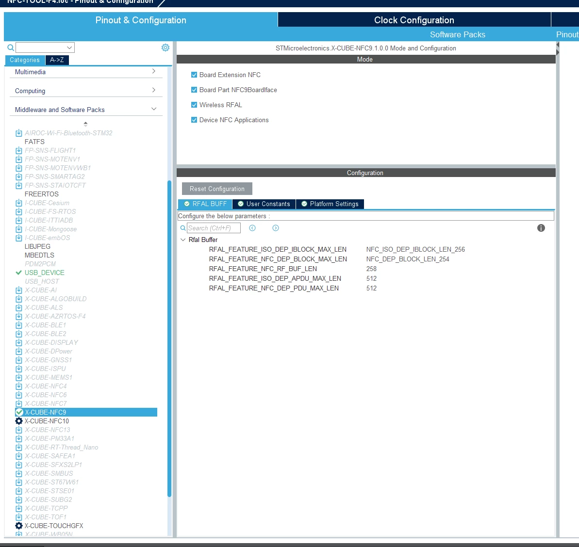

I have a STM32F401RCT connected to a ST25R100.
In the ioc file I enabled the X-CUBE-NFC9 library with all the necesary dependencies.
All the IOs also have pins assigned to them.
Plus Pull ups enabled on the IRQ (open drain) and NFC_Reset.
Currently I have found out that it crashes somewhere after MX_X_CUBE_NFC9_Init();
ret code: 0

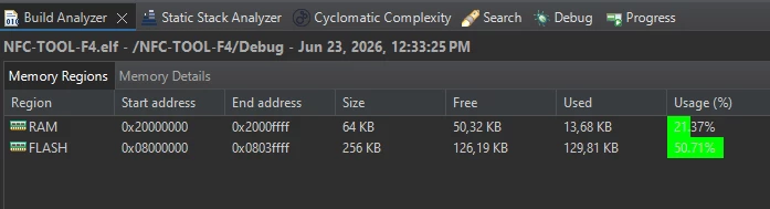

Jun 23, 2026 12:00 UTC
Oh that’s a handy file.
Normally there should be enough space.
Kind regards,
William
