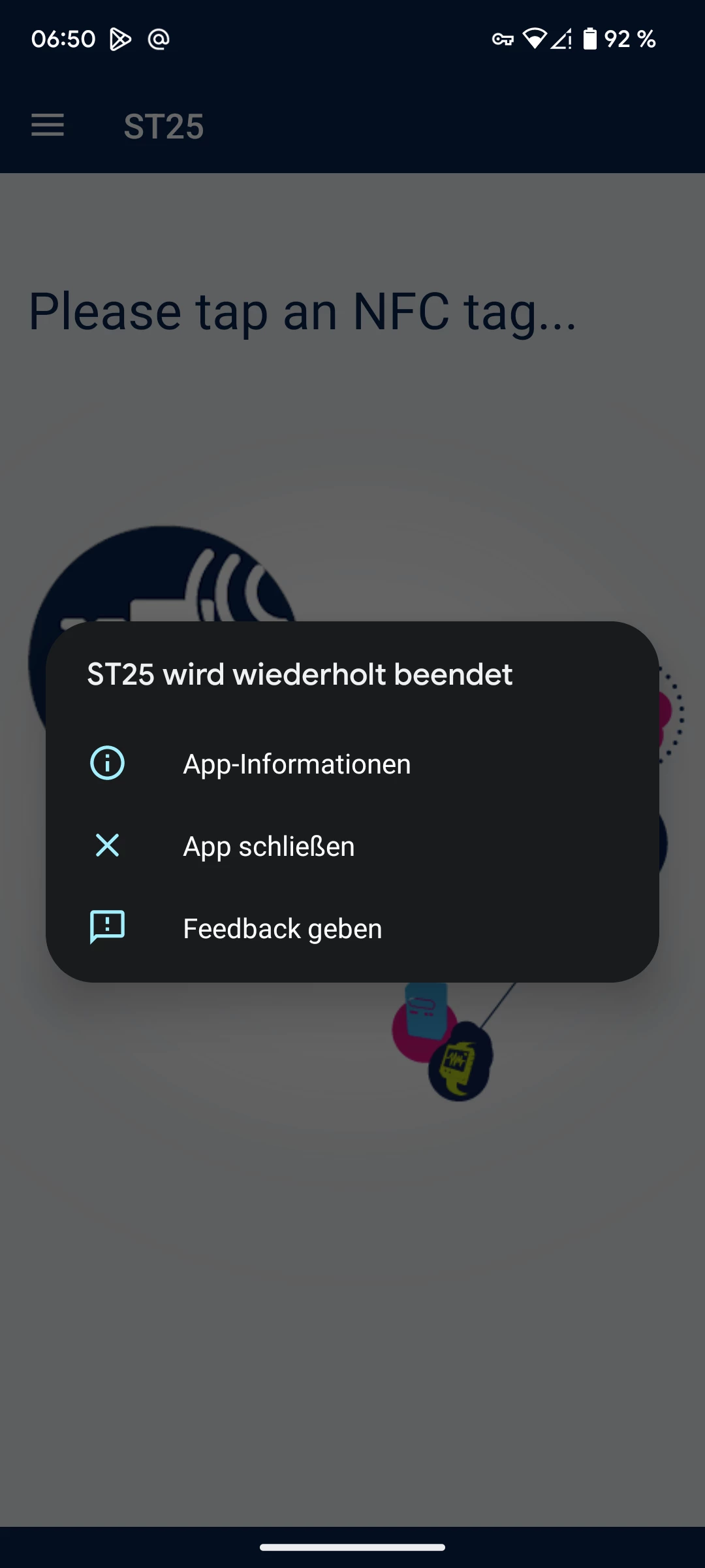

st25nfcApplication_V3.7.0 is crashing on my Pixel6A (Android13) caused by the following source:
E/AndroidRuntime: FATAL EXCEPTION: AsyncTask #1
   Process: com.st.st25nfc.dbg, PID: 1098
   java.lang.RuntimeException: An error occurred while executing doInBackground()
       at android.os.AsyncTask$4.done(AsyncTask.java:415)
       at java.util.concurrent.FutureTask.finishCompletion(FutureTask.java:381)
       at java.util.concurrent.FutureTask.setException(FutureTask.java:250)
       at java.util.concurrent.FutureTask.run(FutureTask.java:269)
       at android.os.AsyncTask$SerialExecutor$1.run(AsyncTask.java:305)
       at java.util.concurrent.ThreadPoolExecutor.runWorker(ThreadPoolExecutor.java:1137)
       at java.util.concurrent.ThreadPoolExecutor$Worker.run(ThreadPoolExecutor.java:637)
       at java.lang.Thread.run(Thread.java:1012)
    Caused by: java.lang.SecurityException: Permission Denial: Tag ( ID: 2E D4 4E 50 00 27 02 E0 ) is out of date
       at android.nfc.Tag.getTagService(Tag.java:381)
Could this be the the reasion: ???
Catch a SecurityException that was introduced in AOSP commit 113f3a4. It is thrown when an NFC tag is removed.
https://github.com/open-keychain/open-keychain/pull/2804
Does anyone have a solution ?

Hi Oliver,
the following steps let me reproduce the issue:
  1. open the ST25NFCTap V3.7.0 APP on my Pixel6A (Android13)
  2. move the phone to a ANT7-T-ST25DV04K Board
  3. "TAG INFO" shows all information as it should, everything works as expected
  4. move phone away from ANT7-T-ST25DV04K.
  5. move phone onto ANT7-T-ST25DV04K again
  6. application crashes (Caused by: java.lang.SecurityException: Permission Denial: Tag ( ID: 2E D4 4E 50 00 27 02 E0 ) is out of date)
I´m not an android expert, but i think they changed something in Android 13:
https://issuetracker.google.com/issues/238257723
This seems the same issue:
https://github.com/android-password-store/Android-Password-Store/issues/2294
We were not able to reproduce this on a OnePlus9 running Android12.
Let me know if you need any further information.
Best Regards,
Stephan

hagbard
hagbardAuthor
March 23, 2023
Hi Oliver,
this is what i get:
0693W00000aJXqXQAW.pngStacktrace is attached.
Best Regards,
Stephan

March 23, 2023
Hi Stephan,
Thank you. I'm going to find a solution.
Till now, it was not a problem if the NFC Tag was moved out of the phone's RF field.
When the tag gets back in the field, we had a Beep, our application was notified and was checking the tag UID. It was seeing that it was still the same tag and we were able to keep using the same object to handle this tag.
It seems that it is no more the case with Android 13. I need to search what should be changed to avoid a re-instanciation of the Tag object.
Regards
Olivier
Olivier L
March 24, 2023
Hi Stephan,
I have implemented a fix. It will be available on Google Play and st.com by end of next week.
Best regards

March 29, 2023
To fix this issue, you will need the latest "Android Reader Interface" (version >= 1.0.9). It can be downloaded from ST25SDK package. This is the file named "st25_android_reader_interface.aar".
Then, in your application, you should find the code processing the Android Intent indicating a new Tag Handle (NfcAdapter.EXTRA_TAG) and you should update the NFCTag object that you are using. This is the lines 35 to 45:
