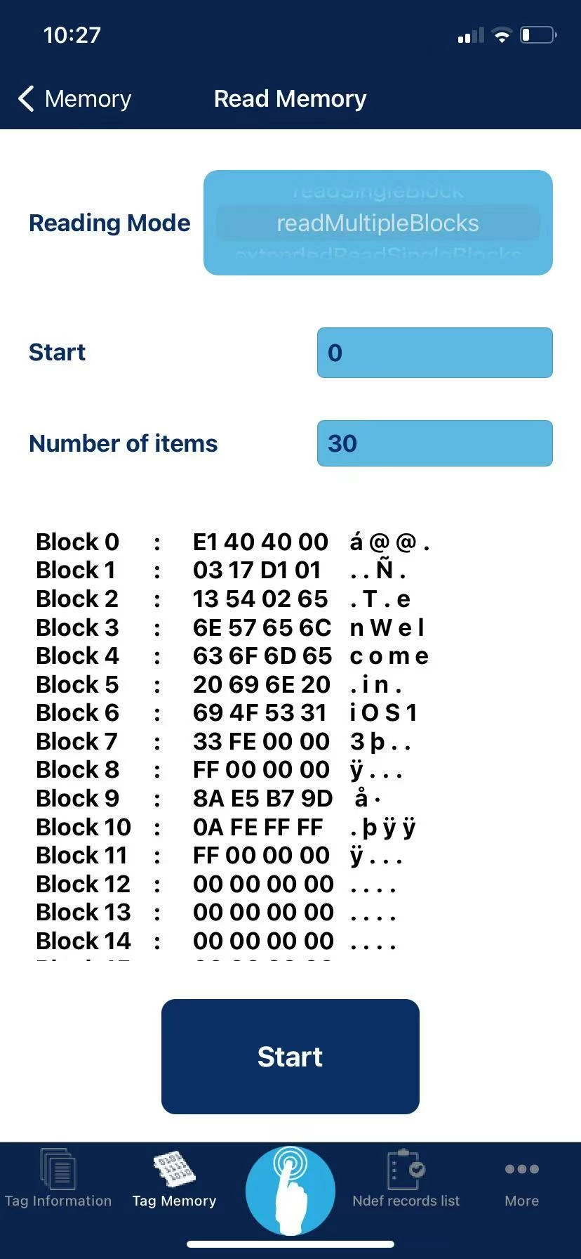

Here is the memory dump of a recognizable tag

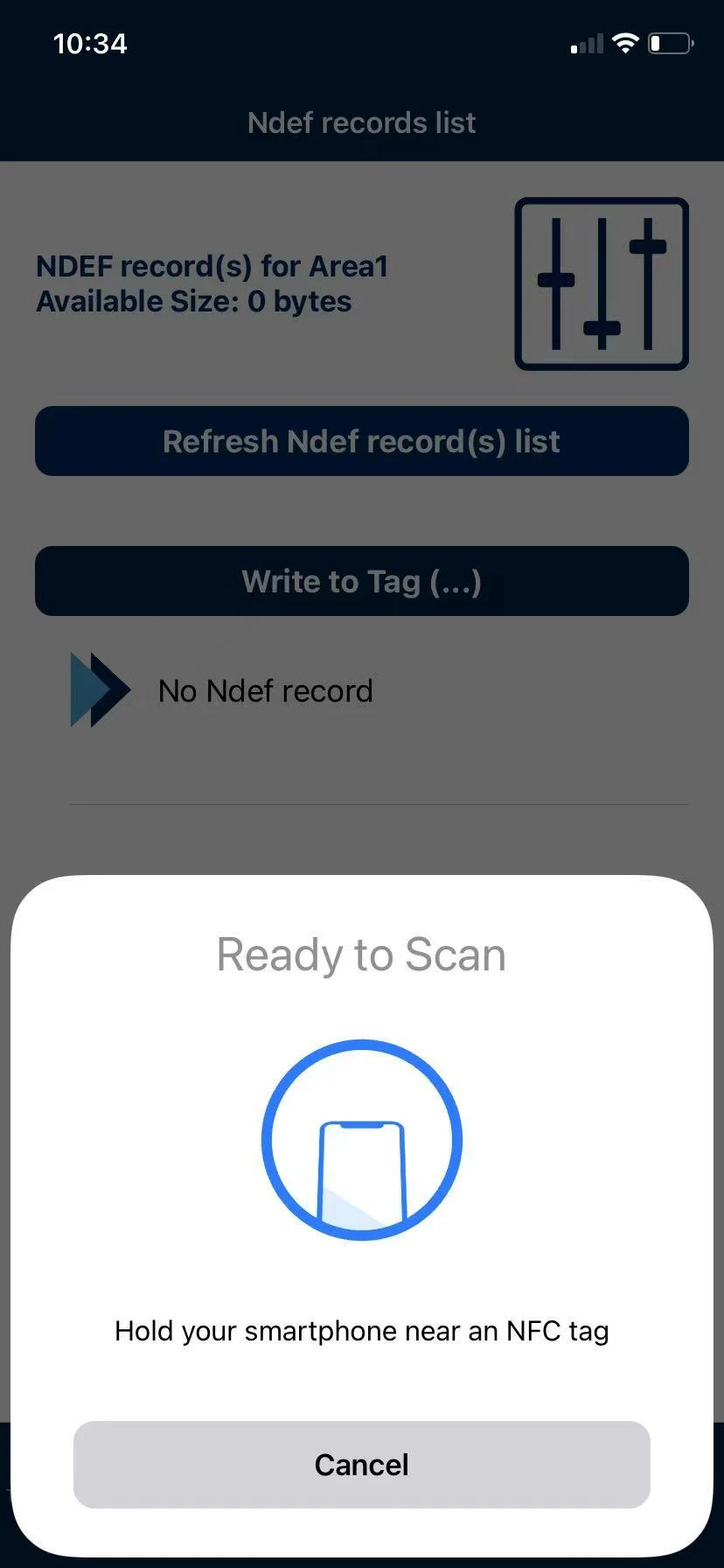

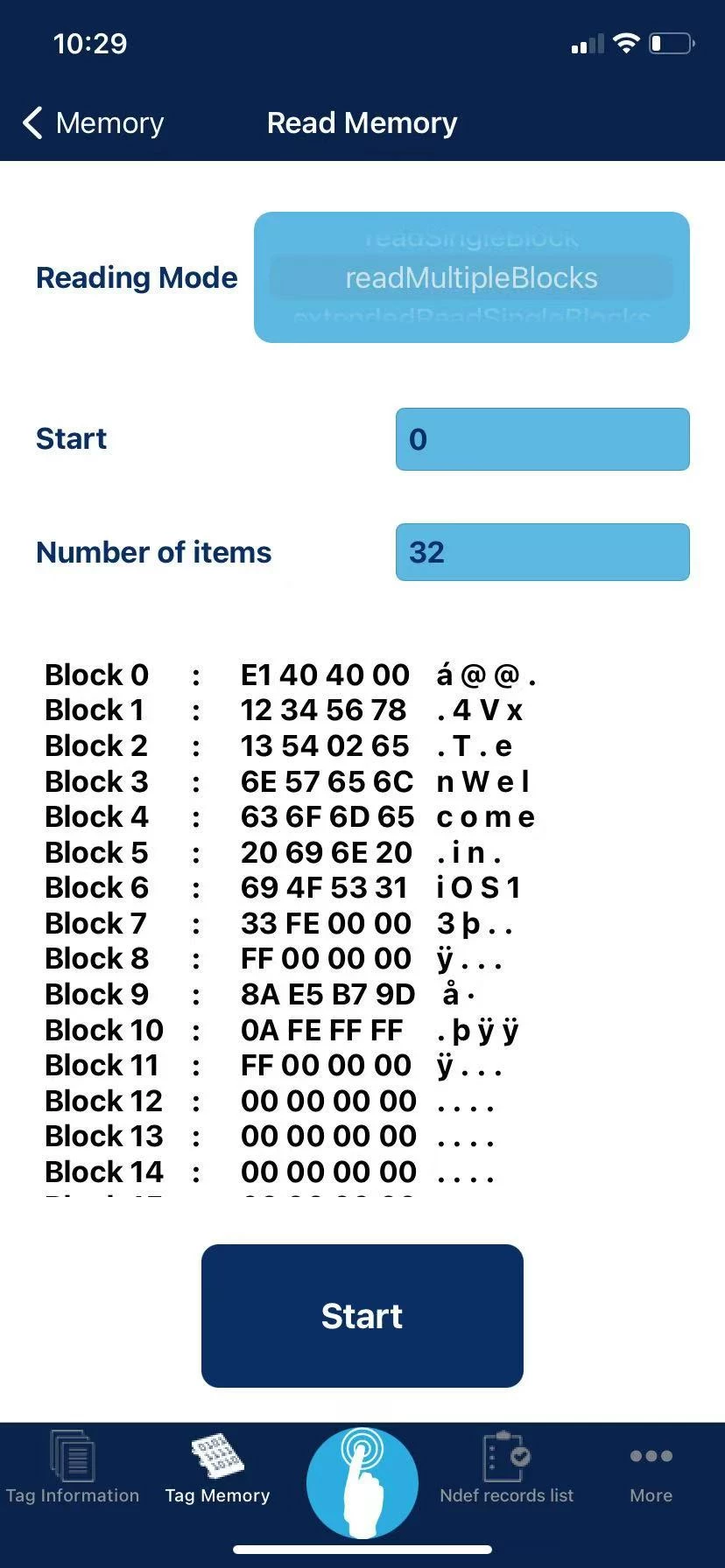

0693W000008xguLQAQ.jpgAnd after I change block 1 to 0x12345678, the tag is no longer recognized as a NDEF tag.
0693W000008xgwCQAQ.jpgTo be specific, the app was searching for the tag indefinitely like below.
0693W000008xgxFQAQ.jpgThe CC file takes only 4byte, so it is fine to write at block 1, I suppose.

I think what you are asking are really specifics of the iOS parsing of NDEF. With writing 0x12345678 you create an invalid NDEF TLV which seems to be denied by iOS.
