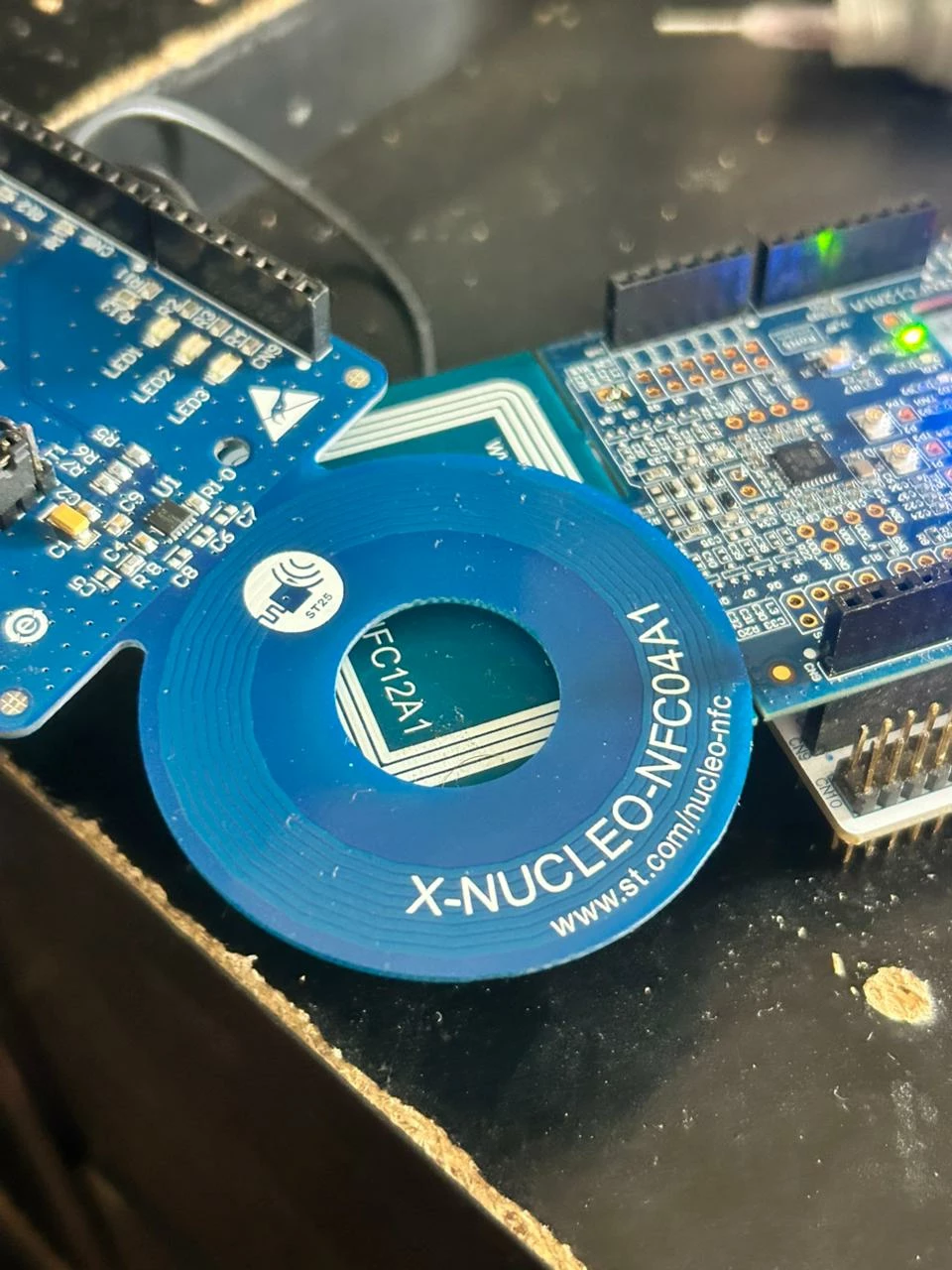

I am working with the X-NUCLEO-NFC04A1 expansion board (based on the ST25DV04K) and I have some questions regarding the Energy Harvesting (EH) capabilities.
My Setup:
Hardware: X-NUCLEO-NFC04A1 connected to a host MCU.

Is it possible to increase the EH current? In addition to optimizing the antenna adjustment and coupling distance, is there any setting in the ST25DV that affects the drive strength of the analog collection block? Or on the reader side, I am using the X-NUCLEO-NFC12A1.
