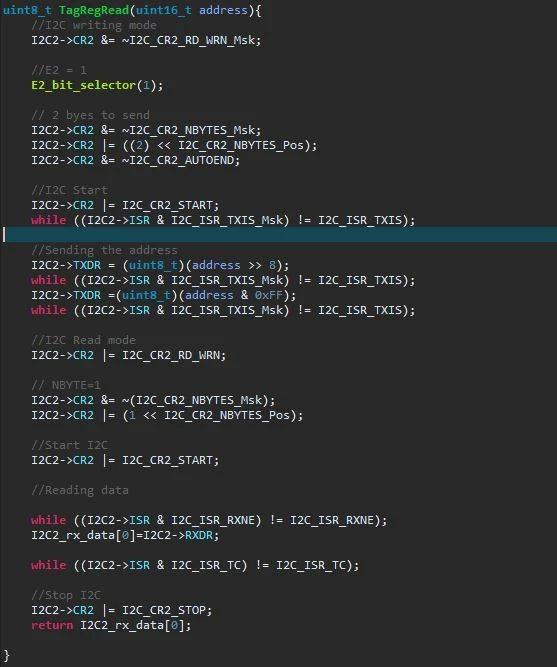

I have an ST25-ANT and I'm trying to make it work on a Nucleo F070RB. When I send the I2C Start there is no problem the device is recognized but then I try to send the MSB of the address and a NACK appears, I don't understand why the ST25DV takes the start condition but nut the register address I'm trying to read .

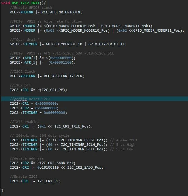

Here is my I2C configuration :
And my read function :
Any help is appreciated, thanks !
    Best answer by CLANC.11
    Hi @Rene Lenerve​
    I found the problem, after sending the register address I was looking at the wrong flag. It's not TXIS but TC for transmission complete so that the device know the address has been sent.
    Best Regards.

    Are you sure of timing values you recorded in the I2C_TIMINGR?
    Using cubeMX and NucleoF070RB board selection I got different value for this register to configure with 48MHz MCU and 100kHz I2C
    -> 0x20303E5D
    Prescaler 2
    SCLDEL 3
    SDADEL 0
    SCLH 3E
    SCLL 5D
    Best Regards.

    Hi @Rene Lenerve​ ,
    Yes, I'm am sure I have tested both configuration on O-scope and they are similar except mine have 50% duty cycle and yours 40%,strangelly my O-scope register a 50kHz frequency instead of 100kHz for both configuration so I tryed with 100 khz but unfortunnatly none of the configuration would work.
    I'm a bit confused by my problem here how come the device address is ACKed but after that I get a NACK on register adress ... I'm starting to think there is something in the NFC part that is blocking I2C communication but I did reset the memory with the ST App so I don't know what it might be.
    Best Regards.
