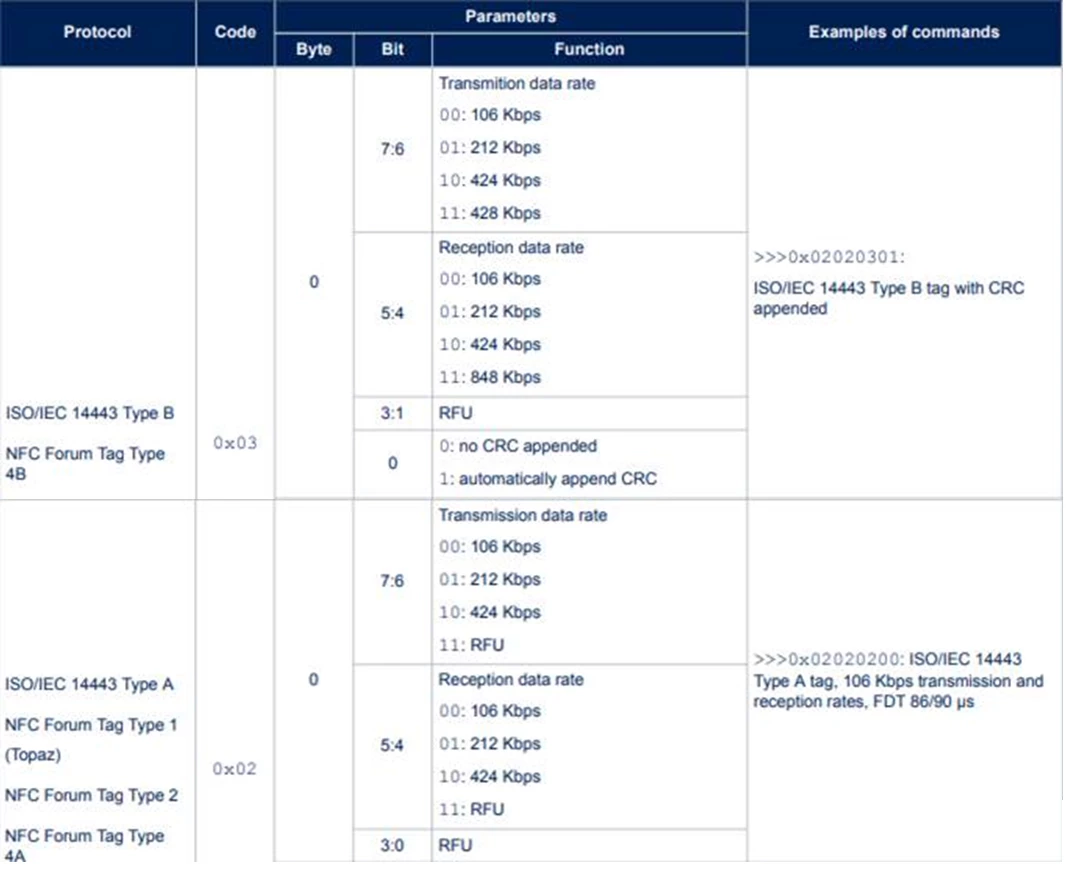

Brian TIDAL
June 10, 2021
Hi Thierry,
the command set (ST25R3911B_PROTOCOL_SELECT) used in the Tag Editor is inherited from the ST25R95. This is then translated to internal ST25R3916 commands. Thus the documentation is inside the ST25R95 Datasheet §5.4 for protocolSelect parameters.
The PPS message can be send through the ISO14443-A Card Command tab of the Tag editor. Click on "One Tag Anticollision & Selection process" button, then RATS, then PPS button.
The PPS button basically sends the D0 11 00 PPS command:
06-10-2021 17:01:54	ISO14443-A RATS
			>>> ST25R3911B_SENDRECEIVE, E08028
			<<< 800A0575806002BB58080000
06-10-2021 17:01:55	ISO14443-A PPS
			>>> ST25R3911B_SENDRECEIVE, D0110028
The bit rate selection in PPS is done through the PPS1 byte (see ISO/IEC 14443-4 §5.3.3). After the PPS transceive, the bit rate should be updated with protocolSelect.
Note PPS is a T4AT command. For T4BT tags, the bit rate selection is done through param2 of the ATTRIB. See ISO/IEC 14443-3 § 7.10).
Rgds
BT
