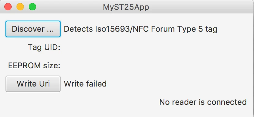

    Amir Ben Ari
    Apr 30, 2018 7:37 AM UTC
    Posted on April 30, 2018 at 09:37
    Sorry, forgot to mention that I'm using SDK version 1.1.0.
    There's no Help => About when running the ST25 example Java app, but its the same one that comes with the 1.1.0 SDK version
    Amir Ben Ari
    Apr 30, 2018 7:39 AM UTC
    Posted on April 30, 2018 at 09:39
    I've run the examples Java app.
    Status of ''No reader is connected'' does not change even though Reader is attached.

    victor laraison
    May 2, 2018 3:10 PM UTC
    Posted on May 02, 2018 at 17:10
    OK thx Amir.
    Best thing would be to send me your whole environment if possible.
    Normally, st25R3911 is not supported yet in Linux and MacOS as libraries don't exist for Linux. I don't understand how it could be identified as CR95HF.
    If you have got an CR95HF, it would be nice to make some tests again, then to le me know status.
    Thx and br,
    Vincent
