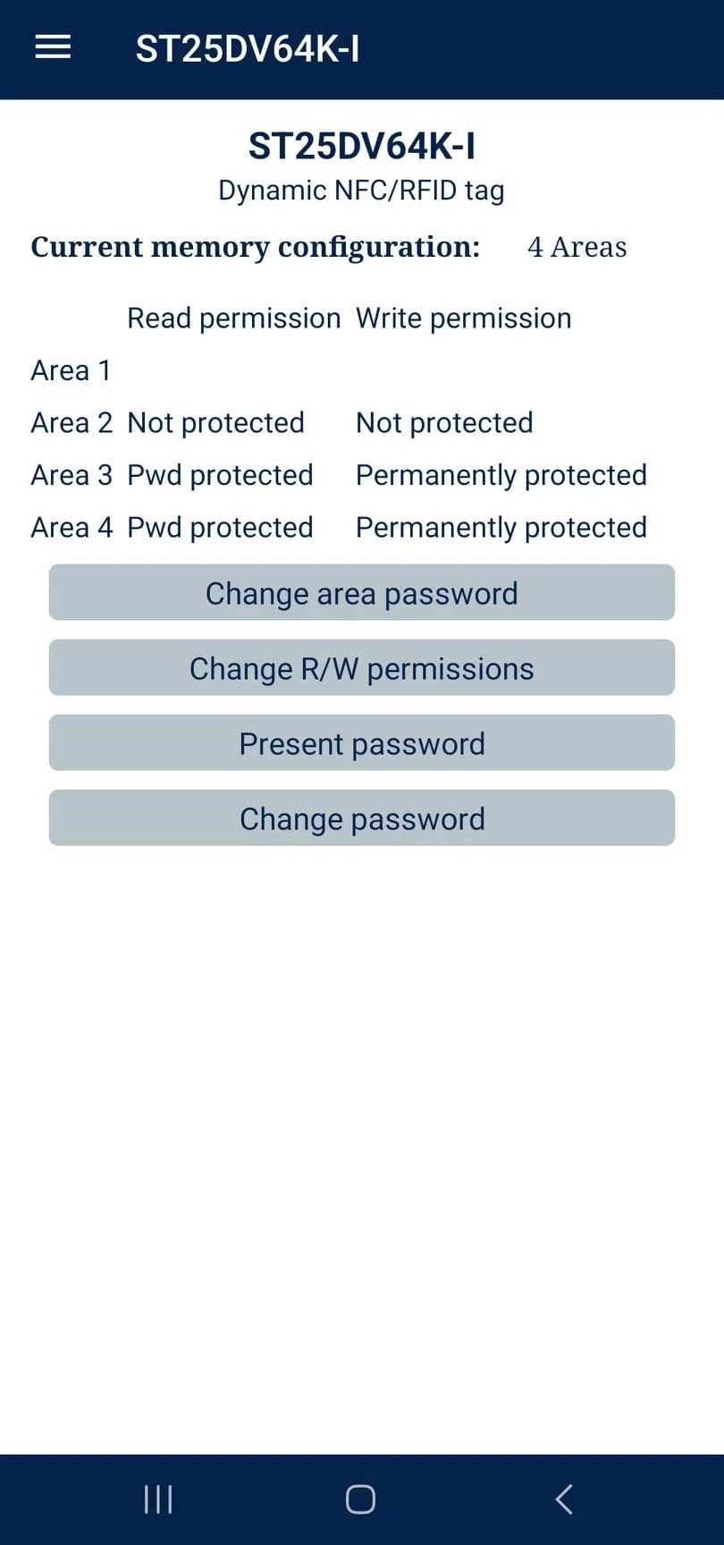

    The screenshot you've requested is attached below:
    The phones that work regardless of Android version are various Samsung S21, Samsung A52, Samsung S22, Redmi 9, Huawei P20 and old P8 lite.
    We cannot read the tag with Android 12 and Nokia 5.4, Motorola g60s and Moto Edge 20 Lite.

    I can see on the picture that the status of Area 1 is blank, which is not expected. Something went wrong somewhere...
    Please give the size of each area.
    When using the "Dump memory to file" tool, it is by default configured for the total number of bytes of the tag (8192 in your case). This will create a failure when the application will try to read the areas protected in read by password.
    So please change the field "Number of bytes". Use the size of Area 1. By this way, we will see the beginning of the memory (containing the CCFile and the NDEF present in Area 1).
    Values taken from the ST25 app: Area 1 - 512 bytes, Area 2 - 256, Area 3 - 1792, Area 4 - 5632.
    The ST25 app is able to dump up to 768 bytes (two first areas). Area 1 is filled with zeroes. The first non-zero value appears at 516.
