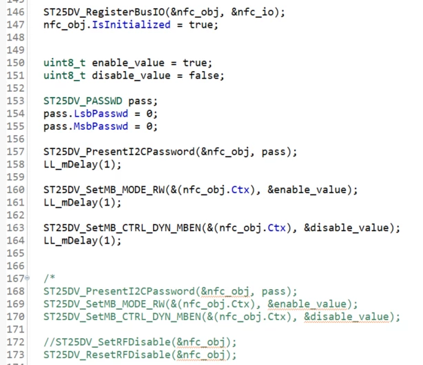

I have a really weird behaviour for my chip which I can't really figure out. Basically, I am using only the commands from the ST25DV library (st25dv discovery board).
After 2 function calls (for example present password and disable RF) the subsequent calls get all not acknowledged.
If I reverse the order of the instructions then those instructions will get executed correctly and the other ones won't.
Could someone provide a hint on what could go wrong?

Hi @robertp,
Can you share some of your code that you are using to help reproduce this bad behavior. You will also find some examples around RF Off or RF Sleep in the ST25DV-DISCOVERY software package which may help you in using these functions.

I would be glad to share my code:
Perhaps I should mention that I've been wrapping the SD25DV calls with my own I2C LL implementation. However, I didn't have different results with the HAL implementation either, and regarding the protocol the data on the wires seems to be alright.
I am suspecting I am using the User Layer of the ST25DV in a wrong way. Can you confirm that ?

Hi @robertp,
First comment, could you please use code sample tag for the shared code it will ease the exchange.
Second comment, be careful converting boolean to integer, false and true could be defined as
#define false 0
#define true !false
and in that case !0 isn't 1.
For ISO C99 defined value of false and true are 0 and 1 (but in certain environment it could be something else)
Third comment, I'm sure you're doing correctly but in your capture ResetRFDisable is commented due to a missing comment tag */
From what you've shared I don't see anything wrong, be careful to have correctly set nfc_io structure for
ST25DV_RegisterBusIO
 nfc_io.Init = BSP_I2C2_Init; //to adapt in your case
 nfc_io.DeInit = BSP_I2C2_DeInit;
 nfc_io.IsReady = BSP_I2C2_IsReady;
 nfc_io.Read = BSP_I2C2_ReadReg16;
 nfc_io.Write = (ST25DV_Write_Func)BSP_I2C2_WriteReg16;
 nfc_io.GetTick = BSP_GetTick;
Do you have also this issue when you compile and run the ST25DV-DISCOVERY demo?
If you still have the issue, maybe you could share more of your project to determine where the issue is.

Regarding the demo project for the Discovery Board, I had problems finding a working example that will just work straight away after I import the project in the STM32CubeIDE. Perhaps you could provide a project that is intended to work for the CubeIDE and only the CubeIDE- doesn't have to be the same as the demo project, a simplified sequence of commands would suffice. And it would be perfect if it could be using the LL drivers.
Maybe it would be a good starting point if you could provide this minimal working example that just executes a sequence of commands, as I have no clue what to watch next in order to find the problem.

I'm so sorry, but unfortunately your example project still doesn't provide the solution. After the first commands the next ones still don't get acknowledged. I have currently no clue what else to try. However, I am currently away for 2 more weeks because I'm learning for an exam. I will need to try something else. As far as I remember the original demo application worked as intended (thus using the HAL). I tried replacing the wrapper functions to point to the HAL implementation instead some time ago, but still without success. I will try using the HAL functions again, perhaps I accidentaly did something wrong.
However, I wonder why the problem would occur with the LL drivers.

on my side I didn't encountered any issue using this project on a ST25DV-DISCOVERY.
It might be useful if you could spy the I²C bus or capture with a scope SCL and SDA signals, to try to understand why the tag "NACK" commands.
