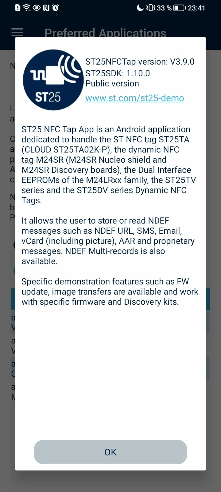

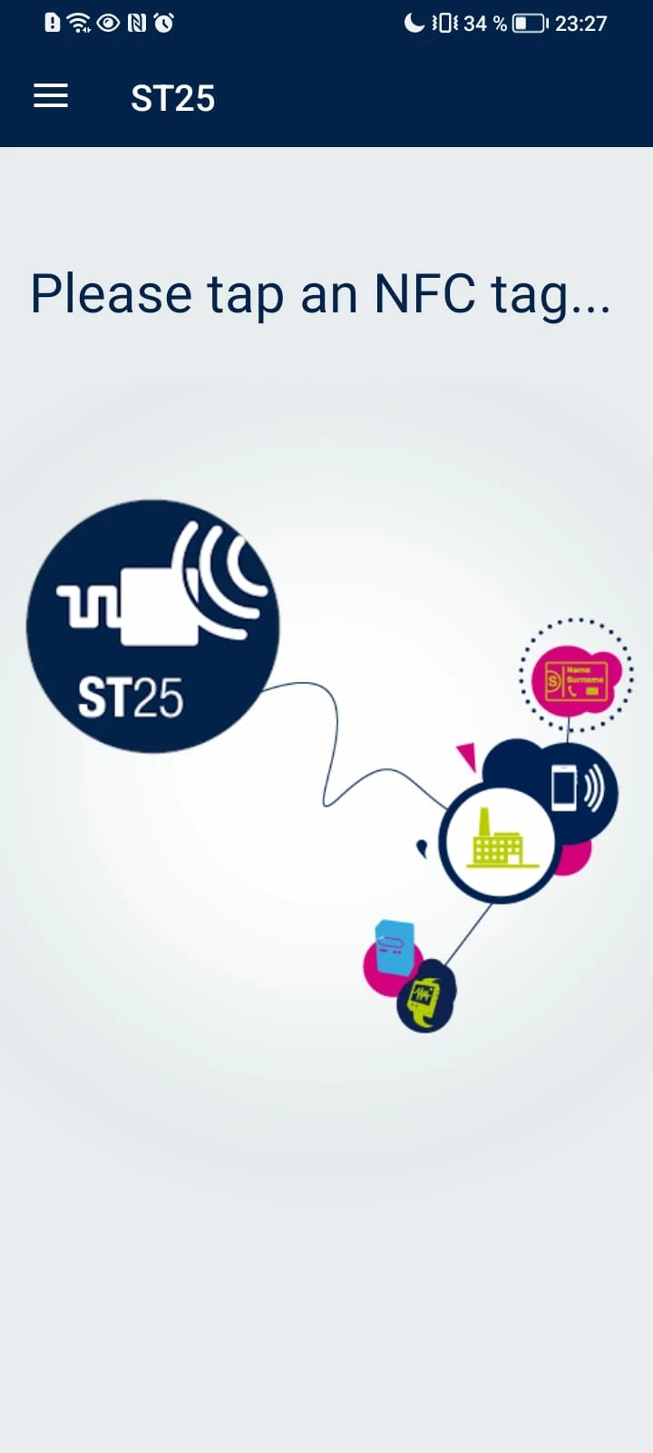

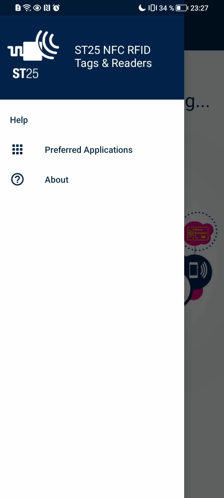

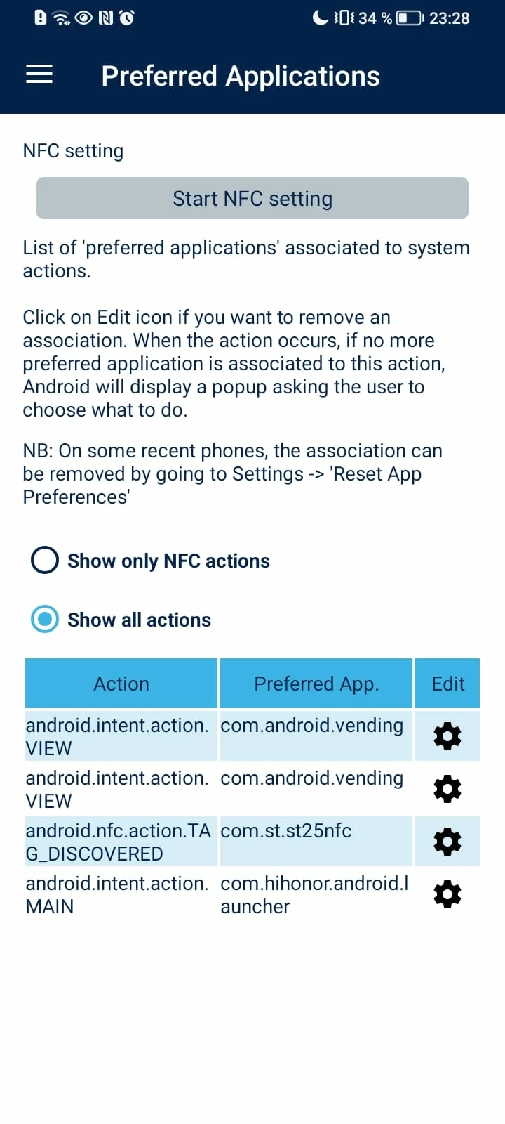

I meant that the app doesn't react at all to the NFC tag.
Where can I find Read memory in the ST25 NFC Tap app? I have the 3.9.0 version on Android 12.
I only have those pages on the app:

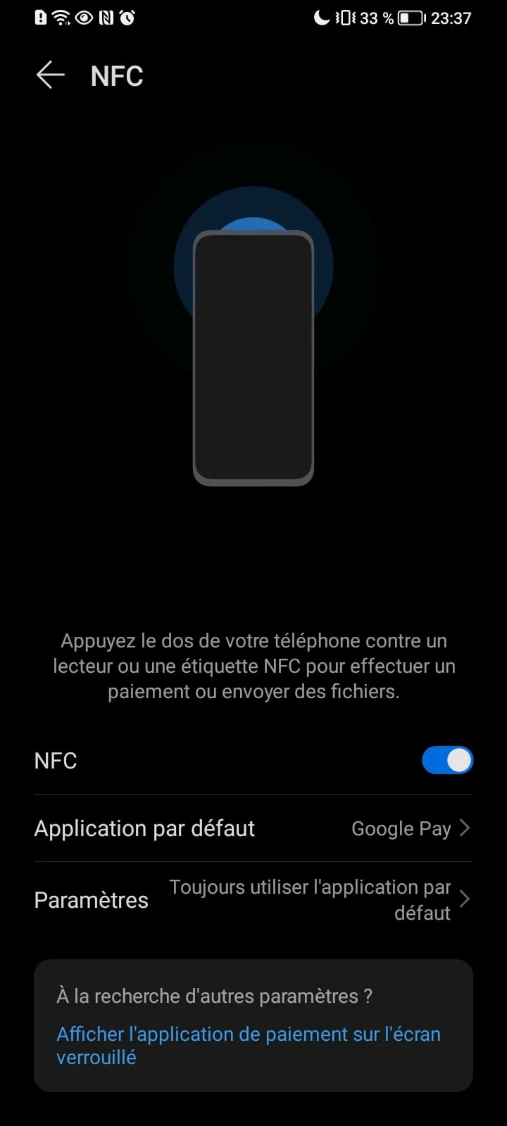

Clicking on Start NFC setting:

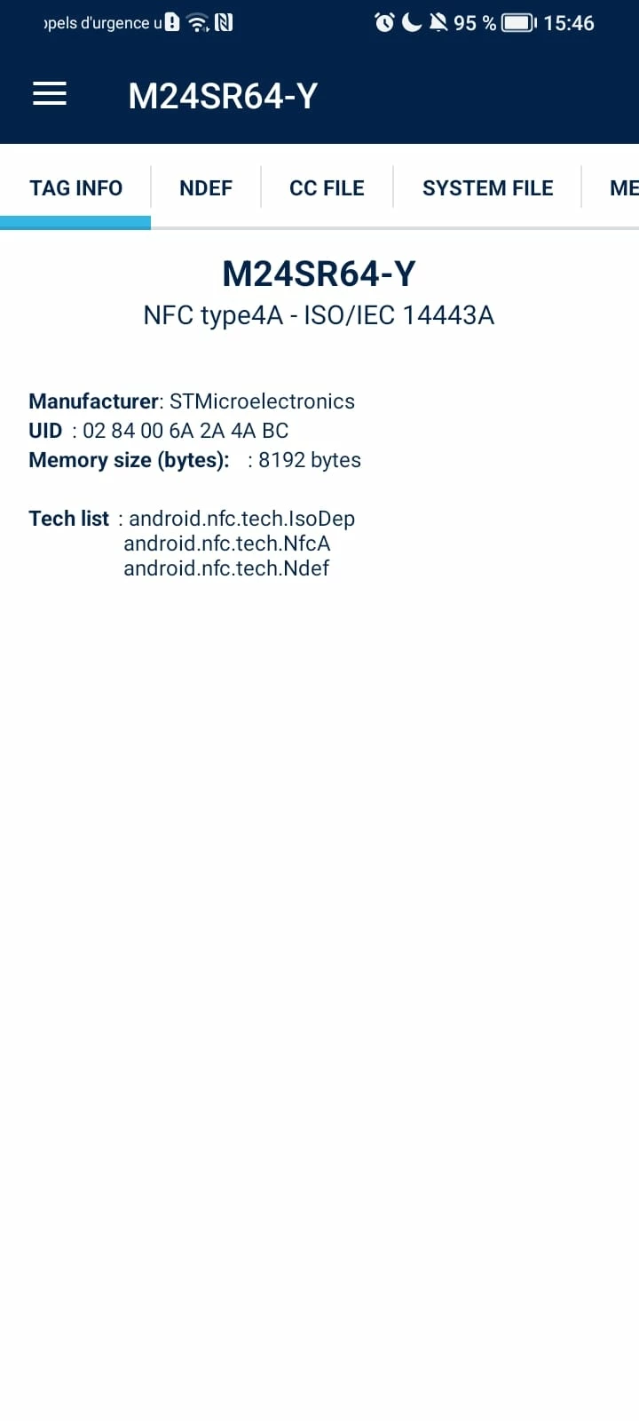

Hello Brian,
I was able to make it work :
The problem was linked to the configuration of the scripts: GPO function and I2C_GPO_INTERRUPT_ALLOWED parameter.
I wasn't using the GPO function to define in main.c from the example which configures the PINs A6 and A7 :

I changed the .ioc file from the CubeIDE project I changed the PA6 and PA7 from Reset_State to GPIO_Output. I don't know if it's relevant since I don't use the generated function MX_GPIO_Init(). Is it?
And TT4_Init() wasn't working because of an unsupported parameter. I found out that I2C_GPO_INTERRUPT_ALLOWED from drv_I2C_M24SR.h was set instead of I2C_GPO_SYNCHRO_ALLOWED.
A comment on the side of I2C_GPO_INTERRUPT_ALLOWED says ! NOT SUPPORTED BY MBED !.
Then it worked.
Many parameters have to be changed when using the examples, and it's hard to find them at first.
I add my main.c main.h and stm32f4xx_hal_msp.c to this reply for the next.
