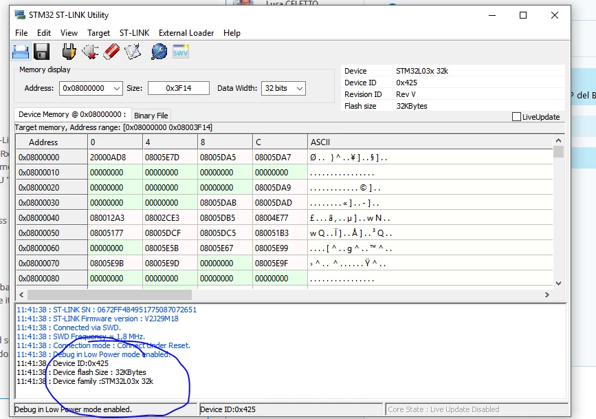

if you connect the SmarTag with ST-link and open the ST-LINk...
Device family: STM32L03x 32k
and so on?
Because if you see L4... because if you don't see it... you are looking the STM32 of the Nucleo Board and not the SensorTile's one.

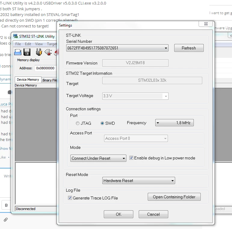

For ST-Link Check also the settings, I'm using:
It's necessary to make the "connect under reset" because we use the Low Power mode for STM32.

Sorry it was missing the image with the setting for ST-LINk.
Sorry , these are the settings:
