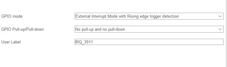

Brian TIDAL
Apr 9, 2021 12:46 PM UTC
as explained in the ST25R3911B datasheet, "When an interrupt condition is met, the source of interrupt bit is set in the Main interrupt register and the IRQ pin transitions to high", therefore make sure to have the following configuration for the GPIO connected to the ST25R3911B IRQ:
0693W000008z715QAA.jpgThen, make sure to have the demoIni() being called only once in /* USER CODE BEGIN 2 */--/* USER CODE END 2 */ section (i.e. it shall ***not*** be in the while (1) loop). and then run the demoCycle() in the  /* USER CODE BEGIN WHILE */ --  /* USER CODE END WHILE */ section. See the reference main.c file.
Once a tag is discovered, its UID is stored in nfcDevice->nfcid and the UID Length is stored in nfcDevice->nfcidLen.
Rgds
BT
RShiv.1
RShiv.1Author
Apr 9, 2021 1:11 PM UTC
Hi BT,
1.Yes our configurations matches with what you have told..demoini is called only once outside while and inside while we are using democycle.
2.But we are seeing interrupt being generated once even without presenting our RFID ,after that when we present RFID we are seeing the INT
.Is there any changes that need to made to these confiurations

Brian TIDAL
Apr 9, 2021 1:26 PM UTC
Hi Ravi,
There is no need to change anything in st25r3911_com.h. Please do not modify it.
There are a lot of interrupt conditions in the ST25R3911B so this is normal to have interrupts even without a tag being present in the field. As explained, the ST25R3911B is an RFID frontend so it signals to the MCU some conditions (such as  oscillator frequency is stable) through interrupt.
Basically, the SPI and the interrupt are functional. You should be able to read a tag. If you do no succeed to read a tag, this means you probably have an antenna issue. This should be checked by your HW engineer.
Rgds
BT
