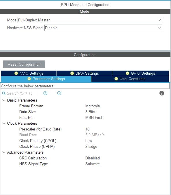

Brian TIDAL
Mar 9, 2021 10:21 AM UTC
Hi Ravi,
the SPI configuration is not correct. In STM32CubeMX, the SPI configuration should be:
0693W000008wNT0QAM.png(make sure to adjust the prescaler value according to your clock frequency to keep the SPI speed under or equal to 6 Mbps)
See also MX_SPI1_Init in the reference project for proper value if you want then to check the generated code.
Rgds
BT
