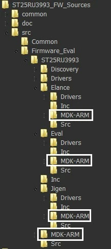

Sources of STM32L4 based firmware for ST25RU3993-EVAL
Hello, Sir
I had download STSW-ST25RU003.zip from ST Website.
After encompress file, I found there are some folder with MDK-ARM of firmware_Eval folder.
May I know what's different these MDK-ARM folders ? and which one is correct for software RD reference?
Is it confused me?
Thank you.

​Hello Jerry,
the MDK-ARM folders located in board directories (i.e. ST25RU3993/Elance/MDK-ARM,  ST25RU3993/Eval/MDK-ARM,  ST25RU3993/Jigen/MDK-ARM) should not be used.
The SW RD reference keil projects are the ones located in ST25RU3993/MDK-ARM.
regards,
Cedric
