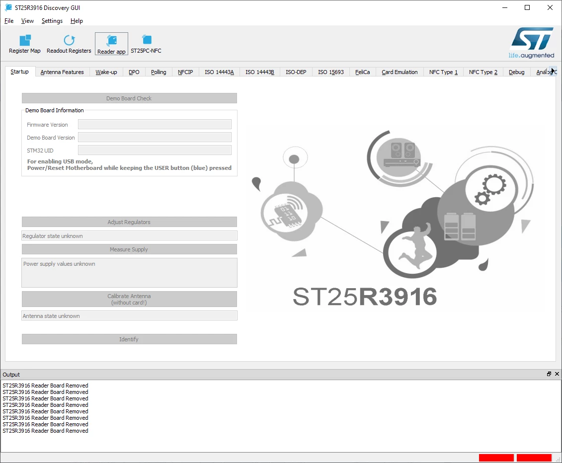

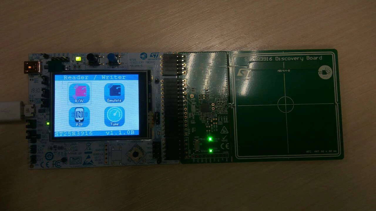

I am use devboard MBI1396-B + MBI1414-B. I need run this board with software GUI (PC).
I cannot do it. I am try to load firmware ST25R3916Demo_MB1414B_v1.1.0.hex. Just demo for LCD.
On program nothing happens.
How to connect and visible
Can anyone explain what is a problem?

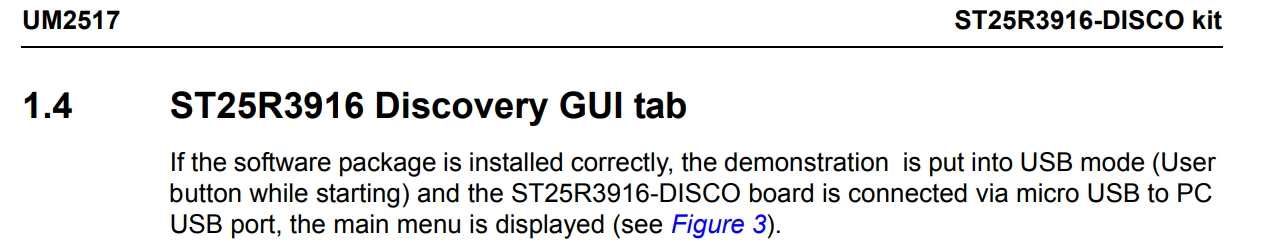

for PC-GUI operation you need to press user-button while booting (This is described in the user manual).
BR, Ulysses

(facepalm)
@Ulysses HERNIOSUS_O​ , Thanks.
