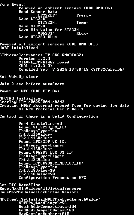

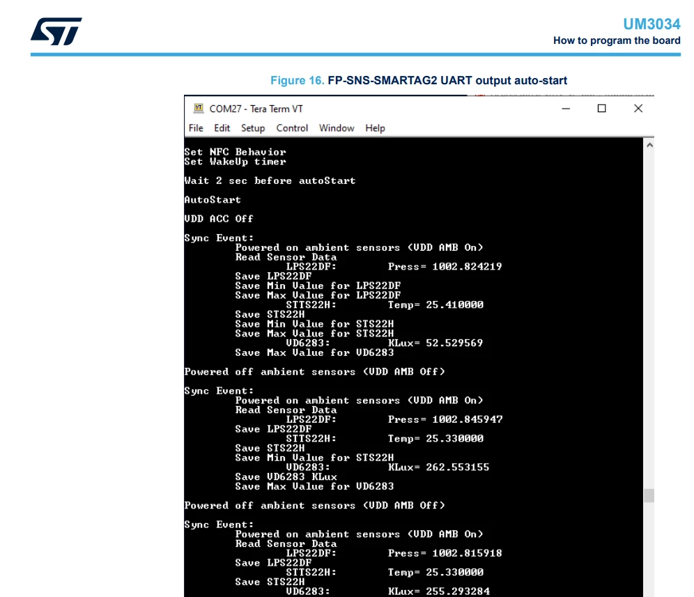

I followed the user manual and loaded the examples as it is, however, I didn't get any sensor data return as expected, any possible reason or steps I may have missed?
This is the user manual expected output
Where as this is my result
Would appreciate if anyone have prior experience can give me some direction.

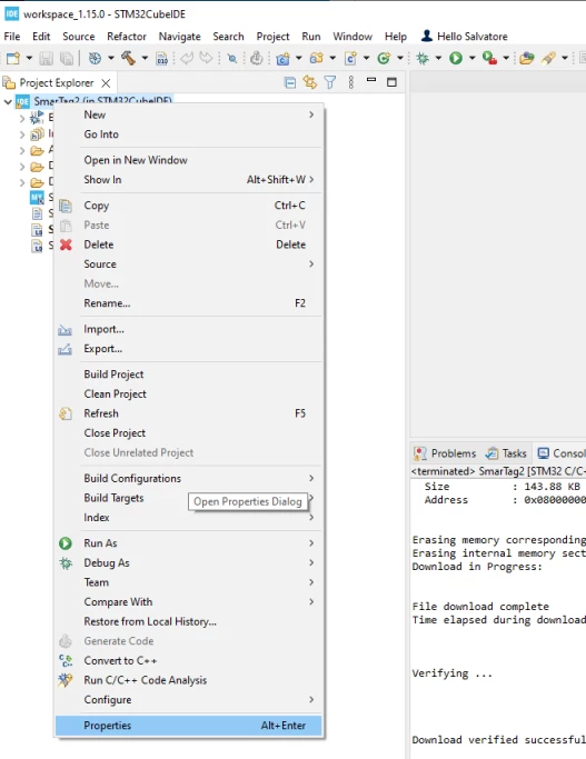

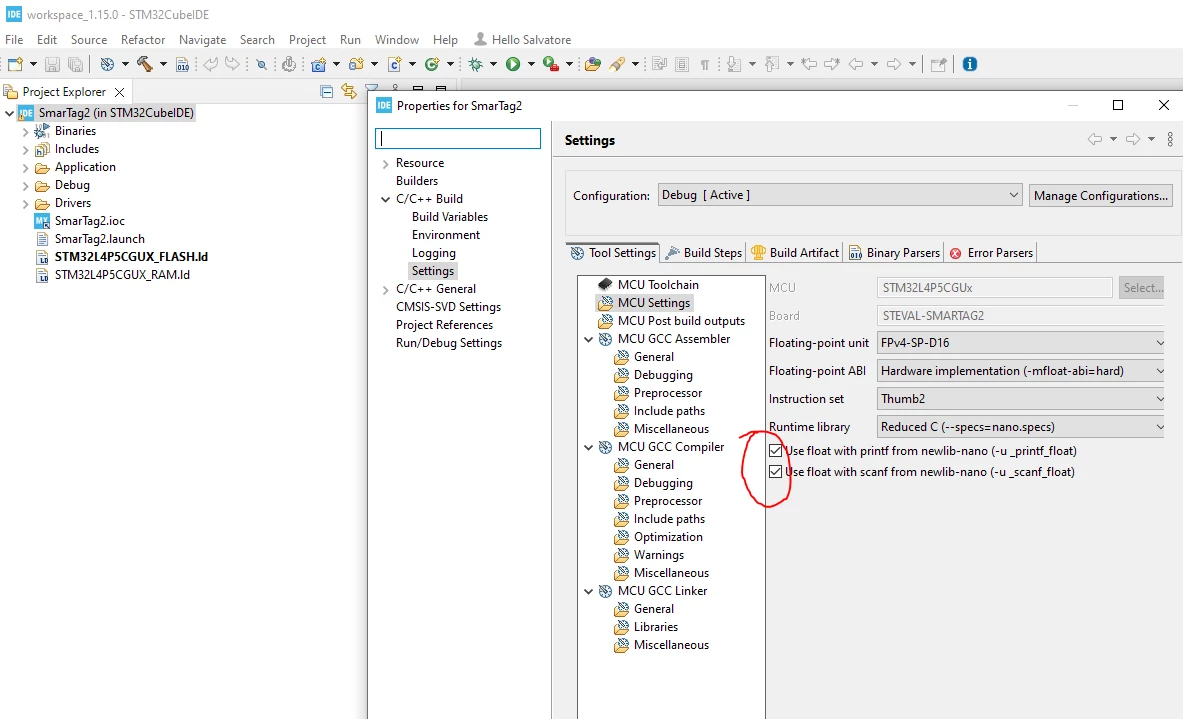

To solve the issue, open the project properties
check the indicated boxes and re-build the code
