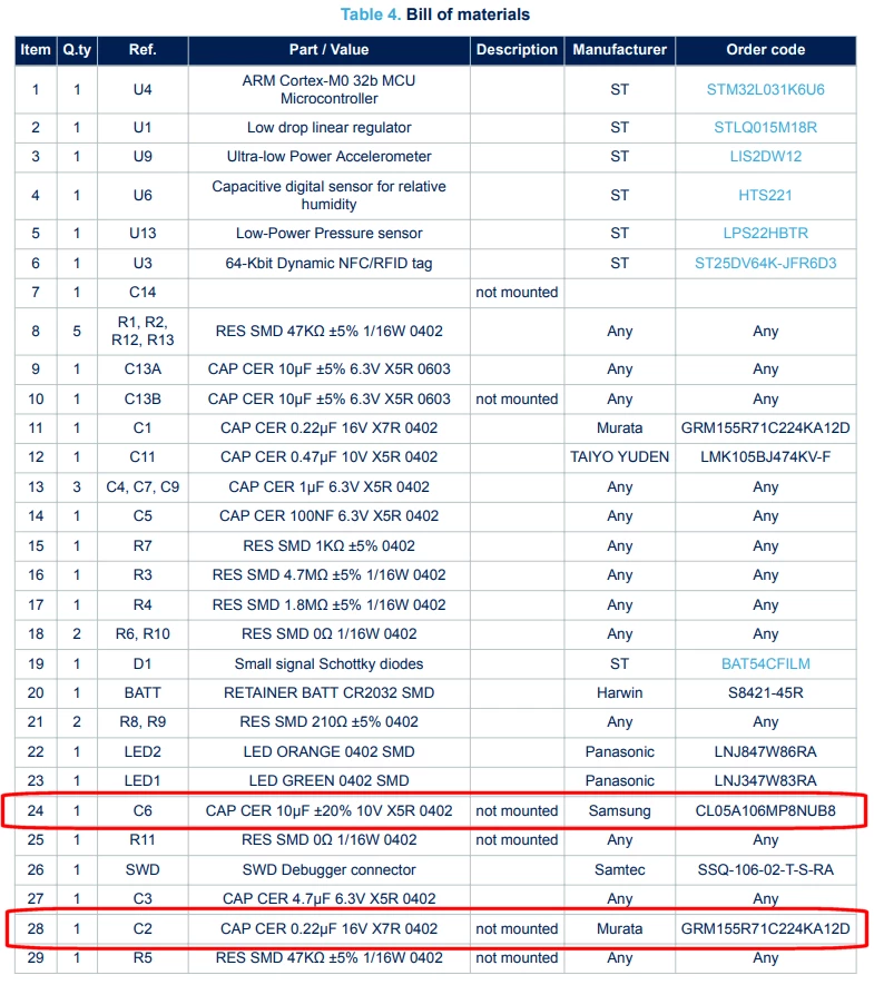

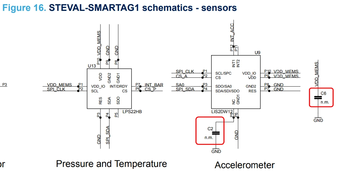

You mean these:
https://www.st.com/resource/en/user_manual/um2427-how-to-use-the-st-nfc-sensor-tag-evaluation-board-stmicroelectronics.pdf#page=25
Indeed, it is stated in the Bill of Materials that these are not mounted:
@isaacseeto wrote:
 what purpose do these components serve if populated?
Presumably to accommodate different variants/revisions of the board;  eg, using a different accelerometer?
