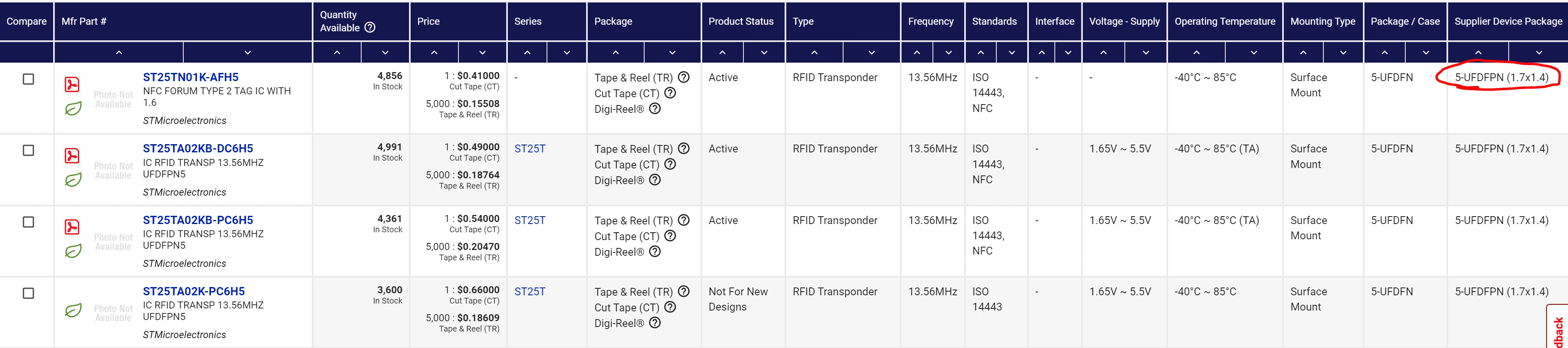

I have a jewelry brand and i´ve been thinking about making smart jewelry with NFC technology. I found a 5x5mm NFC chip but it´s still too big for fine jewelry; i read somewhere in a forum that i can find here the smallest NFC chip (2x3mm), does that chip exist (I think is in the ST25T series)? or which one do you recommend for that purpose?.
Thank you in advance.

Most distributors have a parametric search. Digikey shows a 1.7x1.4mm chip in the ST25 series. I'd look through datasheets there to make your selection based on your project requirements.

@Herrkratos You should also consider that NFC technology is based on radio transmission. In addition to the NFC chip, you also need an antenna connected to the chip (wire coil, circuit board tracks, or similar). If you glue this antenna onto metal or even embed it in metal in any way, you will not enjoy successful NFC communication (see also Faraday cage).
However, NFC could work well with non-metallic jewellery that does not act like the aforementioned Faraday cage.
Good luck!
