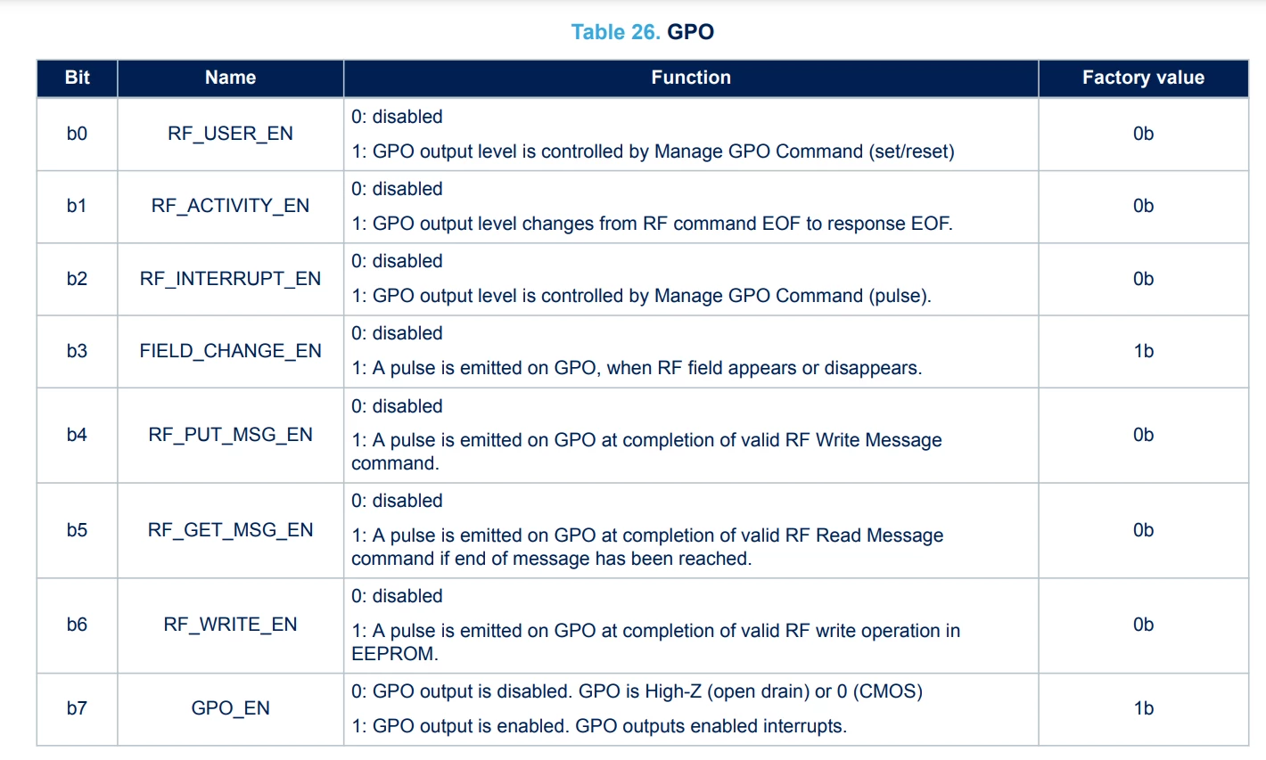

    Not easy to get same context, but here a possible reason:
    On receiving the Manage GPO command. Depending on the command argument, the ST25DV force the GPO output level if RF_USER interrupt is enabled, or send a pulse on GPO output if RF_INTERRUPT is enabled. If neither RF_USER nor RF_INTERRUPT was enabled, the command is not executed and ST25DVxxx responds an Error code “0F�? ...
    here after some tests:
    2023-05-10 09:45:11.358 21531-21642 Iso15693Protocol    com.st.st25nfc.dbg          D ==> Send custom_cmd command: 22 a9 02 09 0e 66 02 00 24 02 e0 01
    2023-05-10 09:45:11.368 21531-21642 Iso15693Protocol    com.st.st25nfc.dbg          D Response: 00

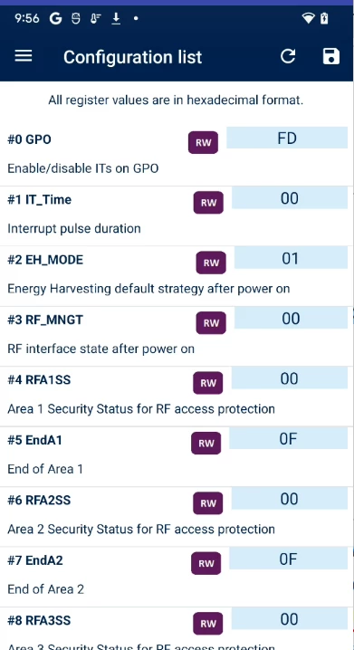

    Registers:
    _legacyfs_online_stmicro_images_0693W00000bjlNoQAI.pngPlease check that :
    bits b0 RF_USER_EN=1 and b7 GPO_EN=1
    _legacyfs_online_stmicro_images_0693W00000bjlONQAY.pngConcerning behaviors on mobiles, no ideas at this stage
    Best regards, FB
