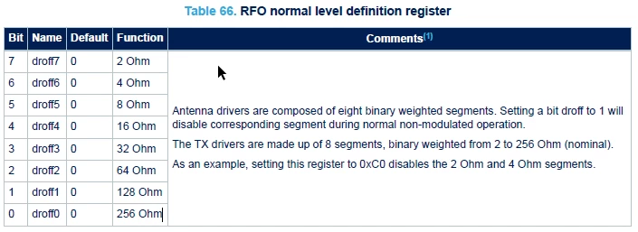

Hi! Ulysses,
I could not realy understand the meaning of table 66 on the data sheet.
It seems we could have different setting for this regeister' value.
Thank you.

Hi Albert,
I assume you talk about table 66 in DS of ST25R3911B which has the binary weighted segments:
0693W00000QNC5XQAX.pngAs an example setting 5Fh means droff 5=0 and droff7=0. Adding these two parallel resistor segments gives 1/2+1/8 = 5/8 => 1.6ohm output resistance. Actual resistance value can be calculated by multiplying with actual RRFO (see table 101).

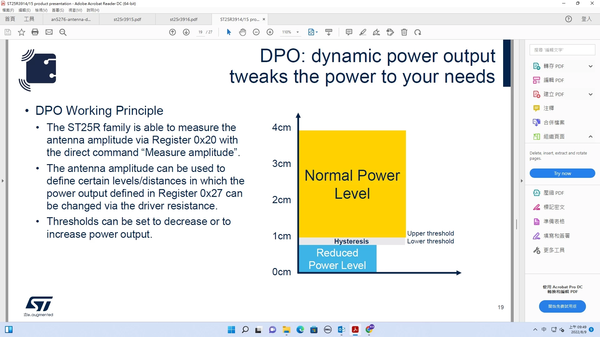

Hi! Ulysses,
Thank you for your kind response.
I also find some interested material as the following picture.
It looks we could get above 3 cm range by certain setting.
Now our project uses ST25R3915 chip. Would you please give me some hints to extend the range?

Hi Albert,
DPO has one main use case: Avoid exceeding Hmax when a PICC/card is in close proximity to be able to pass relevant standards. Another minor side effect is saving some power when a card is in close proximity.
As discussed in above thread there are various components contributing to the experienced read range. From an overall system perspective there are even more which are related to the reader and the tag, their antennas and their coupling.
Typically there are no settings in our chips to increase a read range. You are reporting 3cm: With which reader board with which tag? Is it your own antenna? How did you match it?
Are you aware of AN4974 which describes the process of antenna matching?
With our demo boards you should be able to get much more than 3cm. E.g. ST25R3911B-DISCO + ID1 ST25TA64K I get something like 10cm. With NFC-V I expect even more.
