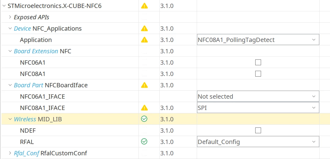

Brian TIDAL
August 1, 2025
that should work: just unselect the various X-CUBE-NFC6 components in in Software Pack > Select components. .  Then you may have to manually clean up the project file to remove references to the RFAL source files.

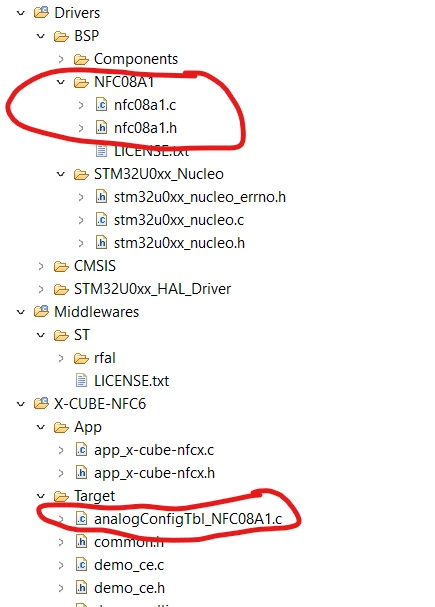

    I thought rfal lib is needed anyway to use st25r3916b driver, not only when using nfc081 ?
    My expectation is that I only need to remove that code encircled in the snapshot(meaning to uncheck only the nfc extension board support). Will look at it

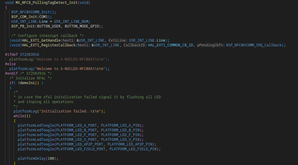

Piggybacking off this topic, since the thread mentioned in the OP is locked now (and this is related to the same project as @Mihai's).

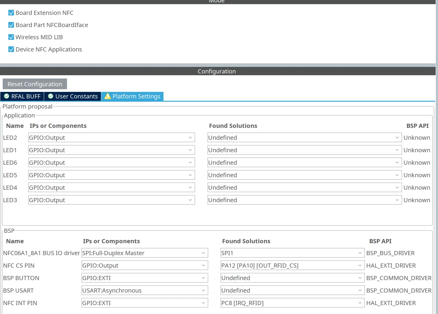

Using the same NFC08A1, I'm trying to generate code without the LED and UART COM dependencies, but it seems code generation fails on nfc_conf.h.
To be clear, I previously started from this config:
I cannot use this config, since other than the pins set under "Found Solutions", I have no free pins to assign to the LEDs. Moreover, I've defined my own logger, and I am using the Virtual COM from the BSP -> Human Machine Interface, which occupies USART2. Due to other config options, only USART1 is available, which is used for a different component.

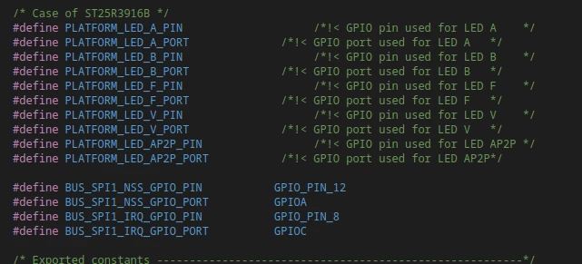

Leaving the pins as "undefined" causes CubeMX to generate code that does not compile, because the #define's for the various LEDs are left incomplete:
These are the pins used here:
Moreover, you can see the generated code uses BSP_COM_INIT(COM1), which is undefined, since no UART option is given to the X-CUBE-NFC6 config.

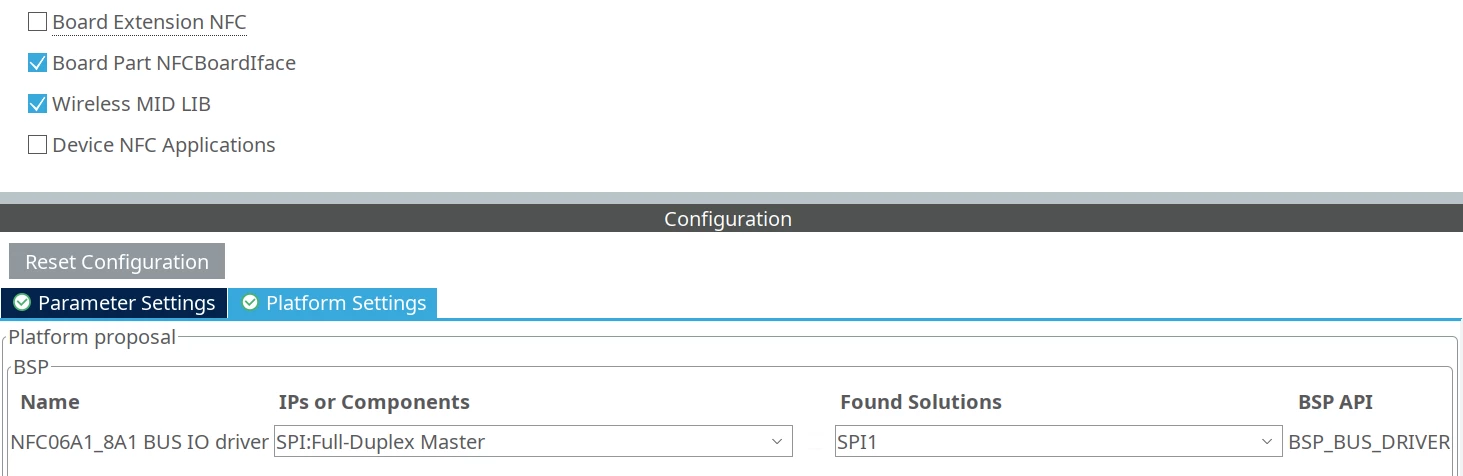

I've tried moving to a config that only uses SPI and RFAL (which I assume is enabled by the "Wireless MID LIB" option?):
But this causes the generation to fail for nfc_conf.h (fails silently, CubeMX itself reports no error):

Brian TIDAL
August 4, 2025
Hi @Mihaita Ivascu,
I apologize for completely misunderstanding your initial question.
Since you have your own hardware and NFC application, the X-CUBE-NFC6 configuration should be as follows:
  • Uncheck Board Extension NFC to remove nfc08a1.c/h.
  • Uncheck Device NFC Application to remove the default polling application.
In this case, your application must explicitly call the initialization functions. For the SPI, the functions are available in custom_bus.c or stm32u0xx_nucleo_bus.c if your IOC is based on a NUCLEO-U083RC. Simply call SPI1_MspInit() followed by MX_SPI1_Init().
I recommend using ST firmware rather than third-party solutions.
