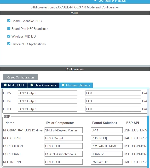

yeji_jangAuthor
Jul 3, 2025 1:07 PM UTC
Hi @BT_it,
Thank you very much for your kind and detailed response — it has been incredibly helpful for someone like me who is just starting with STM32 and NFC development.
I carefully followed your suggestions and made the following changes:
  1. I enabled the "Device NFC Application" in STM32CubeMX.
  2. I configured SPI and EXTI interrupt settings correctly, and I also confirmed that the ST25R3916 IRQ pin is now connected to PA0 as advised.
  3. However, I’m currently facing an issue where rfalInitialize() doesn’t seem to execute properly.
    I suspect it may be related to a missing header file — although the rfalInitialize() function is defined (in rfal_rfst25r3916.c), I couldn’t find a corresponding .h file that declares it properly. This might be why the compiler doesn't fully recognize the function, even though no warning appears when I call it.
As a result, I believe that rfalFieldOnAndStartGT() isn’t being triggered either, and the RF field never gets turned on.
  1. I also defined the ST25R_SELFTEST compilation flag, but I’m not quite sure how to correctly use or verify it.
    Could you please explain how this flag is meant to help with SPI communication and interrupt handling checks?
  2. Finally, I have updated to the latest version of STM32CubeMX, as you suggested.
I’ve been trying to troubleshoot this all day, but I’m still not sure what’s going wrong.
I would deeply appreciate your guidance on what to check or fix next.
Thank you again for your patience and support.
Best regards,
Yeji

Brian TIDAL
Jul 3, 2025 1:38 PM UTC
Hi Yeji,
The prototypes for rfalInitialize and rfalFieldOnAndStartGT are declared in rfal_rf.h.
ST25R_SELFTEST enables extra code in st25r3916Initialize():
  • It writes and reads back a register to check the SPI communication.
  • It triggers an interrupt from the ST25R3916B reader device to check the IRQ handling.
You can set a breakpoint in st25r3916Initialize() and run step by step to ensure the device initialization is correct.
Regards
BT

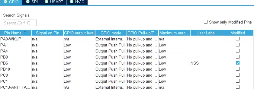

yeji_jangAuthor
Jul 3, 2025 3:09 PM UTC
Thank you for your prompt reply.
I have already included "rfal_rf.h", and make breakpoint at st25r3916Initialize()
I found Initiatlization is failed, strongly assume that the ChipID is not properly read.
I’m currently seeing two related issues:
1.
ret = st25r3916ReadRegister(ST25R3916_REG_IC_IDENTITY, &chipID);
always returns chipID == 0x00
2. Inside demoIni(), rfalNfcInitialize() returns RFAL_ERR_HW_MISMATCH (–36), which indicates that the IC ID check failed.
Would you mind taking a moment to review my SPI initialization and GPIO configurations to see if there’s anything I may have overlooked? I would greatly appreciate any guidance or suggestions you could offer.
Thank you very much for your help!
Brian TIDAL
Brian TIDALBest answer
Jul 3, 2025 3:51 PM UTC
Hi
The Clock Phase should be 2 Edges (see datasheet section 4.3.3 Serial peripheral interface (SPI))
Also check the Prescaler to not exceed the maximum baud rate.
Ensure that you carefully test the return codes of the various calls (MX_SPI1_Init, etc.).
Rgds
