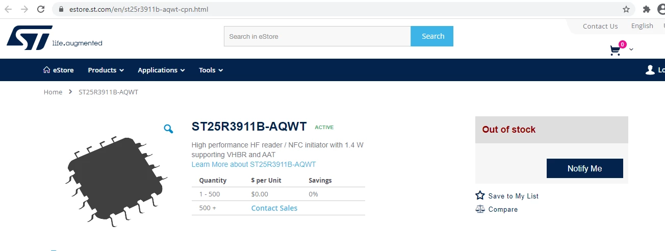

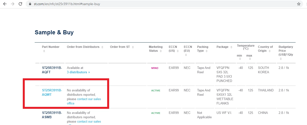

Thanks Peter for your response.
I have checked for ST25R3911B-AQWT but I have found that it is currently out of stock and there also no distributor for it.
I have also checked on major online distributors like mouser , arrow , element14 , but all of them don't have it in their stock.
Peter BENSCH
February 26, 2021
Please do not confuse general availability with availability from stock.
The current situation of availability at distributors is caused by several factors, the most important of which is the current pandemic. This means that you can order the components, but unfortunately you have to expect a longer delivery time.
Regards
/Peter
