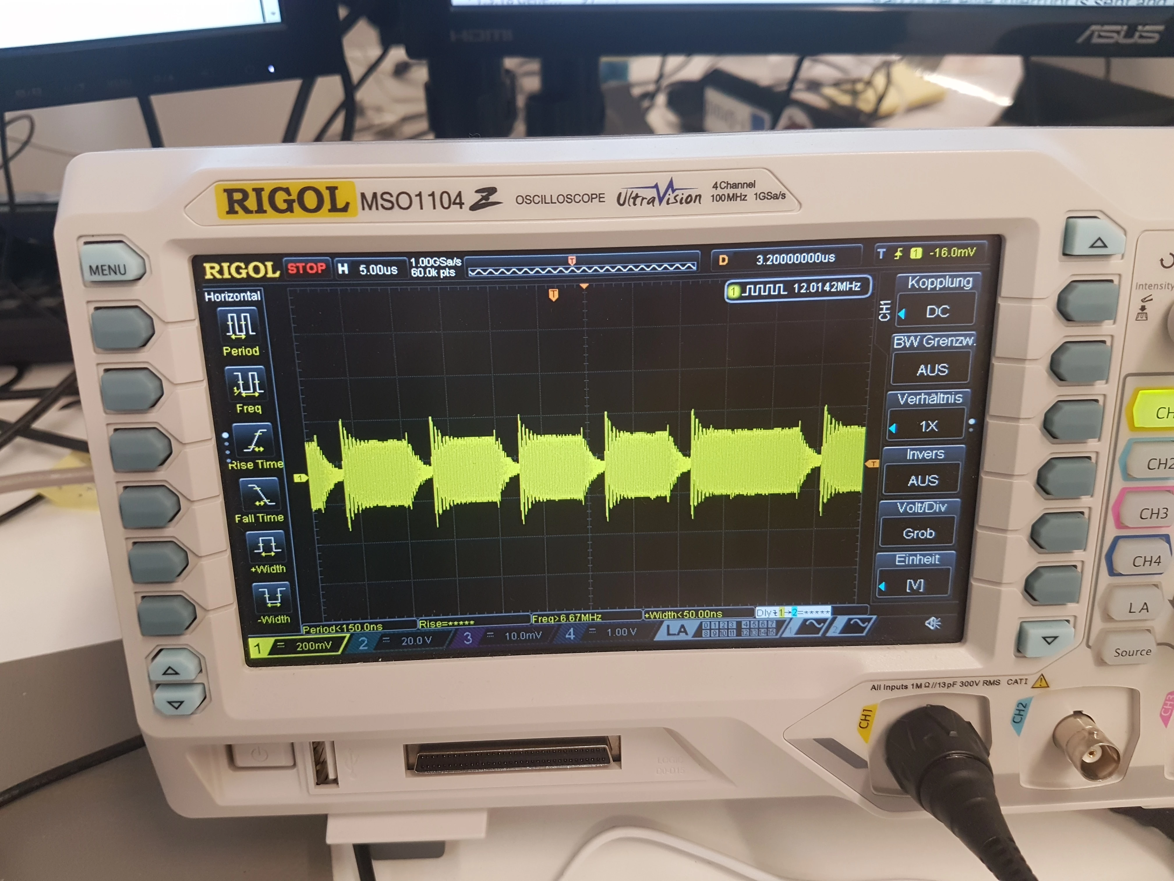

As an attachment I send the communication VCD to VICC on an
oscilloscope. I got this using a different antenna.

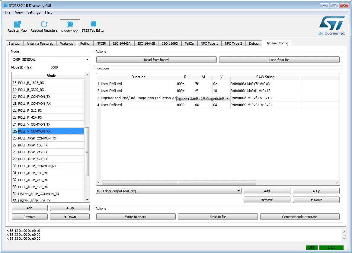

    • Bitrate register is actually a don't care for stream mode.
    • Stream Mode Definition Register is correctly set for Tx but not for RX, typcially it would be set to 0x38
    • send_direct_command(RFID_CALIBRATE_ANTENNA); this command is not related to the modulation depth. It will try to adjust the trimming caps. This may lead to a change of current draw. So you should do an Adjust regulators before and after.
    • Please use supply 3V only if you really use 3V supply. Our boards are typcially set to 5V.
    • Additionally it is advisable to tweak some analog configs for reception as here (taken from ST25R3911B-DISCO):
    Looking at your scope shots the wave shapes look not very nice. Also doesn't look like 30%. But this may also be related to using a second (reader?) antenna to probe. Better to use only the ground wire of the scope to connect it to the tip.

    The problem is: I have no idea why the iso15693 does not work all. Thats why I was looking for support if the register settings are correct.
    While I got no response from VICC i decided to use an antenna to check whether I'm transmitting data from st25r3911b at all.
    Thats what you see in the picture.

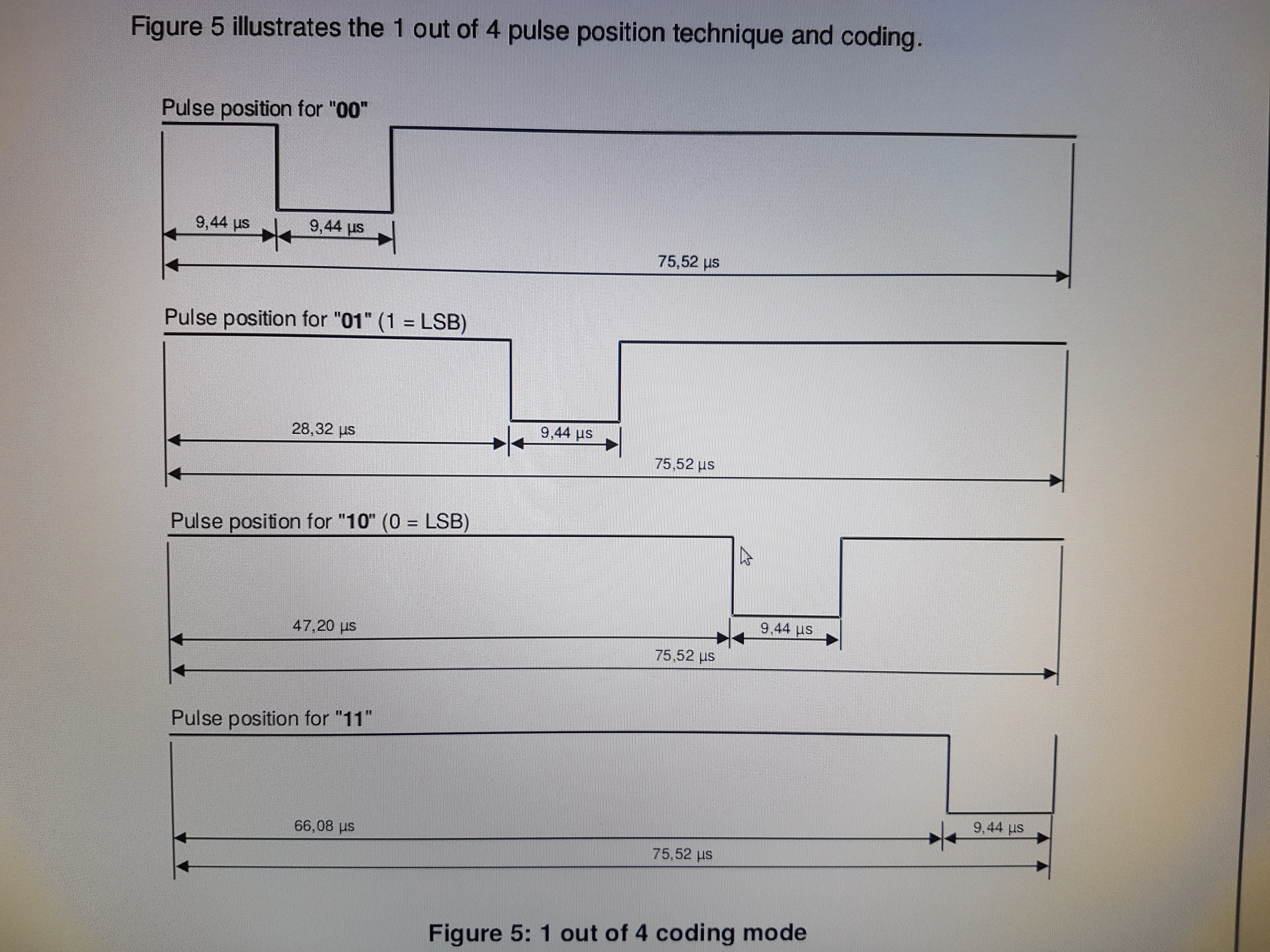

    The LSBIT first and inverted defines are due to the ISO15693 standard.
    For example: the standard say for coding 1 out of 4 : BF , EF , FB, FE
    In your RFAL document : 02 , 08 , 20 , 80
    How does this work ?
    You said 'I assume the bytes will be normalized before actually being written into FIFO.' . The ISO 15693 wants me to send LSBIT first, so I do have to switch ? Meaning 01 (inventory) becomes 80.
    Wich value do I use for coding 1 out of 4 now ? 01 or 80 ?

    I typically prefer to use the notation in the spec: 0x01 is the Inventory command, I would like to use this also in the SW. The conversion of these bits into a bit stream over RF is up to the chip/ software driver.
    ST25R3911B transmits in stream mode using LSB first. A '1' denotes a modulation, a '0' denotes an unmodulated time period. ISO15693 does not define 0 and 1 on the modulation waveforms itself. It seems you read the 'high' in the waveform as a '1'. But that is only your interpretation.
    So with sending a stream of 0x00 using stream mode ST25R3911B will send the unmodulated (strong) carrier. In your view a constant 'high'.
    If you didn't reverse and invert your bytes on your lowest driver level then the generated modulations will be completely off-spec and not understood by the VICC. Not sure why your scope shot didn't look even worse then.
    Regards, Ulysses

    Maybe lets get some little example:
    I know the bitstream consists of:  SOF , flag , cmd , mask lenth , (mask value) , crc_low , crc_ high , EOF
    Just lets do for cmd 0x01 (inventory)
    I want to do 1 out of 4 coding. So coding 0x01 like in your RFAL would become :
    0x01 = 0 0 0 0 0 0 0 1 = 0x02 0x02 0x02 0x08
    So I write 0x02 0x02 0x02 0x08 to FIFO ?
    Or do I have to do something else in addition ?
    Best regards, Nicolai.
    And thank you very much for your patience
    Ulysses HERNIOSUS
    July 10, 2018
    Posted on July 10, 2018 at 14:34
    Hi Nicolai,
    almost:
    0x01 = 0 0 0 0 0 0 0 1 = 0x08 0x02 0x02 0x02
    So you write 0x08 0x02 0x02 0x02 to FIFO.
    Regards, Ulysses

    So I gave another shot to the
    oscilloscope (I used an antenne of Proxmark to get the value).
    In order to see what happends I made an endless loop: just fill the FIFO and transmit the values via magnetic field.
    In the case nothing is transmitting ( the picture) I have only my carrier (56 MHz).
    In the case the FIFO is only filled with 0xFF (31 bytes in total) a modulation takes places.
    BUT in the case the FIFO is filled with constant 0x00 (31bytes in total) there is a modulation too.

    Attachments :
    no_transmit.jpg : https://st--c.eu10.content.force.com/sfc/dist/version/download/?oid=00Db0000000YtG6&ids=0680X000006HxR1&d=%2Fa%2F0X0000000ay0%2F4NYg6kULkvkpe_A1oQJrmgYm1flTkbGA5.ehdPGz844&asPdf=false

    Hi Nicolai,
    if you read our source code you will find that for iso15693 the crc needs to be inverted at the end - before coding:
    26 01 00 F6 0A -> 21 20 08 20 02 08 02 02 02 02 02 02 02 02 20 08 80 80 20 20 02 02 04

    Hello
    Ulysses,
    there should be one picture and two videos as attachment. Both videos about three seconds showing the measured wave by the
    oscilloscope
    I started developing and implementing the code using the official iso 15693 datasheet. For example the 1out of 4 coding:
    As you can see, the values for coding are LSBIT first but also inverted.
    This total confused me. So i came to this forum. To sum it up: I implemented the same functions but with inverted values and LSBIT first. This was your ''confusion'' about my code .
    I'm going to implement the invertion of crc and will give feedback.

    nicolai geske
    July 26, 2018
    i got it work :)
    The trick (mistake) was to set the transmission to OOK not to AM.
