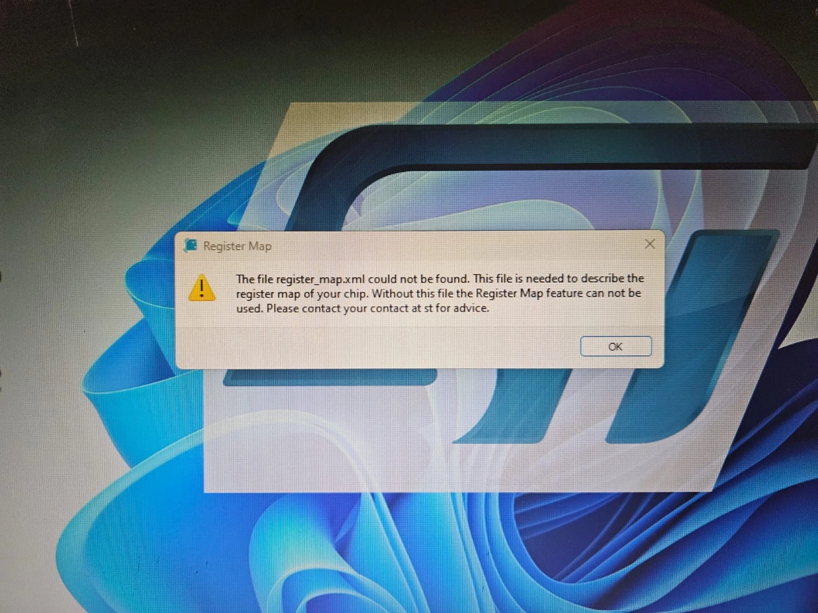

Hello Jorgsala,
the register_map.xml should be in the same folder as the executable.
Please check that it is there an accessible. The one you sent is intact. Maybe checking access rights? Copying complete folder to a user folder and execute from there? Re-install the GUI?
Regards, Ulysses

Hi Ulysses
I tried the different recommendations but it doesn't work.
Any another recommendation?

Hi Jorgsala,
not really...
The GUI should open and be operational even without the file, correct? The effect should only be that you have an empty register map and no easy access to all the registers.
Could you 7zip the folder and attach it, please?
BR, Ulysses

We using task scheduler to open the .exe file
When we double-clicking the exe the sw working normally, but we need to use the task scheduler

Hi Jorgsala,
That info would have been helpful if immediately provided!
I am suspecting that you need to set the environment properly. My first thinking goes towards setting the current working directory to the location of the executable as the register_map.xml is expected in the current working dir.
If still not working you can may describe how you create this in Task Scheduler. I tried and I didn't get ad hoc any window, only a running process.
