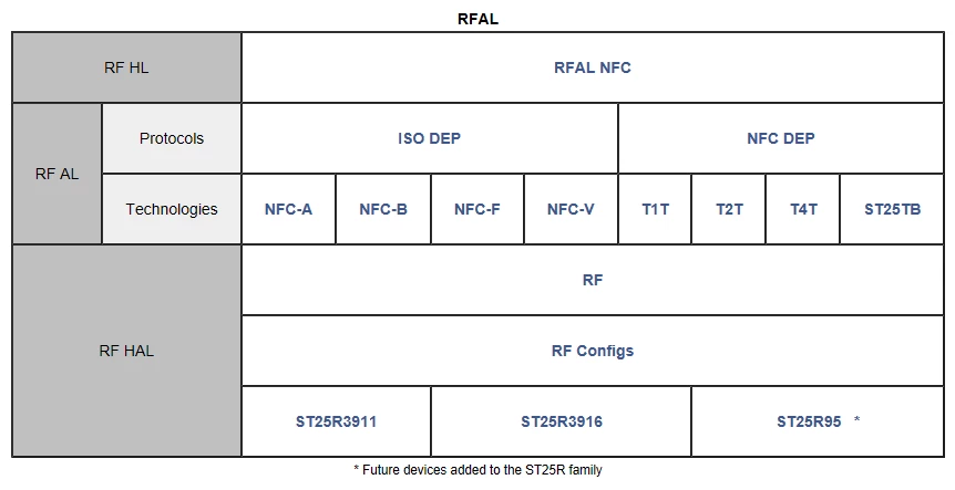

PPK
PPKAuthor
November 14, 2019
@Brian TIDAL_O​ @Ulysses HERNIOSUS_O​
Thanks for the details.
I will not use the PC communication / USB for my custom board.
Got a better idea of it from the below picture of RFAL documentation.
For my case, RFAL NFC - ISO DEP - NFCV - to ST25R3911.
