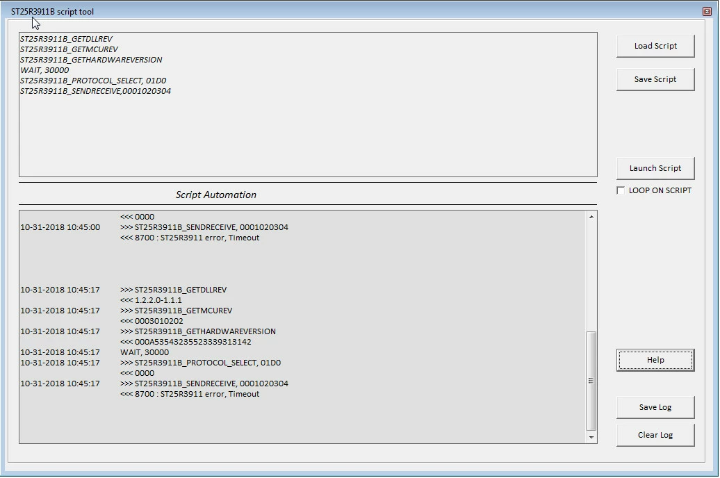

Hello all,
for test purposes I want to realize a communication of small data amount with the ST25R3911B-Disc​o board.
yet I already:
  • installed the gui and updated firmware
  • tested nfcip with my smartphone (so the board is working)
  • tried to use integrated script tool for sending (didn't work yet)
Im not sure which standard is apropriate to realize the project and how to define it in the script tool.
For testing I use an ST25TA64K Tag.
Regards, Ben

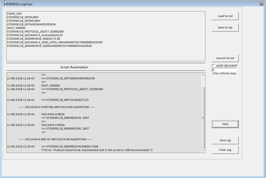

    0690X000006CK8LQAW.jpgHello ,
    Thank you for your answer. But now a couple of new questions are occuring
    • I tried to realize the code as you have sudgested but with no result ( Have attached a picture)
          The anti colision adjustment ist similar to this one here:
            https://www.youtube.com/watch?v=tuMjCsIyyuw  ?
    • is there a list anywhere with the APDU commands in ST25R3911B ?
    • How could I use/controll the other functions for example on NFCIP to send pictures and so on with ST25R3911B?
           ( For Example to send data if a apropriate device is in range) this means especially which tool is adecuate for confuguring that?)
    Best Regards

    ​Hello,
    yes, you're true. Anticollision's process shown in the youtube video is the same as it is iso14443-A anticollision. The only difference is that, using an Android phone in CE mode, the UID is only 4 bytes length instead of 7 bytes length.
    About the attached picture, I suspect that the ST25R3911B-DISCO has been removed (USB plug and unplugged) and the main software (ST25R3911B Discovery GUI) has taken the USB handle. You need to close ST25 Tag Editor software and launch it again.
    Last point : the main goal of the script is to evaluate the communication between the RF reader and the tags. You can use it to exchange any data between the reader and the tags (or android phone in CE mode) but you will need to code all frames to be able to transfer a picture or any NDEF message to the tag.
    Best regards
    NFC / RFID Customer support

    ​Unfortunately I alsways reiceive this error as well when I have plugged and unplugged the board an have adjusted the version settings.
    I couldn't get the script working you've sent me to communicate with ST25TA64K Tag because i got the same error. It worked in the normal reader writer mode but not with the scripttool.
    Regarding the communication to an andriod phone the four byte means in the protocol send_receive 2604 ?
    To be honest I'm a bit depressed after trying hours with no result.
    I just tried to poll the ID of the phone but it's continously changing , I don't know if it's the same with the UID.
    As I saw in the video he used a 4byte mi fare tag and choosed 2607 ?
    Regards from Germany
