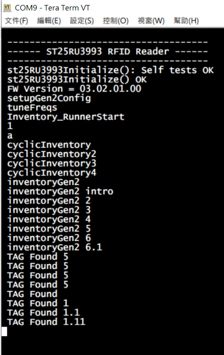

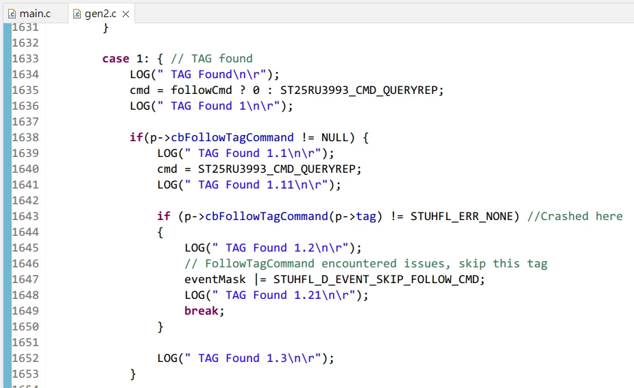

But here is an error occurred, as the following picture, the EVB crashed when it found tags and executing this code:
if (p->cbFollowTagCommand(p->tag) != STUHFL_ERR_NONE)
I didn't edit the firmware except enabled the STUHFL_DEVICE_MODE in main.c, and more weirdly, it just works fine the day before the error occurred, I want to know what happen with it, thank you.

I can not reproduce your issue. To test I used the HPEV board with the antenna and tags from the package and can read the tags without any issue.
From your screenshot I see that you use V3.2.1, which is ok.
Does it still crash for you ?
When it crash have you already tried to debug and checked the call-stack and the value of involved data fields ?
One comment. From the screenshot I can see that you added multiple LOG statements inside the file gen2.c.
The function gen2SearchForTags(..) handles the Query/QueryRep loop for inventory. This section and the called low level function here are timing critical.
Each call to LOG use a blocking call to the HAL driver to log data out over the UART. This will not crash the FW but slow down the inventory.
BR Nick
