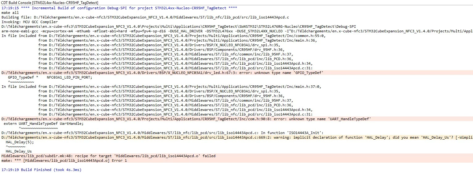

I read all the .cpp and .h library but I can't find any routine that shows the RFID of the card, can you help me ?

    Hi juju.botton1,
    I did a test on a clean PC, installing SW4STM32 and using the STM32CubeExpansion_NFC3_V1.4.0_For_L476 and the SW4STM32 package I attached in this thread. The only missing thing was the CMSIS folder which was not complete. I copy it from the official NFC03A1 and it works fine for me. Can you detail more the error it returns.

    Hi, I get this by doing what you told me, the project for the STM32F4xx works and when I want to build the project for the STM32L4xx with the exact same lib files in the exact same directories it doesn't work, I don't know why. And I can't add the lib files to make a HTTP request inside the NFC example code

    Hi juju.botton1,
    It seems you are missing some include files, are you sure the includes path in your project properties are :
      ../../../../Inc
    ../../../../../../../../Drivers/CMSIS/Device/ST/STM32L4xx/Include
    ../../../../../../../../Drivers/CMSIS/Include
    ../../../../../../../../Drivers/STM32L4xx_HAL_Driver/Inc
    ../../../../../../../../Drivers/BSP/STM32L4xx_Nucleo
    ../../../../../../../../Drivers/BSP/Components/CR95HF
    ../../../../../../../../Drivers/BSP/X_NUCLEO_NFC03A1
    ../../../../../../../../Middlewares/ST/lib_nfc/common/inc
    ../../../../../../../../Middlewares/ST/lib_nfc/lib_ndef/inc
    ../../../../../../../../Middlewares/ST/lib_nfc/lib_pcd/inc
    And the folder of the HAL drivers for L476 is present at this location?

    Ok, the code build after reinstalling Eclipse. But when I put it on the STM32L476RG it doesn't display anything on my terminal. And I don't if you can try to merge the http request example for the IDW01M1 and the NFC03A1 example but as soon as I had the include files needed for the NFC it doesn't work anymore. Is it in fact possible to scan a card, get the RFID and send it through a http request with these products ?

    I didn't manage to make your project compiled on my PC, I don't know why something has probably corrupted while I opened it under my environment.
    I've noticed something that could explain some of your problems. In your project with the Wifi module, it seems that you missed to copy some functions. in stm32l4xx_it.c there are timer interrupt functions and irq that I didn't find. In the main.c, MX_TIM2_Init (3 and 4 also) are missing. Some defines in main.h are missing. in stm32l4xx_hal_msp.c there some MSP initializations missing too.
    Hope this can help you.
