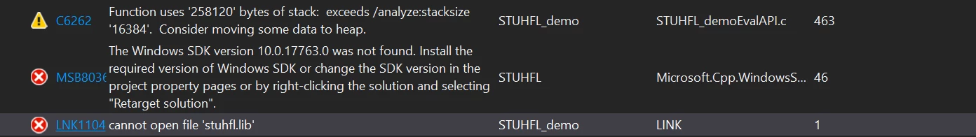

Bao Le Gia
March 27, 2021
0693W000008y4diQAA.pngwhen I tried to open the solution STUHFL_demo and build it. I encountered this problem. And I couldn't find the file stuhfl.lib anywhere.

Hello Bao,
The Demos building from scratch is part of our delivery process, I can confirm the demo project builds.
Looking at your traces, it seems your build environment is not correct.
Indeed, you have the message "The windows SDK version 10.0.17763.0 was not found. Install the required ....", meaning VS cannot proceed to the compilation/linking completion,
this explains why stuhfl.lib is not generated.
Could you please try to complete your build environment,
the demo will be running.
