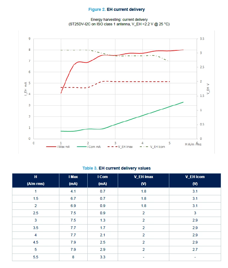

In addition, according to below EH current delivery profile in AN4913, the ambient H field is one of the major factor that affecting the P_EH, what is the definition of H (A/m rms), is it related to the distance between reader and the antenna? and also 10% or 100% modulation amplitude used in this testing?

Unfortunately, there is no API to change the modulation amplitude in Android. It is hard coded in low level drivers and most of the smartphones are using 100% modulation because this is what NFC Forum requires. So with smartphones, you are stuck at 100% modulation.
Concerning the H field, this is the measure of the magnetic field that the antenna receives.
In the application note, it is measured using an ISO tower, as described in the ISO10373-7 specification. It is a normalized way to measure the magnetic field power received by an ISO15693 antenna. RF field is measured in A/m.
The more A/m the antenna receives, the more power is available for energy harvesting. The magnetic field strength depends on several factors, but basically in the case of a smartphone, you can act only on the distance factor (H decreases with the cube of the distance).
