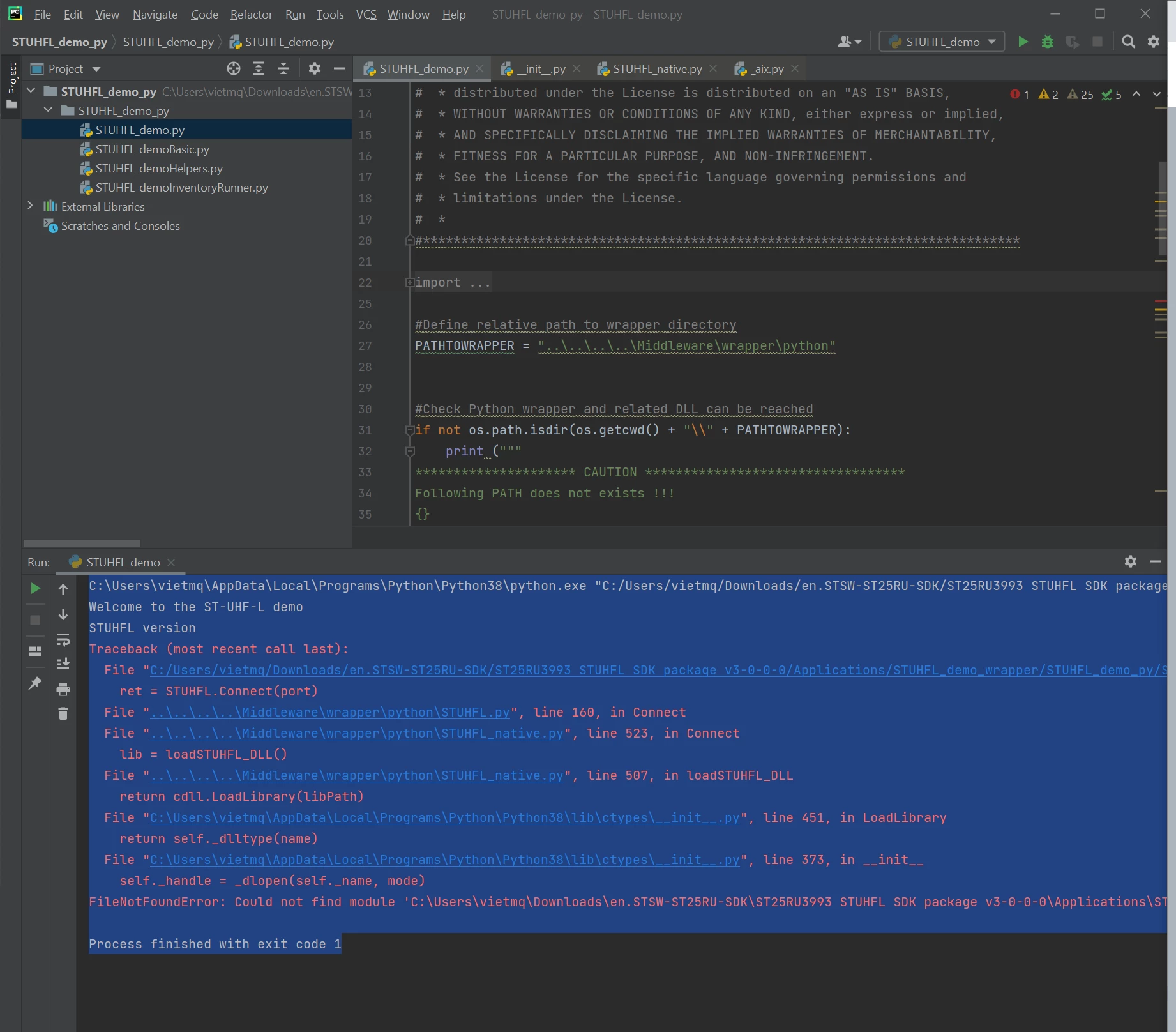

Base on the README.htm. I open the STUHFL_demo.py in PyCharm.
Run the python code, i running into the problems like picture:
0693W00000AMRy7QAH.pngThe error log as below :
C:\Users\vietmq\AppData\Local\Programs\Python\Python38\python.exe "C:/Users/vietmq/Downloads/en.STSW-ST25RU-SDK/ST25RU3993 STUHFL SDK package v3-0-0-0/Applications/STUHFL_demo_wrapper/STUHFL_demo_py/STUHFL_demo_py/STUHFL_demo.py"
Welcome to the ST-UHF-L demo
STUHFL version
Traceback (most recent call last):
 File "C:/Users/vietmq/Downloads/en.STSW-ST25RU-SDK/ST25RU3993 STUHFL SDK package v3-0-0-0/Applications/STUHFL_demo_wrapper/STUHFL_demo_py/STUHFL_demo_py/STUHFL_demo.py", line 60, in <module>
 ret = STUHFL.Connect(port)
 File "..\..\..\..\Middleware\wrapper\python\STUHFL.py", line 160, in Connect
 File "..\..\..\..\Middleware\wrapper\python\STUHFL_native.py", line 523, in Connect
 lib = loadSTUHFL_DLL()
 File "..\..\..\..\Middleware\wrapper\python\STUHFL_native.py", line 507, in loadSTUHFL_DLL
 return cdll.LoadLibrary(libPath)
 File "C:\Users\vietmq\AppData\Local\Programs\Python\Python38\lib\ctypes\__init__.py", line 451, in LoadLibrary
 return self._dlltype(name)
 File "C:\Users\vietmq\AppData\Local\Programs\Python\Python38\lib\ctypes\__init__.py", line 373, in __init__
 self._handle = _dlopen(self._name, mode)
FileNotFoundError: Could not find module 'C:\Users\vietmq\Downloads\en.STSW-ST25RU-SDK\ST25RU3993 STUHFL SDK package v3-0-0-0\Applications\STUHFL_demo_wrapper\STUHFL_demo_py\STUHFL_demo_py\Debug\x64\STUHFL.dll' (or one of its dependencies). Try using the full path with constructor syntax.
Process finished with exit code 1

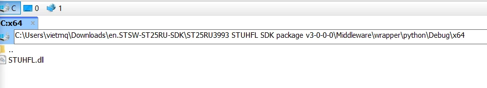

It is asking for .dll lib file.
but in the SDK, the .dll lib file is located under : en.STSW-ST25RU-SDK\ST25RU3993 STUHFL SDK package v3-0-0-0\Middleware\wrapper\python\Debug\x64
should i change the library path in the python code or what should i do in this case ?

The DLL is supposed to be found by the MW thanks to the code in STUHFL_demo.py dealing with os.path (lines 27-43) + the function loadSTUHFL_DLL() in STUHFL_native.py.
So the current location of DLL (...\Middleware\wrapper\python\Debug\x64) is OK,
now remains to understand why in your environment the DLL is not reached:
...\Applications\STUHFL_demo_wrapper\STUHFL_demo_py\STUHFL_demo_py\Debug\x64\STUHFL.dll is definitely not the path where the dll is supposed to be found !!!
Could you first instrument the function loadSTUHFL_DLL() with the following code at least to ensure the DLL path is taken into account:
  for path in os.environ["PATH"].split(";"):
    print("path: {}".format(path))
you should have the following path listed:
path: ...\ST25RU3993 STUHFL SDK package v3-0-0-0\Applications\STUHFL_demo_wrapper\STUHFL_demo_py\STUHFL_demo_py\..\..\..\..\Middleware\wrapper\python
If not, something went wrong with your system path update.
As a workaround and until the root cause is found, could you copy the DLL in a location where your application is able to reach it ?

Another point, looking at your traces it seems the dll is eventually found (indeed cdll.LoadLibrary(libPath) is called after the check if os.path.isfile(path + "\\" + libPath):)
but has a problem to load, so could you check the bitness (32/64 bits) your system is using ?
Indeed, we provided with the release package only the 64 bits debug dll
but if your system is 32 bits only you will have to build the equivalent dll for 32 bits support.
If your system is still 32 bits, could you then try to rebuild the dll ?
Please have a look to Application-STUHFL_demo_py.chm for further details on how to (re)build the dlls.

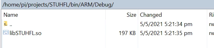

I have generated the *.so file on my raspberry:

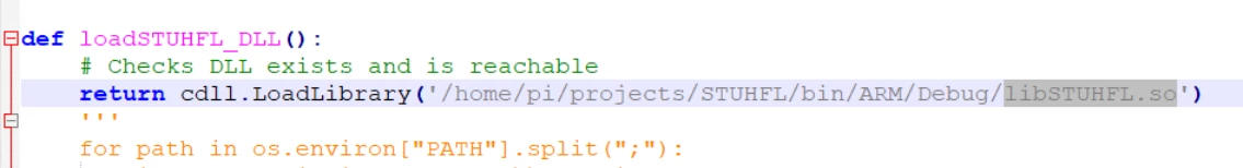

0693W00000ANP31QAH.pngFor loading the libSTUHFL.so, i fixed the path, see picture below:
0693W00000ANP3fQAH.pngMy python version is 3.7
I run the python demo by command :  $ sudo python3 STUHFL_demo.py

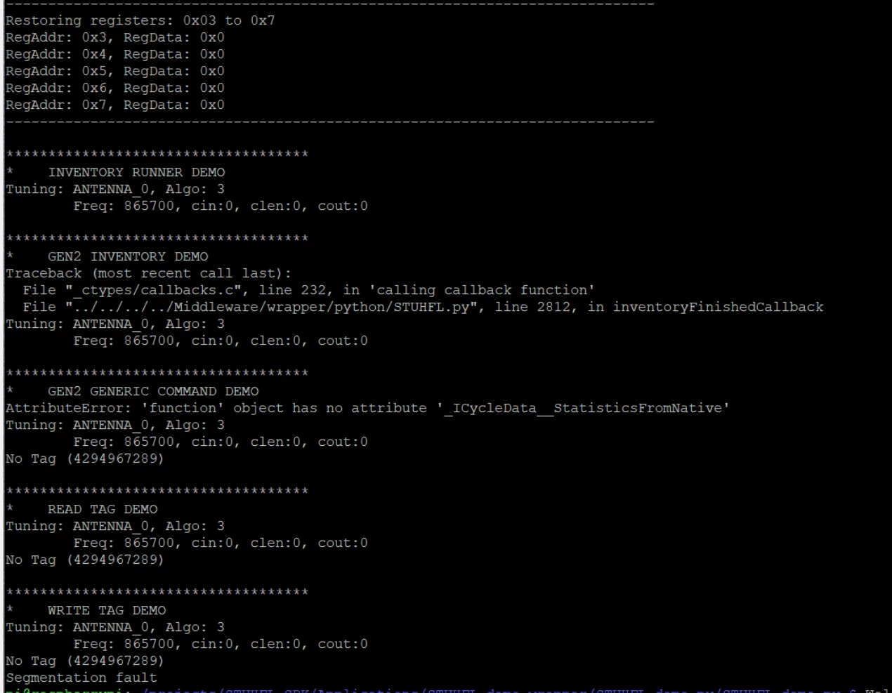

it is able to connect to reader, read and write registers.
but the errors are kicked in after that:
* INVENTORY RUNNER DEMO
Tuning: ANTENNA_0, Algo: 3
 Freq: 865700, cin:0, clen:0, cout:0
* GEN2 INVENTORY DEMO
 File "_ctypes/callbacks.c", line 232, in 'calling callback function'
 File "../../../../Middleware/wrapper/python/STUHFL.py", line 2812, in inventoryFinishedCallback
* GEN2 GENERIC COMMAND DEMO
AttributeError: 'function' object has no attribute '_ICycleData__StatisticsFromNative'
No Tag (4294967289)
the full error log can be found here : https://drive.google.com/file/d/1bcaiQ-A45VlXVX6K6hgSB4BzTj8bt7NE/view?usp=sharing
Please help us.
Thanks a lot

looking at your traces:
LIB:.3.0.0.0
Board SW:.0.0.0.0
Board HW:.0.0.0.0
it seems the communication between the library and the board has simply not been established (even more the read registers should not be all 0x00 ...)
Indeed, LIB reports 3.0.0.0 means the communication between the wrapper and lib is OK,
but Board SW/HW versions should be also 3.0.0.0 which would mean communication between lib and board is OK, that is not currently the case (versions are 0.0.0.0).
For the time being, I don't think Python is involved in the problem, you have a problem establishing connection with your board ...
Could you please try to run the Linux demo (cf Application-ReleaseNote.txt) which would ensure connections with board is OK ?

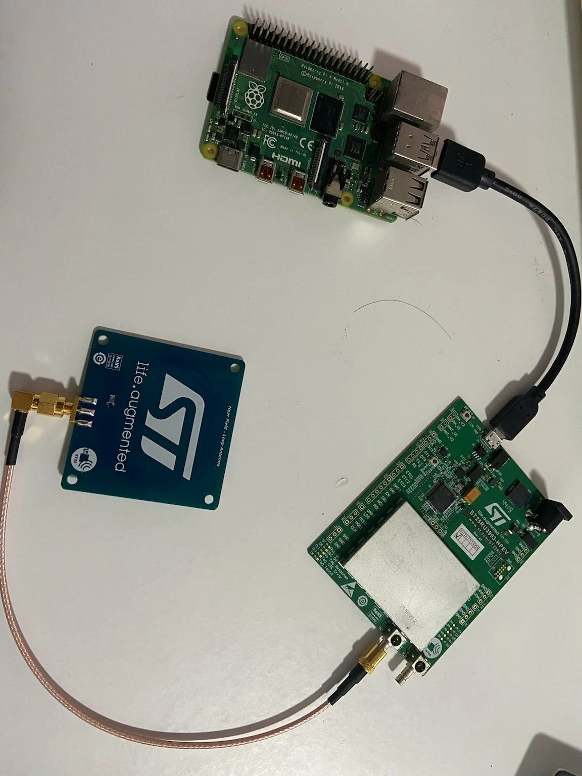

Vmai.1
May 5, 2021
Hi @Cedric Dalban​
my connection as below, could you please confirm :
