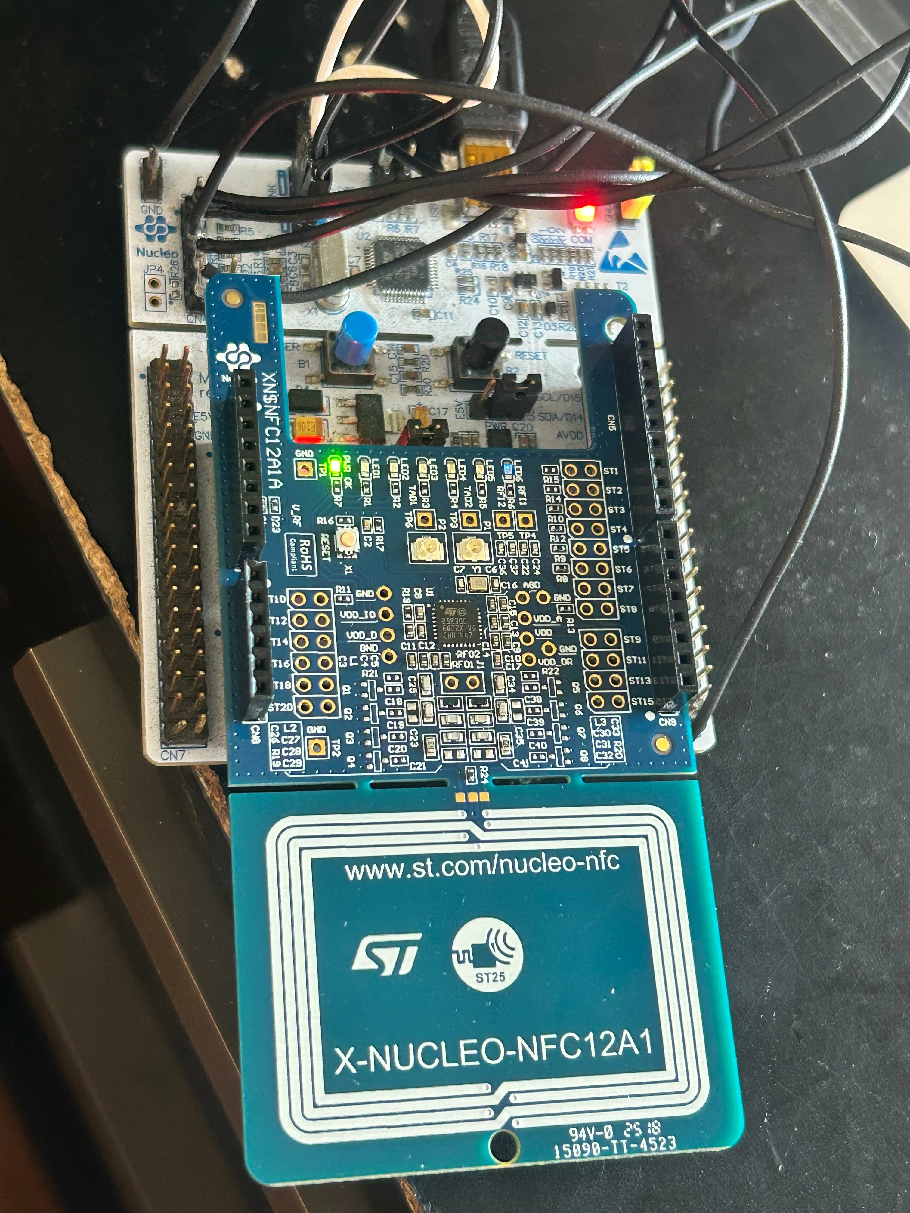

Problems with ST25R300, Mismatched voltages, and RSSI 0
I am entering the world of NFC with a somewhat complex project, but I took the initiative to start it. The goal was to create a sensor that would work only with Energy Harvesting from the reader.
For this, I chose the ST25R300 chip to be the chip for my reader board and sensor power supply, mainly due to its high transmission power.
I am having difficulty getting it to work properly. Basically, I ran several tests with some DEBUG codes on the reader board. In these tests, I found some inconsistencies. The first is the VDD_A voltages, which come from a reading of the chip itself, which is registering almost 6V, and the other inconsistency is the RSSI giving 0.
I believe the error is in my antenna and matching circuit. I would like someone to help me improve this system by pointing out where I may have made a mistake in their design.
I made the antenna using the ST website (eDesignSuite antenna design tool). I also made the maching circuit using ST's eDesignSuite.
In addition, my circuit was largely based on the core board (X-NUCLEO-NFC12A1).
The main premise was to develop something small that could perform energy harvesting, so I made a 10-turn antenna, which is larger than the TAG antenna. I made a mistake in developing a single-ended antenna instead of a differential one, but I wanted to start with something simpler first before perfecting it.
Could the design of a 10-turn antenna for the ST25R300 prevent the RF driver from oscillating to the point where the RSSI is zero, or does the VDD_A value suggest a hardware failure in the analog stage?
Observations:

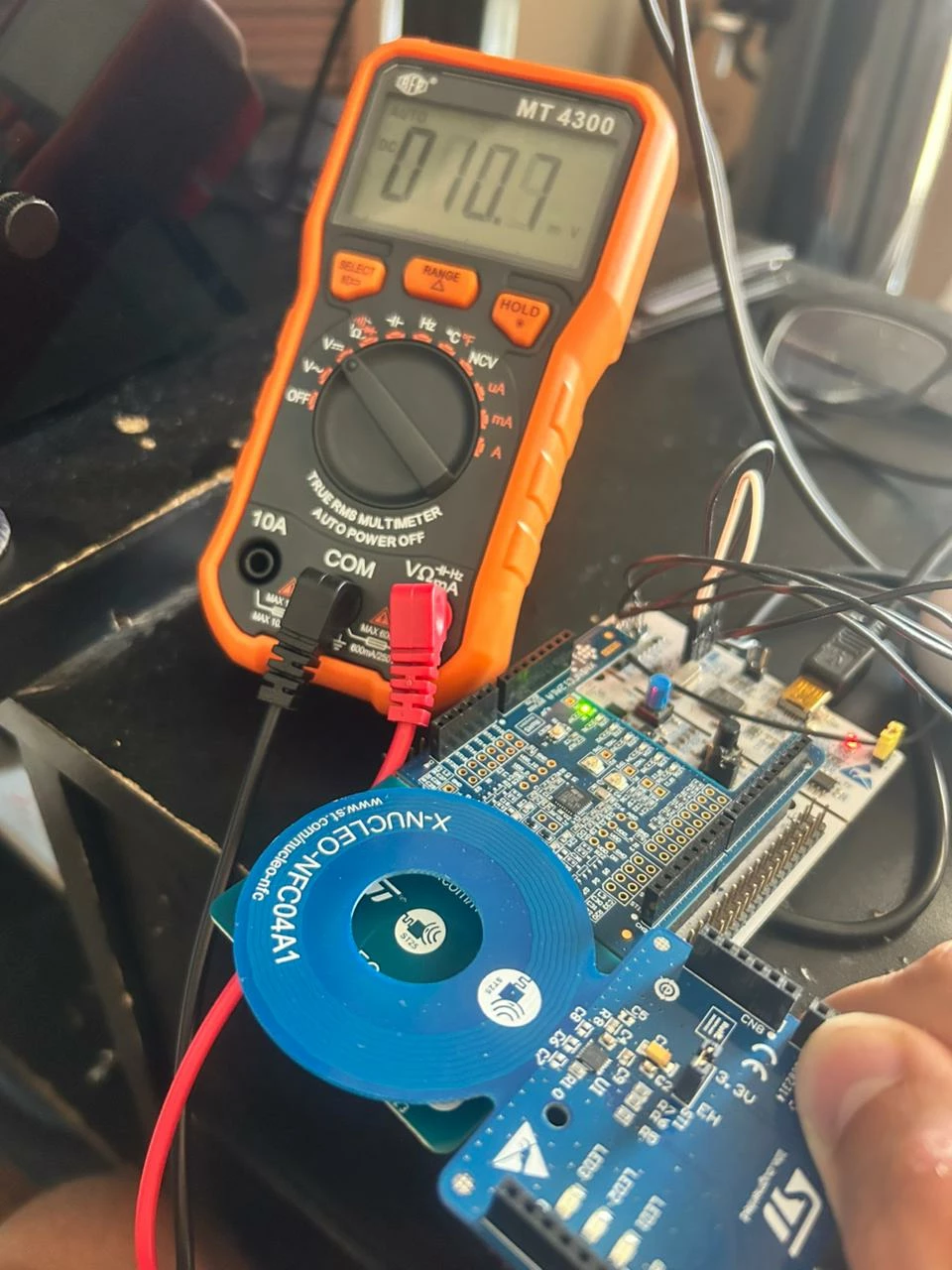

  • The chip responds to SPI and returns the correct ID (0x16).
  • When enabling the RF field, RSSI does not fluctuate and remains at 0.
  • The ADJUST_REGULATORS command was executed, but VDD_A remains abnormal.
  • I have already disconnected the antenna to try something more direct by removing resistor R5, but even so, RSSI remains at 0 and the voltage remains the same at VDD_A.
  • On the PCB, I removed the ground plane on the antenna side.

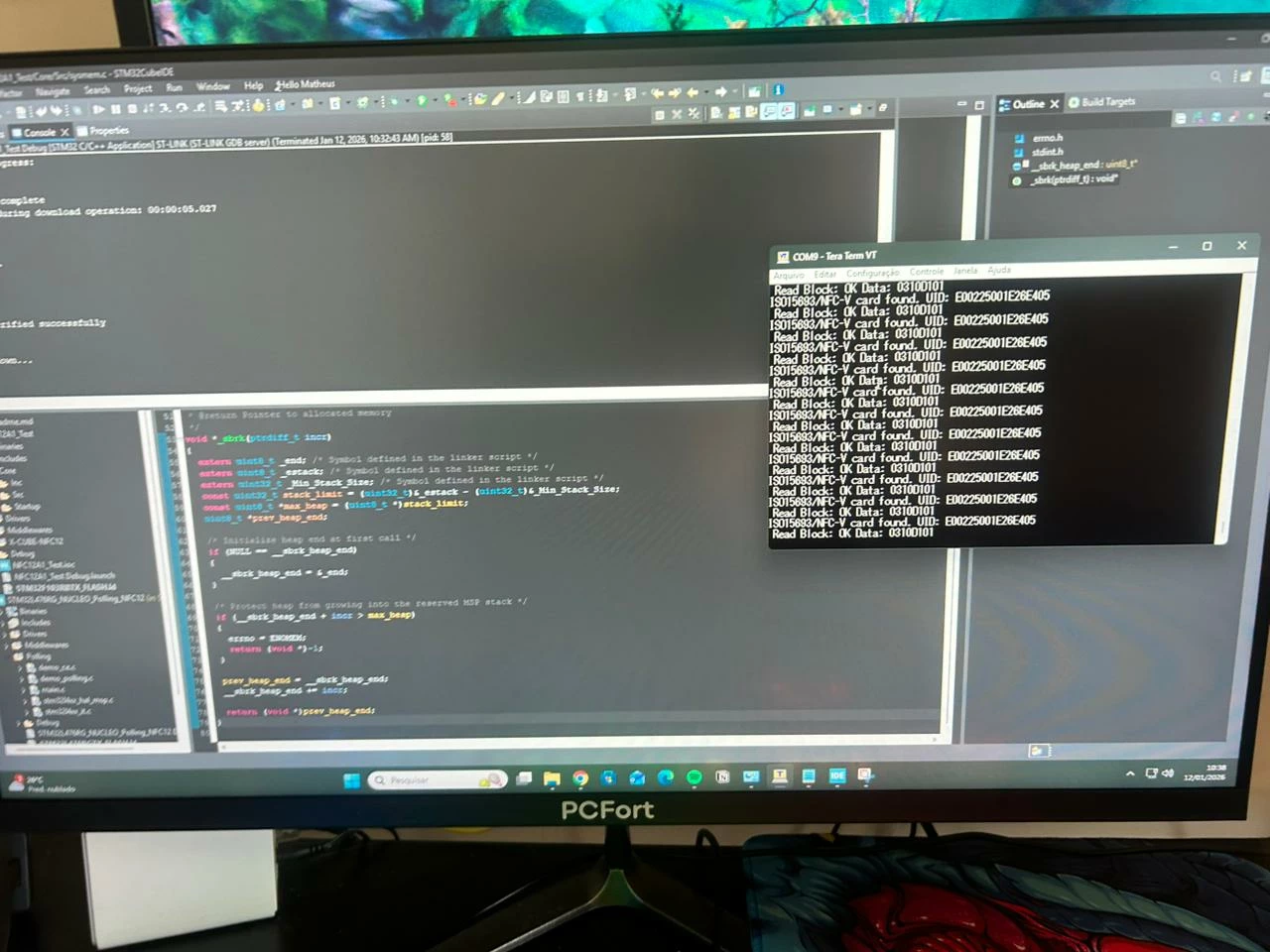

Below is the test code:

I think my best option right now is to use X-Nucleo instead of starting with my own design right away. That said, I bought an X-NUCLEO-NFC12A1 board to start testing.
I didn't know about RFAL, I would like to use the polling example to test my board. But I don't know how to adapt it to use the example. In my case, instead of NUCLEO-L476RG, I have a NUCLEO F103RB. I tried to run the example located in "...\STMicroelectronics\ST25NFC_Embedded_Lib_ST25R500_1.8. 0\Projects\STM32L476RG-Nucleo\Applications\X-NUCLEO-NFC12A1\polling\STM32CubeIDE."
However, I did not get the logs in the serial to know if it worked or not, but I think I did it wrong, since, as I mentioned, I tried to load the example made for the L476RG directly into my F103RB.

Matheus_Markies
Good morning, Brian! Thank you very much! I finally got it working here.

Now I have another question. Please correct me if I should open a new thread for this instead of posting it here.
My problem is increasing the EH voltage of the ST25. As I said earlier, the goal is to power a set of low-power chips with it. I measured it in an improvised way to get an idea and arrived at 10mV on the EH pin. I don't know if I did this measurement correctly.
What can I do to increase this to perhaps 1V, for example? Would it be possible to reach up to 3V in EH?
