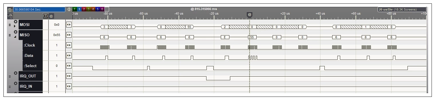

Example of commands
0693W00000HrAeZQAV.jpgFirst frame: 03 XX SPI Poll. Answer is XX 06 ==> bit #2 =1: data can be sent to the device
2nd frame: 00 55 : Send Echo command
IRQ_OUT goes low
3rd frame 02 XX XX XX read Echo response
4th frame 00 01 00: send IDN command
Rgds

Thanks for the very thorough response. I have attached my logic analyzer tests as well as a screen shot of my Python test Script. As you see from the script, I've created code to buttons so I know what is sent and when.
I'd like to respond here to some of your suggestions:
(1) Clock probe. I do not see the response with my oscilloscope when I probe the clock as shown in Figure 3 of your link. Its mostly noise.
(2) I never see anything on IRQ_OUT. The logic analyzer shows that it is always low.
(3) Section 4.1.1 of the datasheet says that CPOL=CPHA=1 or CPOL=CPHA=0. I tried both of those. Based on your suggestion, I also tried CPHA = 1 and CPOL = 0. I saw no change in performance (or lack thereof).
(4) MISO and MOSI are properly connected (see attachments)
(5) SS is being set high between commands (see attachments)
(6) The chip is not responding to the any command, including the echo command.
So I'm still not able to talk to this at all. This is not the first time I've communicated to something with SPI, so I'm quite confused as to what could be the issue. I have confirmed power is getting to the IC holder. I loaded my 3rd IC into the holder for these tests (just in case I fried the previous 2 IC's.) I ordered another 3 just in case I have damaged these 3, but I am at a lost right now as to what to try.

Thanks BT. This was an extremely helpful response. I am talking to the chip now!
The important connections were the pull-up resistors on IRQ_IN and _OUT. Without the pull-up on the IRQ_OUT, there doesn't seem to be any communication.
I tested the oscillator as shown in the attachment. I used a function generator at 3 VDC output to drive one leg of the quartz crystal. I attached the o-scope to the other leg, and connected grounds. I increased the frequency, and at 27.12 MHz the crystal resonated and I got a 4 times increase in the waveform strength. This proved it was working. I then attached it directly to the 2 pins on the chip holder. When I powered up and started my application, the crystal came alive.
The ST_R0 and _R1 connections you suggested didn't have much of an impact. And whether I use CPOL = 0, CPHA=0, or CPOL=0, CPHA=1 seemed to have no effect. Although I haven't tried to interpret the data I'm receiving yet.
I am now getting response on the MISO line. Until today, I'd never seen any digital IO on this. And they match some of the responses you showed on the figure you supplied.
I have yet to see anything on IRQ_OUT (i.e, it going low when I send a polling command), but pulling it high is essential for communication. It could be that I have either too much or too little values for the pull-up resistor.
My next effort is to interpret the data I'm seeing, and add the antenna to test tag reads. So I may be back for more help then.
